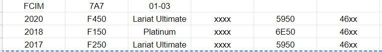

I am putting together a small sheet that lists the seat temps.
Would love to get some additional data from members

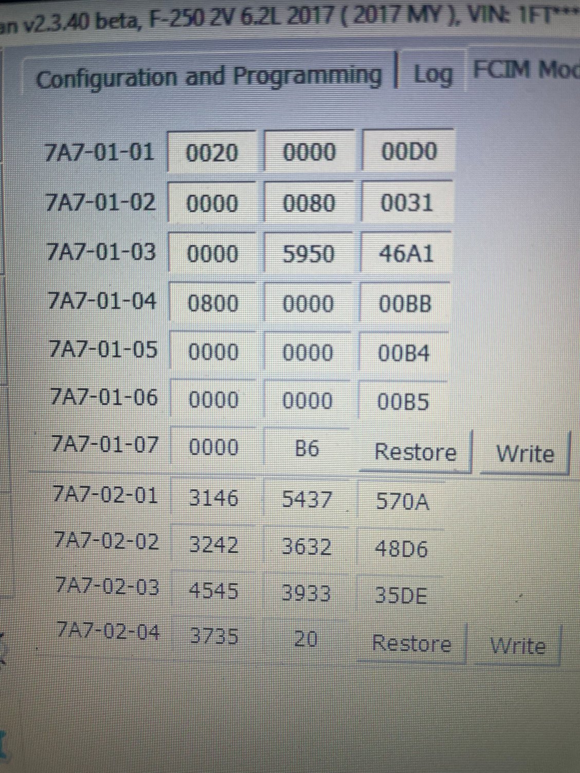

The data i need is located in (FCIM) 7A7-01-03 xxxx ???? ??xx
Also please list Year Model and Trim Level
I am planning on adding this to the spreadsheet when I have some additional info.

Here’s what I got ‘17 6.2 ccsb xlt premium with the split bench front seat. The truck came with factory heated cloth seats but now has katskinz leather.
