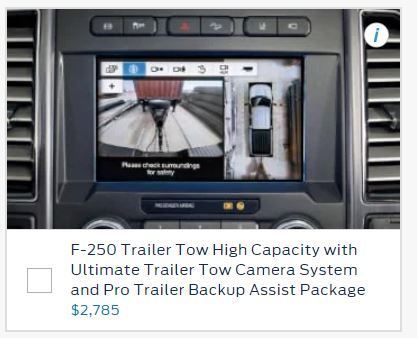

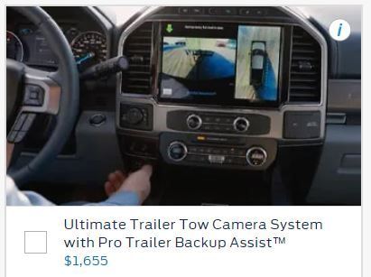

Originally Posted by BADAS03SVT
it just seems to be two options and I wasn't sure if one was needed over the other.
Lariat and up get the 12" screen regardless of what you see in that picture. Both those options add the 360 camera system, the only difference is the first also adds the HCTT package.
The GVWR for the F-250 is 10k without a derate and without adding the high capacity tow package. You can derate the 250(without high capacity tow package) to 9900 GVWR. With the High capacity tow pkg you get 10800 GVWR. You can't derate with that option.
