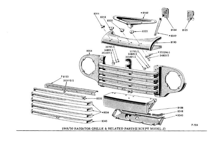

If you're just replacing the 2 lower bars there's a chance you could do it without removing the entire grill. It would be easier with the grill removed, but might be possible without.
The bars are spot welded to the main panel but if you pull the lower valances (8188 and 8240) there is quite a bit of room to work.

That had occurred to me so I appreciate that suggestion. I think I'll give that a try before I remove the entire front clip. It wasn't clear to me how the bars were attached as I initially thought that they need to be removed from the back side. If I can get them off, it's possible I can save them with a little body work.
