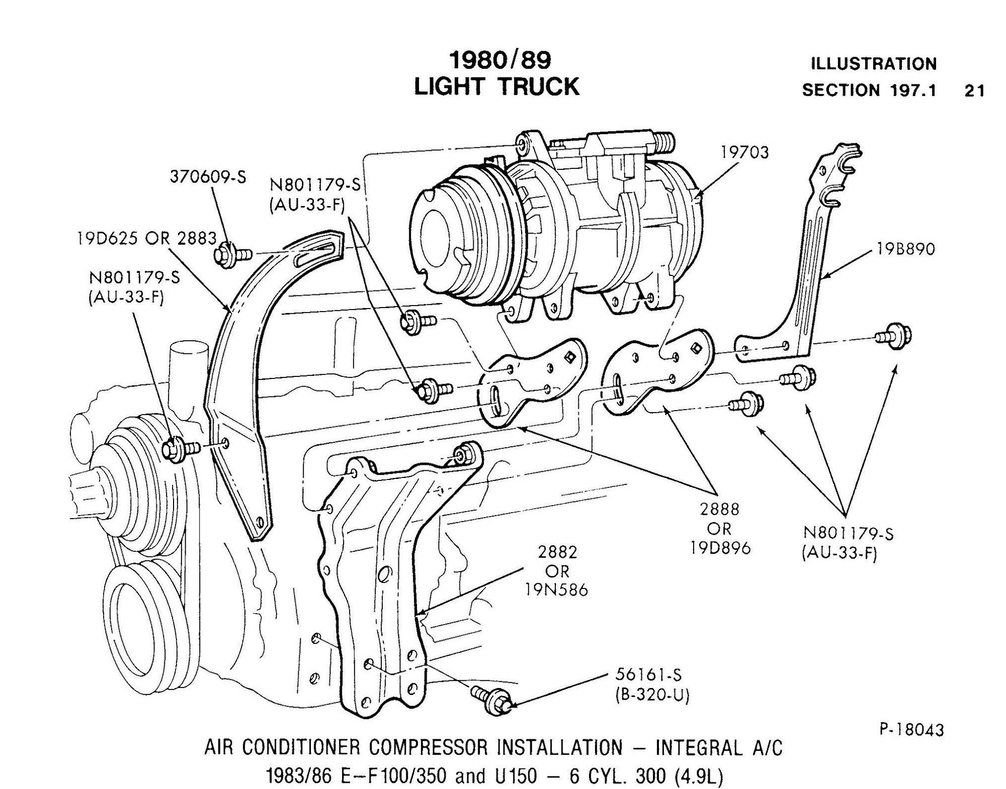

Well I thought I would look in my 80-89 parts catalog and there appears to be several different options. There is dealer installed and factory installed.. one diagram comes from the power steering section while the other two come from the AC section.
If one of these diagrams helps and maybe shows the part you need the number for,, I can go back and try to find the list with the part numbers, I have not learned how to use this manual yet and so just have to hunt through it...

Annaleigh , thanks ,great info as i am in no big hurry for this ! Trying to convert my 85-f150 to the saginaw pump as for a while being told I need the bracket from the same year van .This would be factory air not dealer .TR

Per te diagram posted 1980-1986e150/350 6 cyl.300 will be 3c511;3a732,and the pump,3a674 which is a Saginaw power steering pump TR

Hi Black Ford XLT,, Hopefully NumberDummy will reply back. I just got back home yesterday and today I glanced through my 1980-1989 parts catalog where the diagrams came from. Again I am not very familiar with using this PDF catalog but cant find the list with the part number for the full part numbers for the brackets you need. I bought the catalog on CD for my personal use but share what I can here to help... NumberDummy as you probably already know is the master at this!
Those diagrams above are the only ones I could find in the catalog. I did not see one that shows the PS pump and AC compressor together.
On the diagram it shows "illustration Section 197.1..... Then normally I would look in the part number section of the catalog 197.1 but there is no 197.1 section the catalog .
The catalog is 2 sections part A is part numbers and other info while part B is the illustration section.
Sorry I can't be of more help right now...
