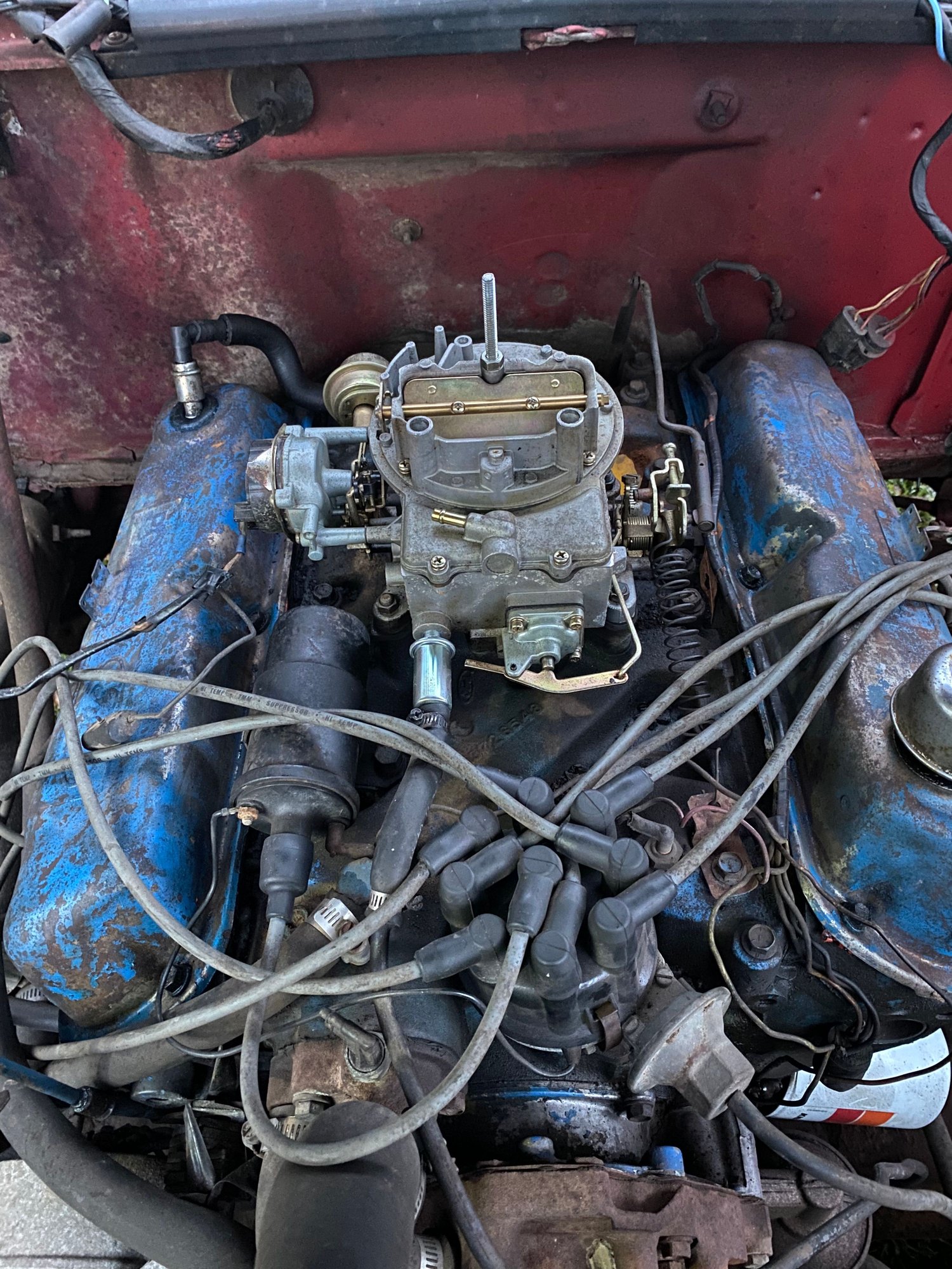

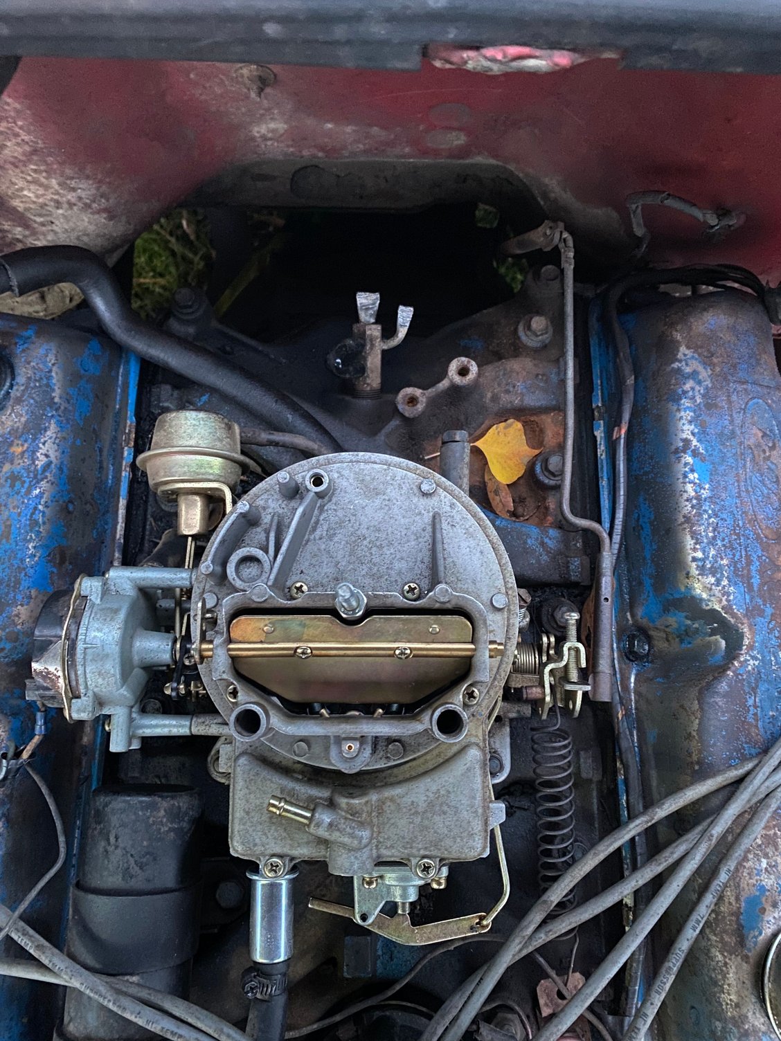

I agree that’s why the brake parts are still in the boxes lol I don’t have power breaks and it is a three on the tree that has been converted to the floor this is what I got
I am at a loss I have worked on it all day I bought the repair manuals today to go through and try to see if they tell me what I need to have hooked and not hooked up and where I need to set the float. After reading for about 8 hours lol I trying the external gas can to make sure it was sucking gas and it was but it was still pushing gas out of the accelerator pump like it was flooded. I pulled the carb broke it down and double checked the float level made sure there was no crapola in the bowl and also removed the jets and cleaned them out with a needle put it all back together. With all the hope and Xmas spirt in my heart started it up same exact thing the choke won’t open when at temp and still high idle and face smashing when I hit the gas and it is still spiting out the accelerator pump any ideas cause I am out of them

Your carb is a motorcraft / autolite 2150, One of the best carbs ever made. The choke to work properly requires both a 7 volt DC feed and a hot air heat stove connection from the intake or exhaust manifold to work properly and completely. The flooding that's occurring can be a few things like a stuck needle valve or a blown power valve. I would replace both as a starting point or send yours out to be rebuilt by a professional depending on your skill level for this work rather than buying a rebuild.The vacuum connections is again a exercise in patience, Do you have a points distributor or a Duraspark distributor ?

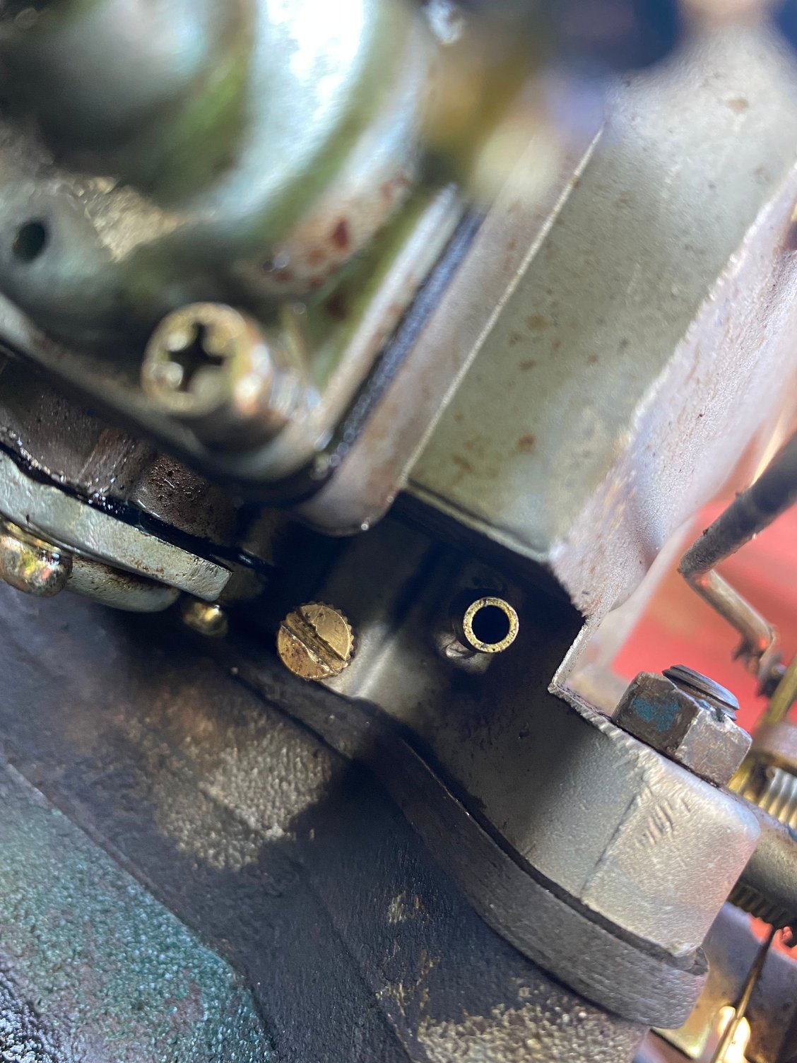

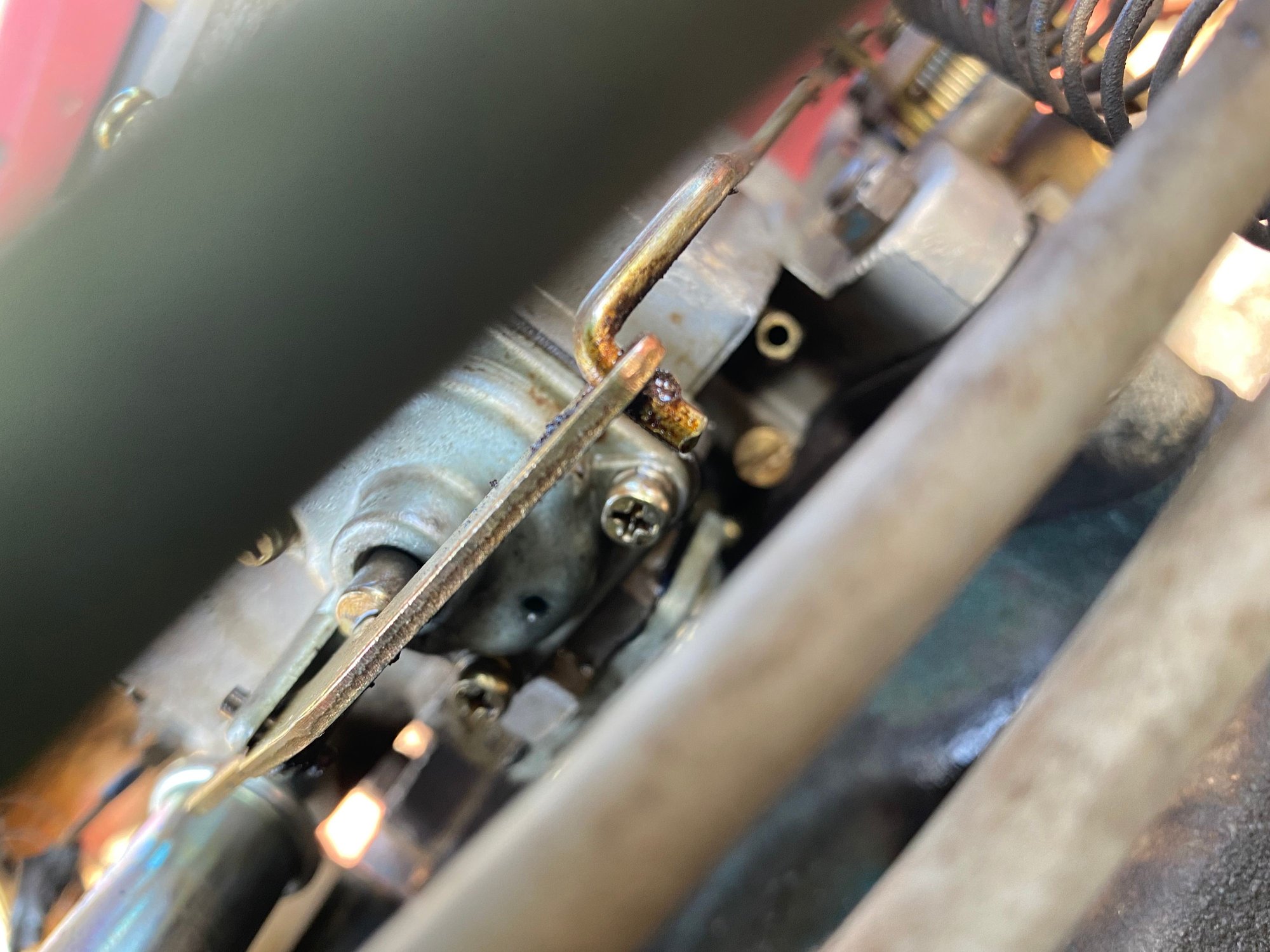

So had a super productive day I installed new fuel pump. Replace the points with a electronic set up and a new flame thrower coil. I hooked up the vacuum line to the distributor and the truck is running like a champ the choke is still staying closed and it is still spitting a little fuel out the accelerator pump but it is no longer falling on it’s face when you hit the gas. it is running the best it has sense I have owned it. There is one question I have what is this fitting it had some vapors coming out of it after running for a little bit

If nothing is normally hooked to the port in the carb you shown, cap it off, for you are leaking vacuum there, which will cause performance problems.
That is a vacuum port, and a vacuum leak. You can buy rubber caps which go on there, but they suck. I usually just use a short length of vacuum hose, with a screw or something stuck in the other end.

buy good rubber caps, I just bought a pack from chinazon, they appear to be working perfectly.
The screw trick works ok and I like to keep golf tees in my tool bag/box for this reason too but...
