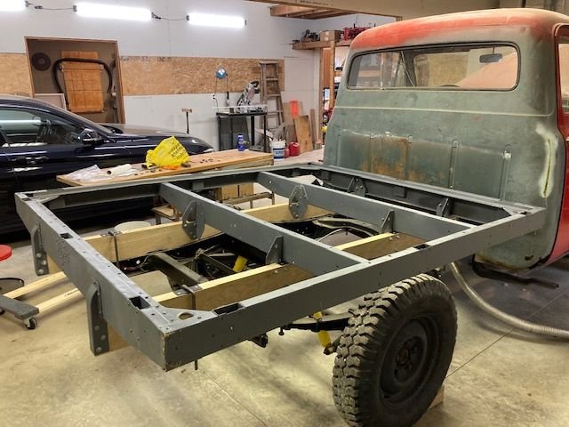

I am converting my '53 pickup to a flatbed. The runners are 1 3/4" thick by 5 1/4" tall and 85 1/2" long. The underside has to be contoured to fit the frame rails and clear various rivet heads etc. The originals appear to be made out of pine but I used white oak when I made new ones. Much harder and rot resistant. The deck is recessed between the bed frame rails. The full deck measurement is 68 1/2" wide by 81 1/4 long.
Bed Frame Installed
Originals
