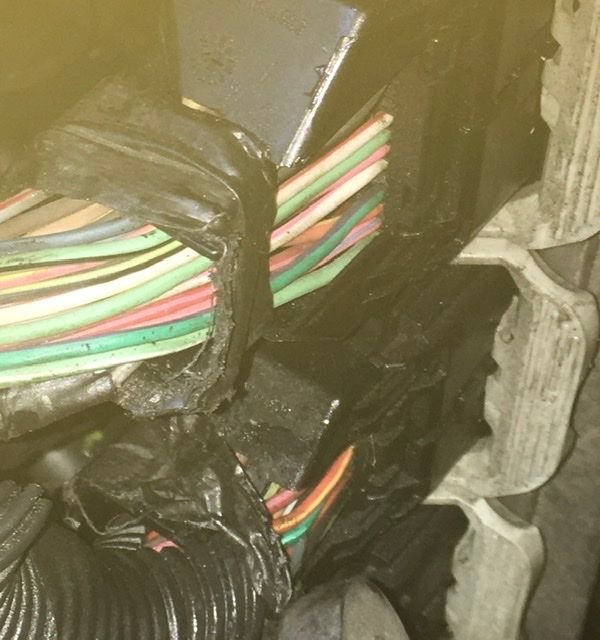

but I did notice something odd. While under the hood, I noticed I had a coolant leak on the tstat housing, right next to the ECC. And the ECC wire harness was broken, exposing the wires. I might pack them with dielectric grease to see if that makes a diff

That first photo might not be the t-stat housing leaking--it could be the cross over tube mounted to the intake manifold. If that's the case a proper repair would be replacing the intake manifold.
That's somewhat common for the plastic intake manifolds used on the Modular Motors. I don't know that would cause your no start condition but it should be further investigated

I finally had some good weather and dug the van out of the snow to tackle the no-start issue.
But first I wanted to figure the leak around the TStat. When I removed the top, there was no oring inside? That might have been might mistake when I changed the thermostat 4-5 years ago, and the friction alone was enough to seal all this time? fixed now.
Then the engine. I suspected that the issue was the wire harness connectors to the ECC. They are missing the housing, so the ends are exposed. I think the coolant was causing a short.
I gave them a heavy spray with deoxidizing spray. THen packed the harness with as much dielectric grease as would fit, then wrapped with tape as best I could.
And it started. Runs fine. I'm 90% sure this was the issue, but could also mean something was wet, and is dry now, and the problem will come back. However, I was also having an issue with the dash. Guages would work randomly, and that damn chime was always going off.. that all seems fine now.
