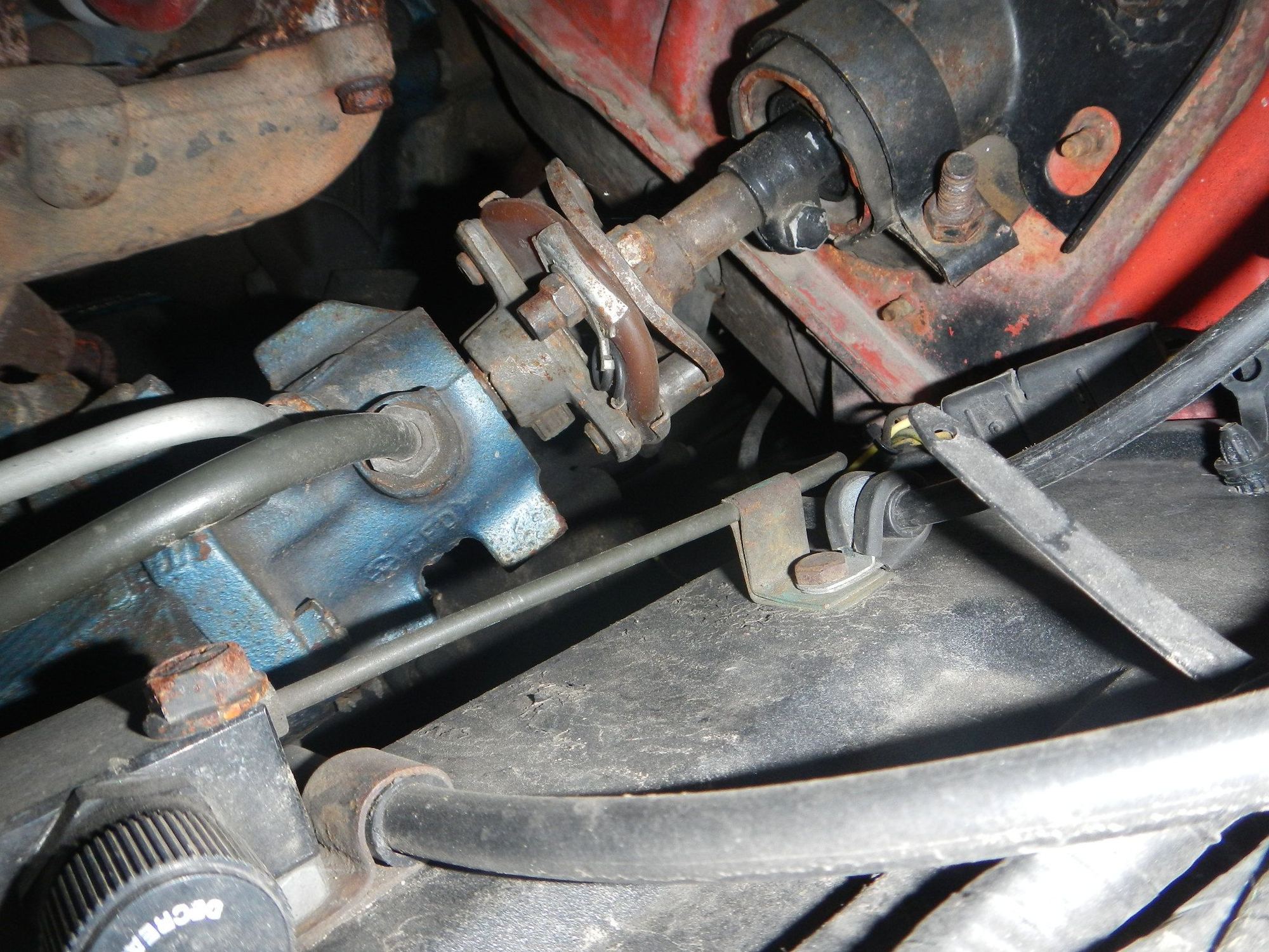

Your going to need to loosen the clamp on the firewall and the one under the dash to move the column, that is if it what has moved down. The other is if the shaft has moved up. You can tell that if the rag joint has separation.
2nd pic is what it should look like.

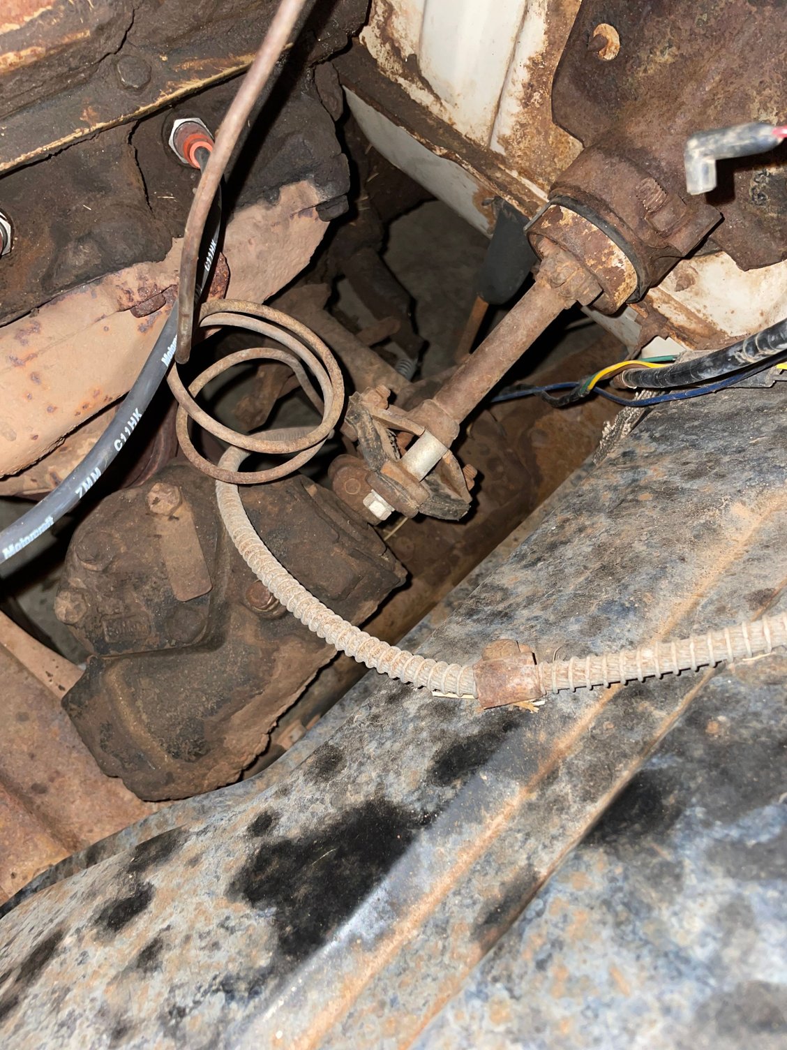

Here’s what mine looks like. Probably needs to be replaced huh?
Old Dec 15, 2021 | 06:39 PM
Christmas's Avatar
Christmas
Joined: Jun 2018
Posts: 3,556
Likes: 444
Looks like something moved and has the rag joint looking not so good. What kind of gap do you have between the column and steering wheel?

at least a quarter inch. There’s definitely a gap. Ordering a rag joint on rock auto.
