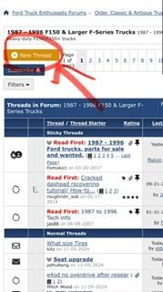

Originally Posted by TGrizzle
New member, new question:
Sorry if I am running counter to group etiquette here, I can's find a place to start a post, only a "reply"... here goes.
It’s right here
Old Nov 8, 2024 | 08:30 AM
TGrizzle's Avatar
TGrizzle
6th Gear
Joined: Nov 2024
Posts: 6
Dang, it was so obvious I missed it. thank you
