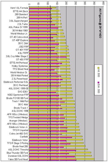

To get into that power range you need heads with AFR185 like airflow, so while there are options it's still going to cost good money. What are the casting numbers on the '74 heads you have? The early windsor heads were roughly equivalent to a modern GT40 but the smog era started in '74/75 and the heads created in those years are only useful as boat anchors. Here is one of the largest comparison charts I have ever found, it doesn't include all the Ford heads ever made but it will illustrate the differences.

When you say "AFR 185 airflow" are you referring just to 185 port size and 58cc combustion chamber or more specifically something special about how air flows through those heads?

Its all about airflow because an engine is essentially just an air pump, so head airflow determines HP potential. Port volume is somewhat linked but by itself really doesn't say anything about how well a head works. A good example of that is the chinese World Sr head, ports are the roughly same size but flow quite a bit less.
