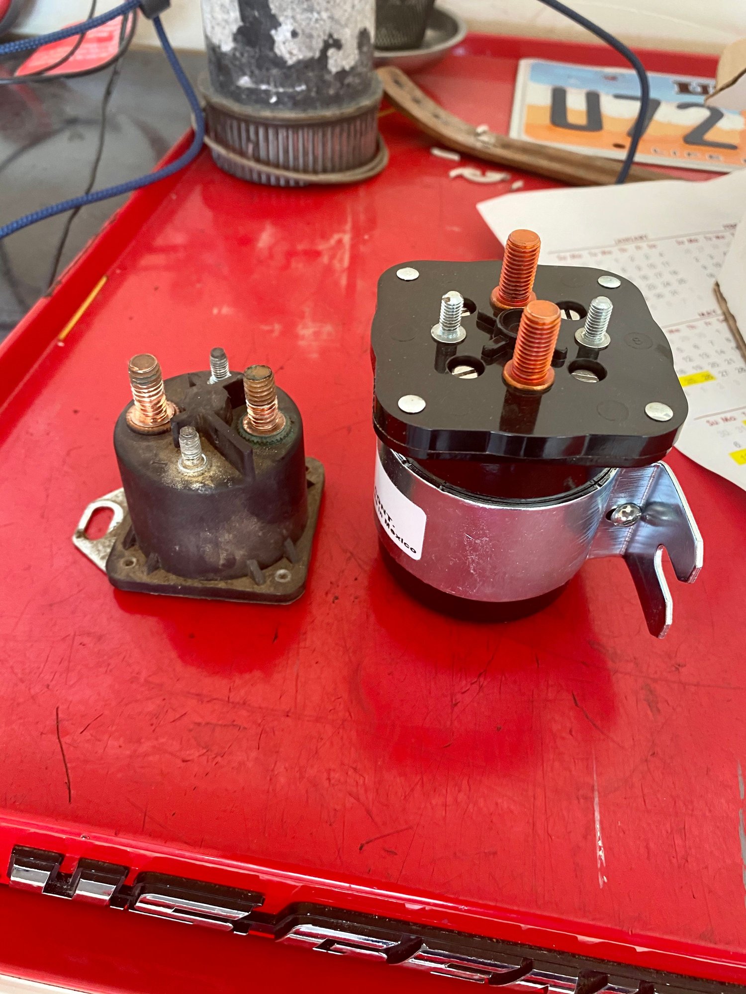

Old Dec 6, 2021 | 06:08 PM
Rot Box 2's Avatar
Rot Box 2
Joined: Oct 2020
Posts: 467
Likes: 158
Here’s the White Rogers compared to stock if you’re interested. Breaths fire into those sticks!
Not really just much larger surface area on the contacts.
