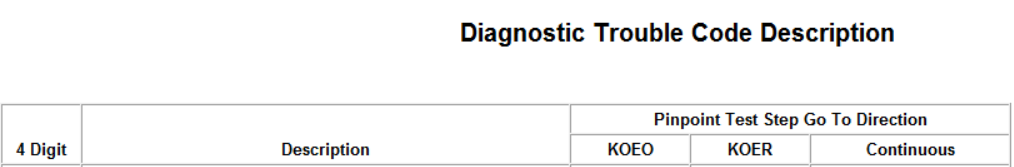

@exbxtoy , according to the PC/ED volume of the Ford Service Manual, you should be looking at pinpoint test DE and step 17 as seen below.
I have attached pinpoint test DE for your review in an effort to resolve your DTC issue.

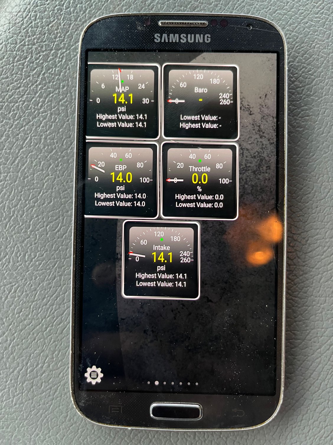

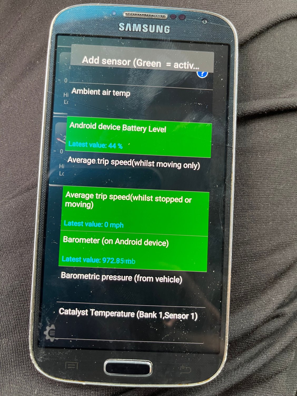

what’s the Baro sensor on Torque Pro? I think mine all read correctly see the picture. However the sensor called Barometric Preasure (from vehicle) does not show anything. Is Intake pressure the same as Baro for Ford?

I despise TorquePro and cannot offer any help in person or on this forum.
Baro is barometric pressure in which the sensor is internal to the PCM on your 2003.
I would say the same as you in that your EBPS is functioning properly as it is within .1 of MAP. This is a good thing because your cleaning method worked. You are more fortunate than I was as I needed to replace my EBPS, even after a rigorous cleaning session.
