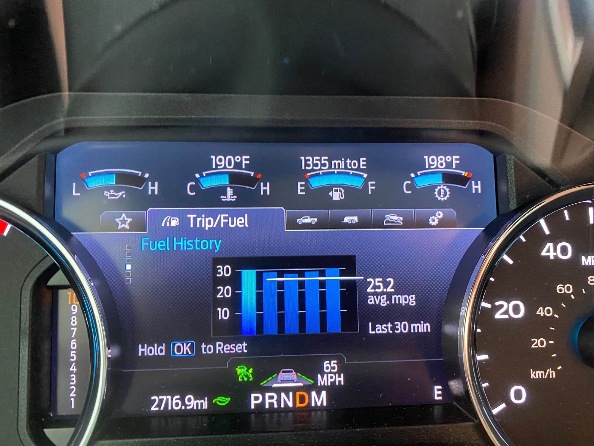

I like the ECO mode when empty. With the S&B tank on my 2020 I drove from Denver to Louisville. 1100 on one tank. It helps smooth out acceleration and jack rabbit starts. Cruise at 65 in the far right lane. I dont have the attention span for 75-80
