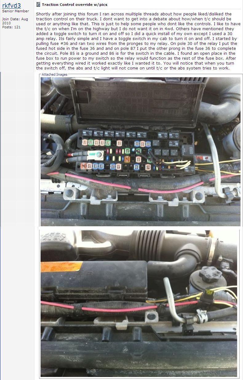

I don't have too many complaints about my truck, but the one that keeps coming to mind is TCS and SCS. I have a 2010 5.4 FX4 and the most annoying thing about it is how much the systems baby you but don't really seem to add IMHO any substantial value to my safety and contradictorily actually seems to be unsafe in many cases. I know that there's a couple of fuses that you can take out to completely disable it but it also disables your ABS which is not cool. But what I'm curious about is whether or not anyone knows of a way to disable JUST the TCS and SCS other than disabling all safety nets. I've read quite a few threads with inconclusive results other than pulling a fuse under the hood and one inside.

Excerpted from the owner's manual... *Yes, it has to be done each time the vehicle is started.

That was a pretty decent read there. I appreciate it. I figured I was missing something when I was searching. I'll have to try the toggle switch idea. I just figured that pulling the fuses disabled everything even including ABS which as I said before was something I wanted to avoid. I drive my truck a lot in my fields and I've noticed that TCS and RSC hindered me when pulling something or trying to get up a hill more than it helped and...of course, who doesn't every so often have to deal with some mud? I remembered last year when I went fishing I had to drive across a riverbed which is under most circumstances easy to traverse as it's mostly gravel until a certain point and I've driven through it hundreds of times with other vehicles without issue but much like any mud, wheel speed and momentum are your friends...but TCS says ''naw, they're your friends, but I'm your ex wife.''

I too have a grave dislike for all the nannies on these vehicles today. I put a mild tow tune on mine and it allows you to turn off just the traction control except contrary to claims it doesn't stay off, you still have turn it off each time you start it but it stays off until you shut truck off. Same tune from same vendor on my 15 super duty stayed off period.
