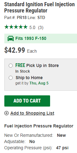

Could be wrong fuel pressure regulator, if you got like below pic, see the operating pressure of 47psi, not enough.

Put the old fuel pressure regulator back in gage now reads 62 PS! so clearly the one I purchased was not the right pressure. Checked it with the hand vacuum pump and saw the fuel pressure dip as I applied vacuum and the vacuum held so it is working as intended.
