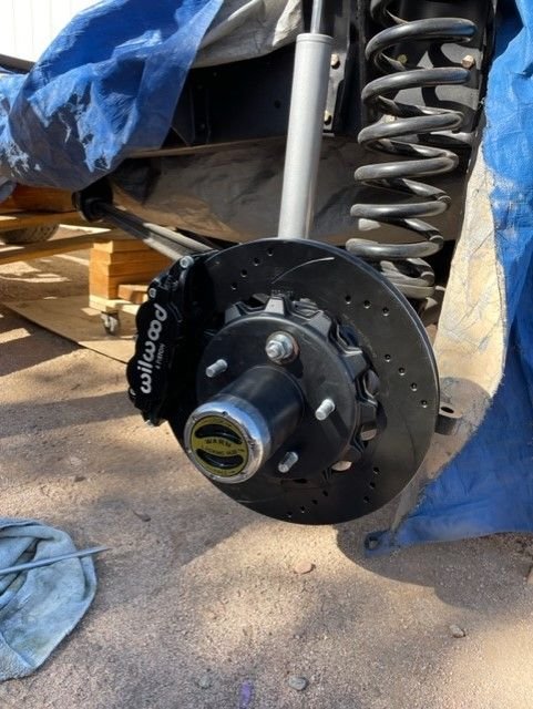

I now have the rear and front axle installed along with the disc brakes all around, 14" rotors up front. Unfortunately the cashed out 15" wheels I have won't fit over the new front rotors. So I'm on the lookout for used 18 or 20" wheels so I can have a rolling chassis again.

wow nice job on the brake upgrade.
The first 4wd brake upgrade I can remember seeing on this website actually.
Will you compliment the 14" rotors and (guessing) 4 piston calipers with hydroboost?

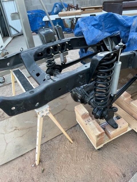

This truck had none of it's original suspension components when I got it, and I'm just now learning how important a trac bar is. Or track bar, or z bar, or any number of names I've found online for the exact same part. Basically the bar that mounts on the frame between the coil tower and the power steering box, and goes down diagonally to a stud on the passenger side of the Dana 44.
I've had no trouble finding an adjustable trac bar, the stud, bushings, etc. But I cannot find the bracket where it mounts to the frame. Looks like Part #3A093 on this diagram, but I'm not having any luck finding a stock height replacement part online. I can find all kinds of them for a 4" or 6" drop, but nothing for stock height. The 2.5" suspension lift I purchased came with a relocation bracket that fits inside the stock bracket, which is what set me off an this mythic quest.
Any suggestions?
I don't really want to fabricate my own, but hey, whatever it takes at this point. Thanks!!

Why not measure the drop bracket that came with your kit and buy a reproduction bracket with the same or similar drop?
fwiw a 2.5” lift likely comes with 2.5” drop bracket. You could buy a 2” bracket and be close enough with an adjustable track bar.

Buy a length of square tube/C-channel the right size to fit the end of the tracbar and make your own.

All the reproduction brackets I can find actually bolt inside the factory bracket and use it for strength/rigidity. They're not designed to bolt directly to the frame and use by themselves. I'm going to have a buddy help me make one with a piece of 3/16 tubular, a plasma cutter, and a drill press. I don't know how long stock is, but I'll make it long enough so the bottom hole puts the trac-bar parallel with the drag link

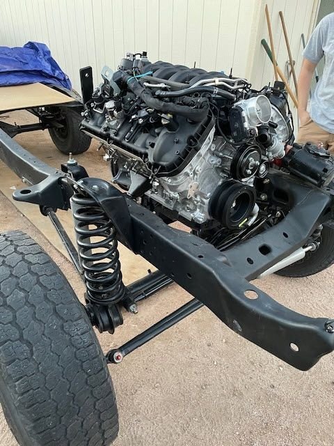

Wow its been a long time since I updated this. So the Coyote and 10R80 are in with FFG custom headers. I lost about 6 months waiting for FFG to fabricate a cross member for an Atlas adapter and the stock NP205. Very pleased with the finished product though. The cab and bed are on. The bed has been Line-X'd. New Boyd fuel tank. The dash has been gutted and is ready for gauges and a new AC. It graduated to the garage so things are moving along quickly now and plumbing is next!
At what point does it make sense to go with hydro boost over a vacuum brake setup? I plan to run 33" tires and the stock Coyote should motivate it nicely. I want great brakes and I know hydro boost supplies more pressure so it's better, but the idea of additional fluid lines under the hood and the possibility of not having brakes due to something power steering related just sounds odd to me. What are your thoughts? Is vacuum going to be enough or should I just go with hydro boost and get over it?
