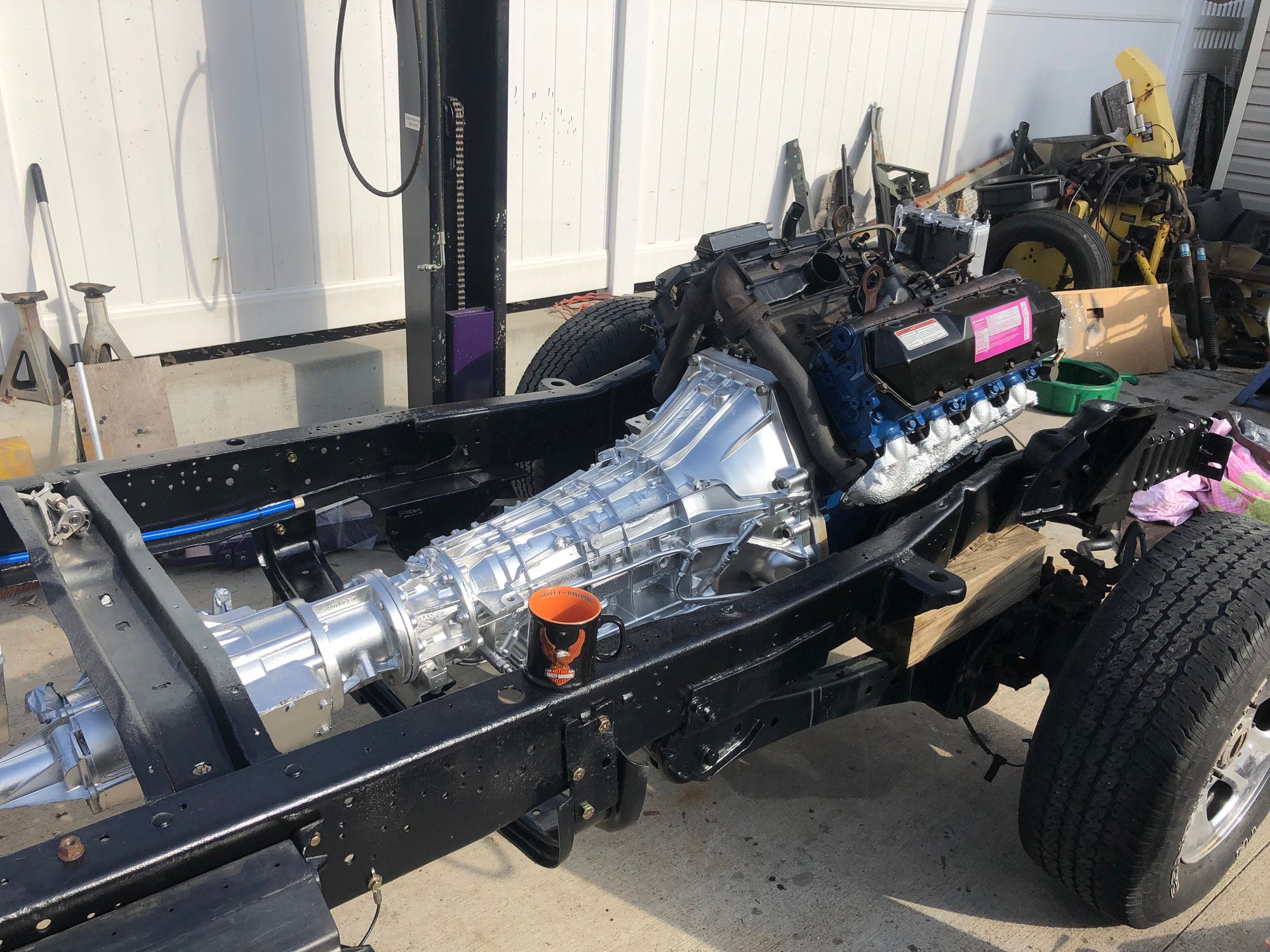

Has your starter been replaced recently?..??…..is it loose??…is the positive cables on it clean?? How long have you owned this truck??…sorry…I get crazy when I can’t be hands on….I just moved my under hood battery to the frame….and making all new cables….
