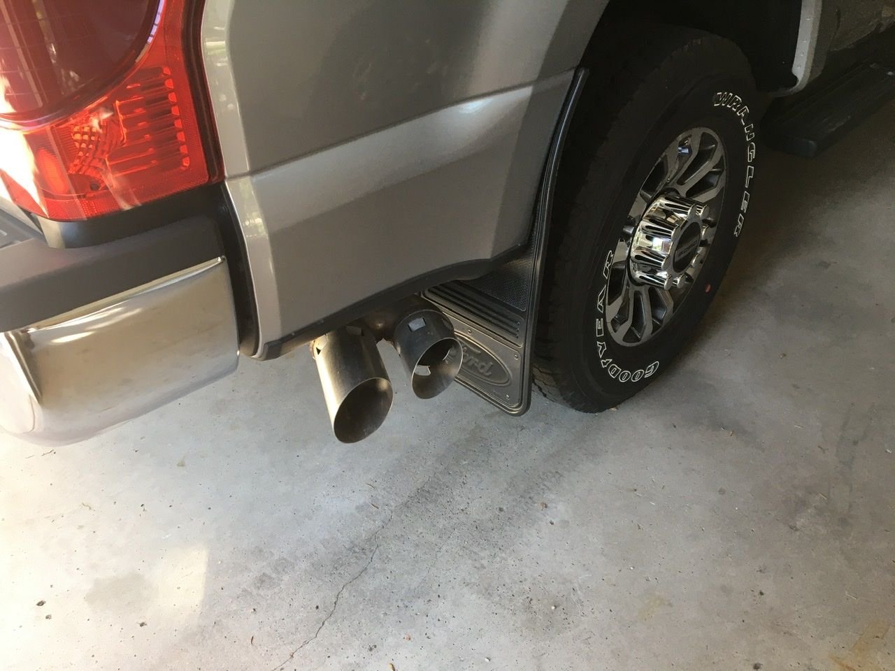

Form fitted mud flaps, while they look good and are cheaper, have the problem of trapping sand and gravel between them and the body panels. This is made more serious with aluminum body panels since the alloy is softer than steel, so these grains can actually wear into/ through the panel.
Flaps with a dedicated bracket that can provide ample separation can mitigate the issue, which is why I prefer rockblok, gatorback etc.
The husky and weather tech probably aren't an issue if you drive on pavement or clean between the flap regularly.

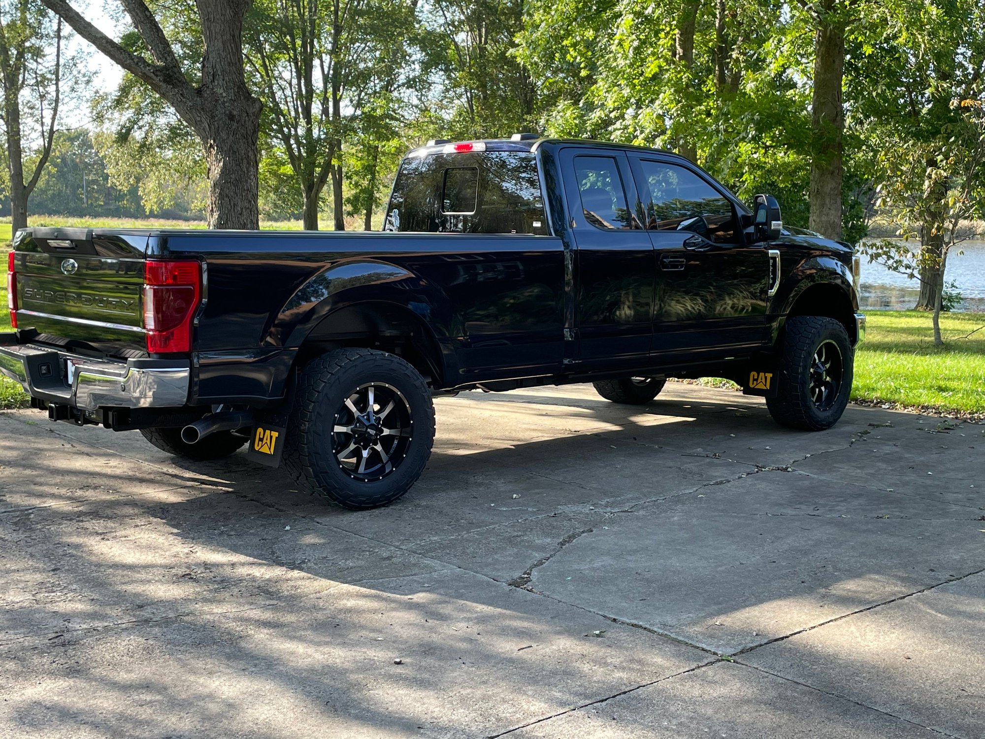

I added the Rok Blokz mud flaps but replaced the original rubber with Cat logo rubber. Easy install, strong brackets and excellent coverage.

Looks awesome. I work for cat

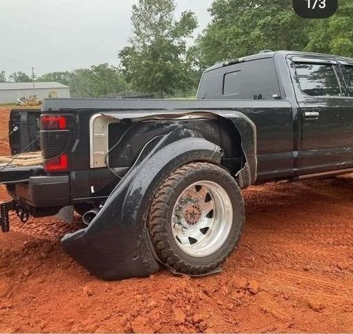

And be careful if you have a dually and are backing up...even over curbs:

Not a problem if they mount to the frame.
Gatorback was easy to deal with, replaced it for free even after I explained I tore it off on some rocks backing up.
