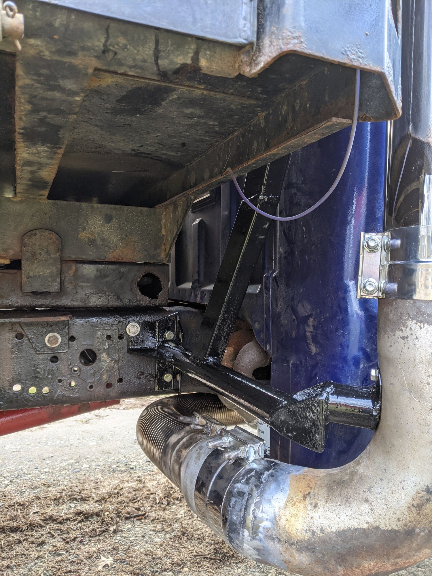

Originally Posted by Brandonpdx
Curious how you routed that and if it's hard bolted to the frame for support. I got to thinking about doing this at some point because the stock exhaust routing is actually kind of problematic on the cab and chassis trucks with the rear mounted steel fuel tank. My aftermarket 4" would bang into the front passenger side corner of the fuel tank until I rigged up a fix for it, but it would be a lot cleaner to totally delete that rear section of exhaust. Hard mounted to the frame like on a semi tractor you'd need a section of flex pipe somewhere between that and the motor. Looks proper on a dump truck though.
Funny you say that, interference with the fuel tank is part of the reason I did mine (the first iteration was 4", this shows the upgrade to 5" to allow for the internal muffler).
As you can see, I have a piece of 4" SS flex in there.

Originally Posted by materthegreater
Holy crap. You could tow a light trailer with that support bracket.
Old Dec 3, 2021 | 02:08 PM
FinnishStroker's Avatar
FinnishStroker
Joined: Mar 2019
Posts: 2,907
Likes: 788
From: Kinnula,Finland
In general,i like stuff being built to last.
