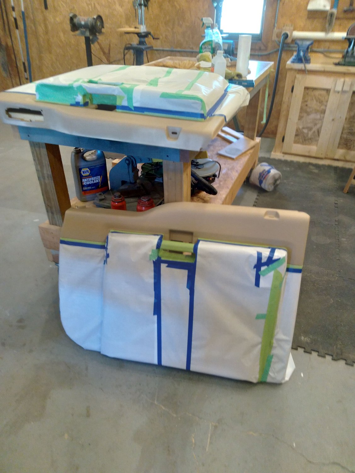

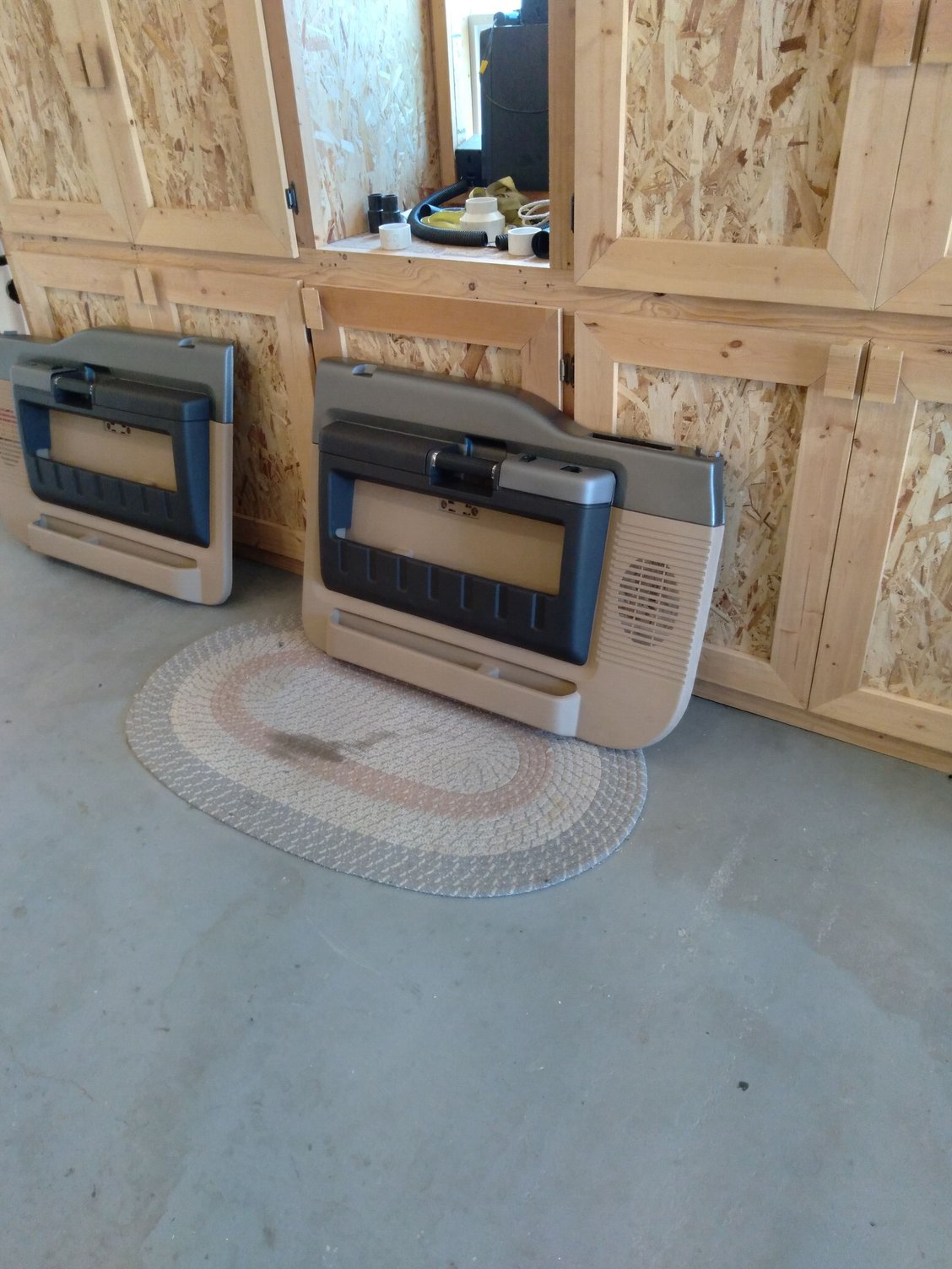

Had the same problem with my door panels on my 2013 a couple of years ago and I couldn't find anything to match them so I used base coat with a matted clear coat and a different color to come close to the other trim colors. I cleaned it with alcohol before applying the base coat. If I remember the color was close to Magnetic Metalic.
