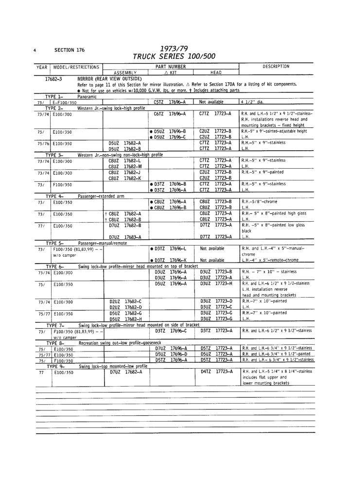

Type 3 (Western Jr's) are 7x9, type 12's (Western) are 7x16.

What is the Type 2?

Read the chart....5 1/2 X9 1/2 or 5x9

Ford: Western & Western Junior Mirrors // Aftermarket: West Coast mirrors.
TYPE #2 are F100/350 high mount Western Junior Swing-Lock Mirrors // TYPE #3 are F100/350 high mount Western Junior Camper type mirrors with 3rd steady-rest arm.
TYPE #12 were installed on 500 and larger series trucks.

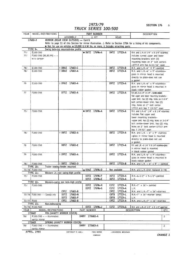

Look at the parts catalog pic of these mirrors in post #2

Are they on the chart above? If they are on the chart, which type?
