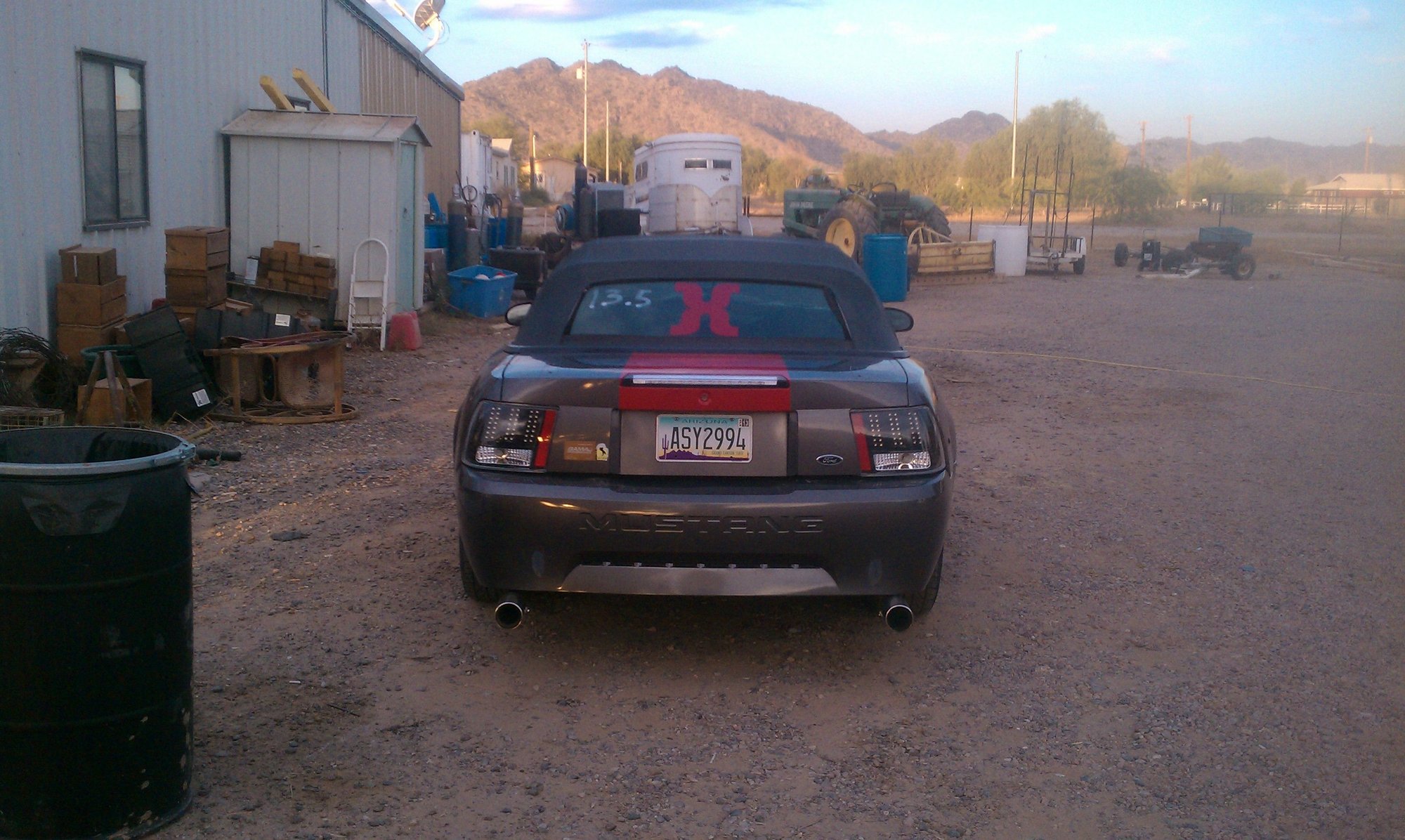

Here are my other builds
The Gray one i put together from a junk yard, bought it after it had T-boned a truck, and put it back together, hence un-matched paint, sanded front fender, and other details do not match up, there are parts off like 7 cars on that one vehicle.

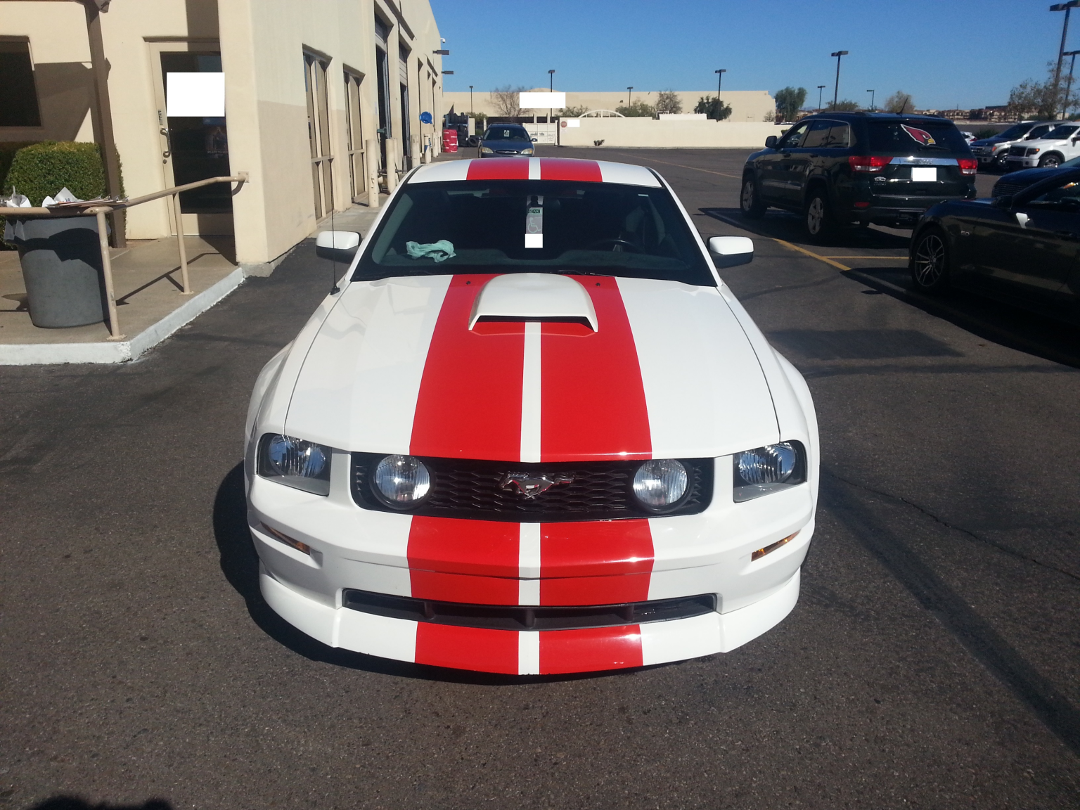

The Red and White is my little monster, hours of dyno tuning, intake, exhaust, aluminum driveshaft, and other bits, and its a TR3650 manual, it does 0-50 in 4.5s, and was my second vehicle to breach 150 MPH.
