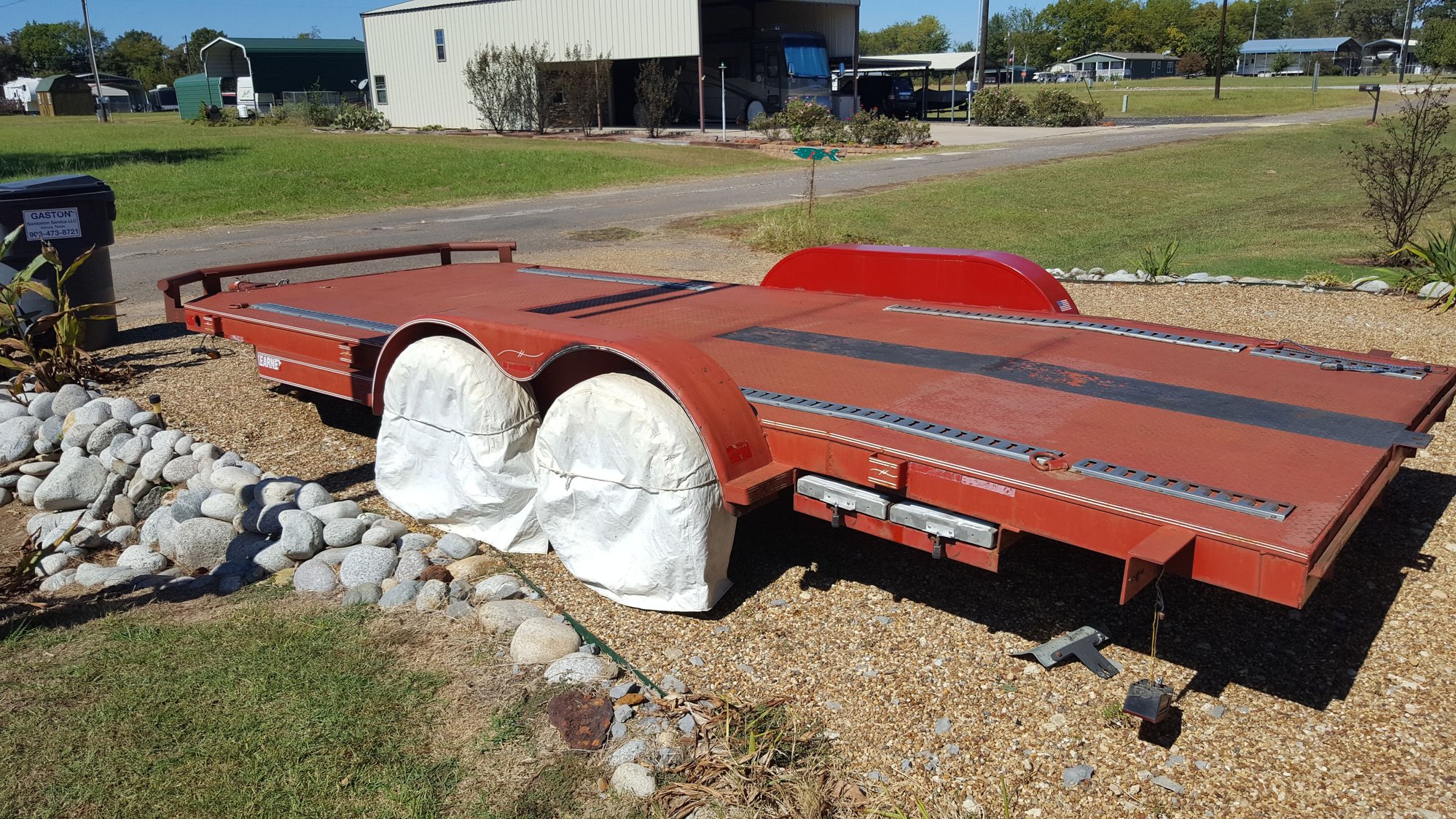

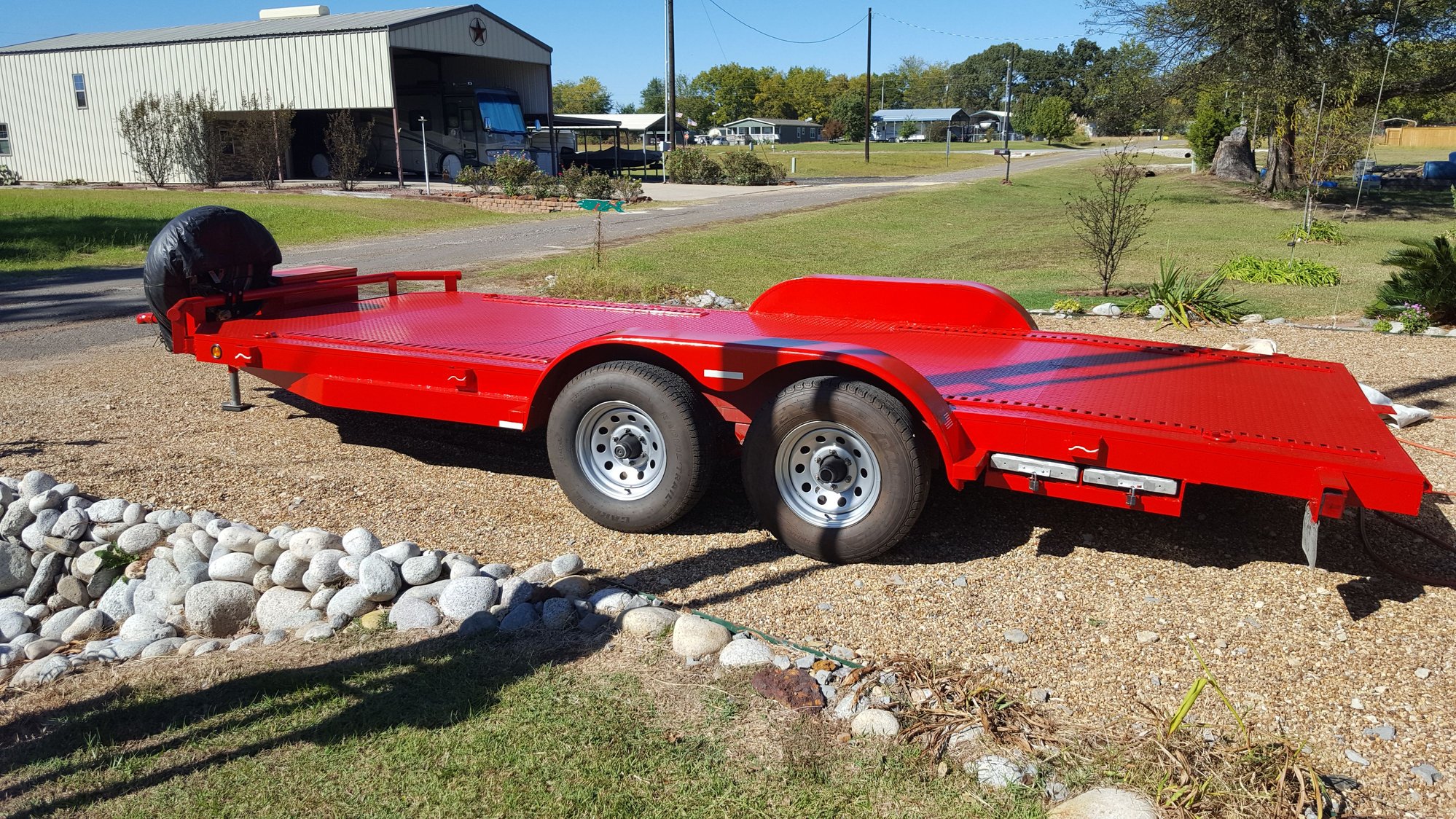

never thought about rock chips on the hauler trailer. its been repainted 2x now since 2008. sun eats the paint up faster than road rash around here
