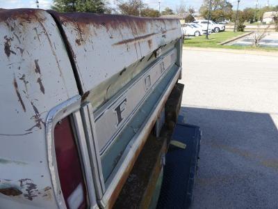

I just picked up a 1969 F100 today from an old farmer down the road... while I was in my shop he used a tractor with a strap to lift the back of the truck and the straps bent the ***** out of the tailgate.... I'm pissed and heartbroken. Is the tailgate fixable? Can it be straightened or should I just suck it up and buy a repop tailgate? Any suggestions on a god repop brand tailgate? Thank you

I was trying to upload as you were typing The dent is worse than it looks in the photos errrrr

Take it to a body shop, some of those guys are magicians. Original is always better than replacement…

I'm not saying it can't be fixed but in my experience working on a number of these tailgates the top part is the hardest (as in very strong) part of them. I've tried to pull a number of dents and it's difficult at best. Bending the whole gate and then trying to bend it back might not be worth the effort as it looks like it was already damaged. I would do as Obscure says and see what a body shop has to say and then go from there ( I would assume it will cost more to repair it then a new one but I could be wrong). FB "Market Place" seems to always have a number of them listed in my area, not sure where your at but it might be worth keeping an eye on there for a while.
Good luck, hope you find a solution

Can it be repaired? YES .
Can it be repaired economically? Compared to the cost of a re-pop, NO.
I have seen it done, they cut it all the way across the small radius on the top, then drilled out the spot welds down the outside edges, as well as across just above where the letter are, made repairs to the piece, then welded it back together. Not sure of the exact time spent, but I know there were a lot of manhours. So do it, so you're better off either looking for a really nice used one, or buying a re-pop. **But DO NOT throw yours away!
