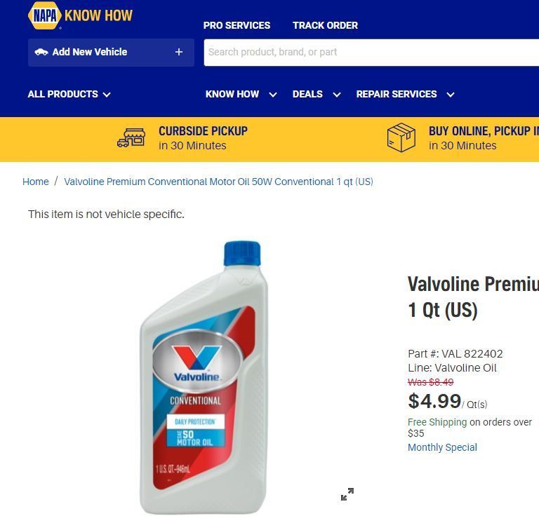

Wayne, definitely appreciate the feedback. Trucks are new to me and I'm not trying to go against what Ford recommended, however, I couldn't find any SAE 50 Engine Oil locally. Any particular brand SAE 50 oil I should try for the trans/transfer case?

I use this basic valvoline 50 wt. I forget if I ordered it online, or found it at a local store - But I think it is fairly available.
Sounds good, i'll give it a try!
