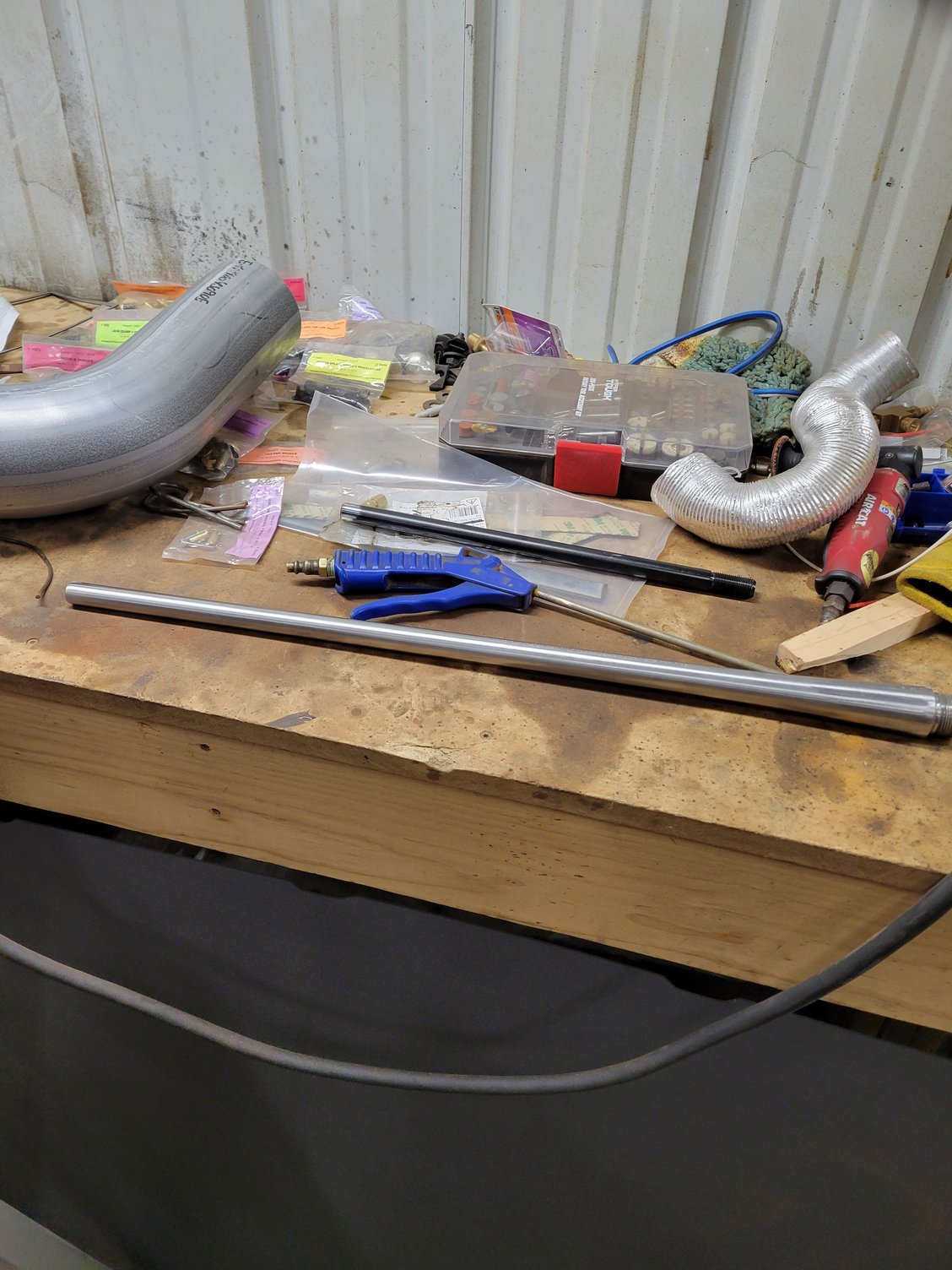

OK here is my plan. Went to my dad's house found a 375 H&H mag 26 inch barrel tapped the end of it put some all thread in the end of barrel and screwed a shifter on. I then drilled out chamber end so it would go over the trans stub shaft then welded a nut on the end and put it in place to check fitting. Found out that in 2nd and 4th it was hitting the transfer case shifter. So I then pulled the transfer case shifters out shortened them by 6 inches. No Pic of that yet but it only hits now in 2nd gear. But that will be an easy fix just have to put a little S bend in shifter. Yes once I get seats put in I will cut down shifter so I don't have some stupid high shifter. Not a dam bull wagon peterbuilt. Lol truck drivers will understand that

I like that barrel shufter idea! Was it a shot out factory barrel swapped out? I just wouldn't want to use something nice or usable.
to be honest i have no idea if the barrel was any good or not. It was sitting in his shop in a bucket. Yrs back my dad was a gunsmith and had his own shop. so we just hit it with some polishing wheels knocked off the sights and now it is sitting in my truck.
