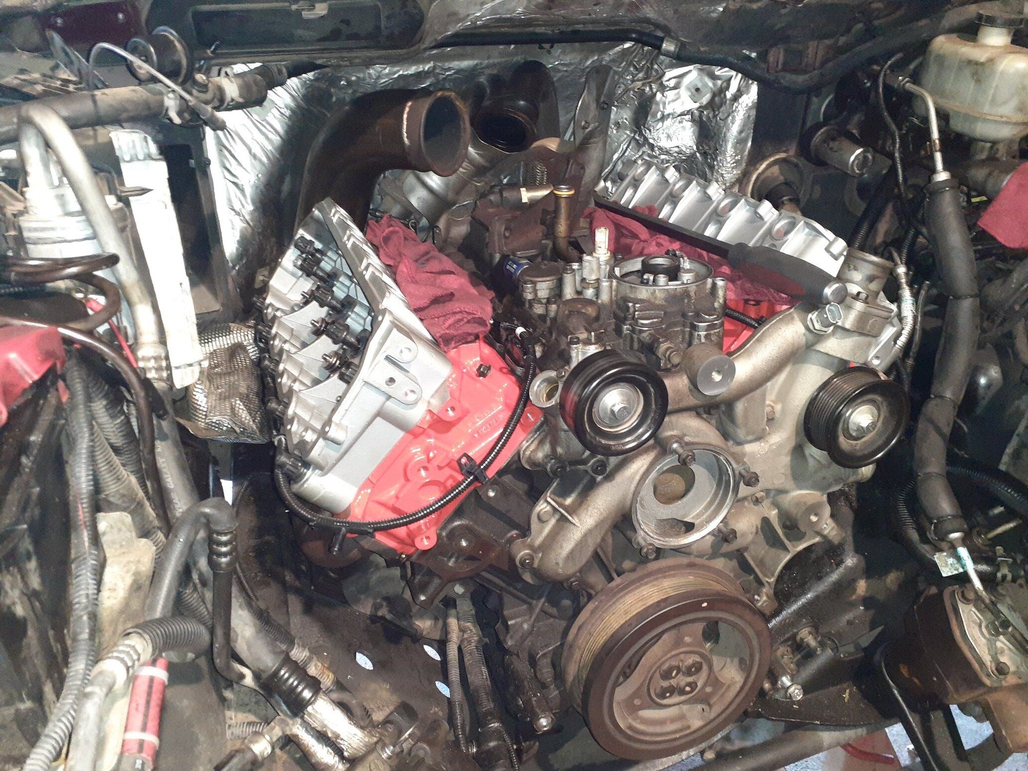

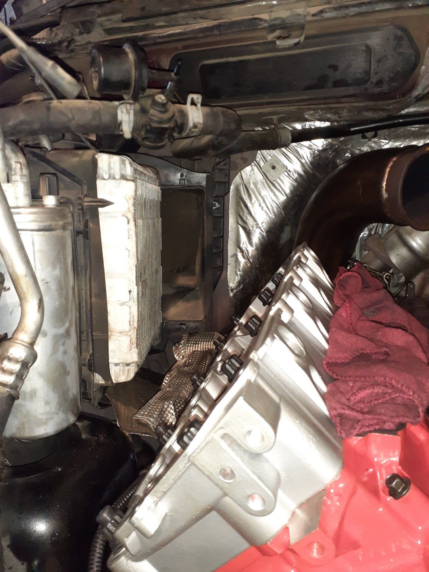

Well, I did mine cab on. It is much easier with the front end removed, which is not hard to do. AND, pull the evaporator core cover off as well. Makes it a lot easier to get to the head bolts on the passenger side. The trick during reassembly is securing the head studs with rubber bands or zip ties in the heads when you re-installl them. Just the back four. Making sure everything is spotlessly clean. And use a 3/4" torque wrench. Because 220 ft. lbs. on a 1/2" torque wrench is brutal and a cheater pipe is really needed. B.

Thanks linden for the great photos and info too, that stuff helps me so much and makes these questions no one seems to be able to answer just disappear. Thanks guys
