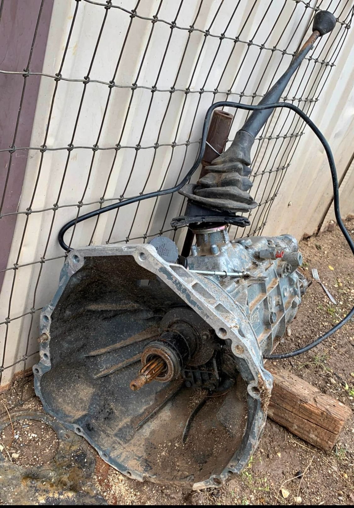

I’m toying with the 5 speed transmission swap for my 1981 f150 with a 300 six cylinder.
this transmission popped up close by.
supposed to be out of a ‘96 f150 with a 300.
I’m not sure how much I should believe the seller because he says it is a C4 transmission.
here are the pictures he sent me.
Front view
Side view
Information tag

The C4 was a 3sp automatic trans built in the '60's. it's definitely not that. With the integrated belhousing and allegedly being from a '96 F series that would be the Mazda M5OD which is exactly what you want. But that trans was also used in the Ranger so you would want to check the belhousing bolt pattern.

That transmission is the m5od.
different years used the old speedometer cable, then changed to the tone ring in the rearend. All of them i know of had the hole machined into the tail shaft housing. You can see it in the OP picture. They installed a metal plug in the hole that can be removed. The main problem is there is not usually a speedomtere drive gear installed. That gear is reputed to be NLA. But i did find one online from a transmission/gear shop. I don't remember the shops name but it took alot of searching. And a few wrong gears.
