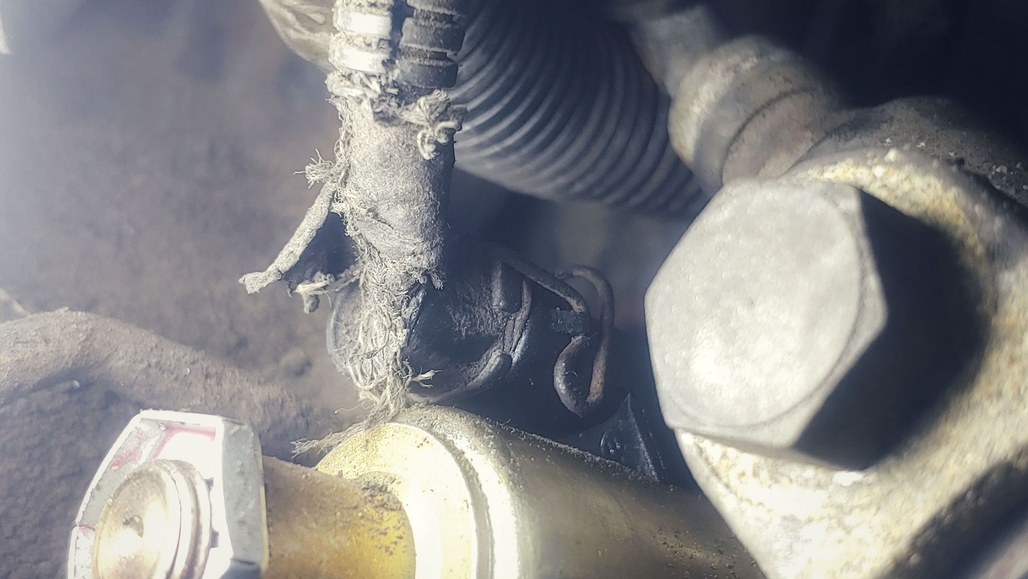

This is more of an FYI since I couldnt find much info on how to replace the IPR valve on a van with the 7.3L PowerStroke engine.
So with the aforementioned engine in a van body, the IPR much sits under the windshield and is pretty hard to get to. I was rebuilding the turbo anyway so I figured I'd try getting to the IPR from the back of the engine once the turbo is off (along with the pedestal). Anyways, this approach made it very easy to get to the IPR and the only difficult part was figuring out that the IPR connector has a metal retainer that must be flipped up (like an injector connector) before it can be disconnected.
Long extension to reach the IPR from behind the up-pipes:
IPR location:
Little metal clip on the IPR connector:
