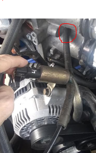

We recently got a 1995 f250. It is idling high it seems to be a vacuum issue. I’m trying to figure out what the person I bought it from did as it does not match the diagram under the hood. Would anyone have pics of the vacuum line going to the throttle body on a 95 f250 with the 5.8 Windsor motor? Thanks!

My 150, has the canp(charcoal canister) vacuum line goes to the small port on side of throttle body.

Thank you! Do you have two other vacuum lines connected to the other side of the throttle body? If so do you know what they connect to?

The 2 vacuum lines on the left side of the throttle body should go into a T or Y connector and then to the fuel tank vapor recovery reservoir
