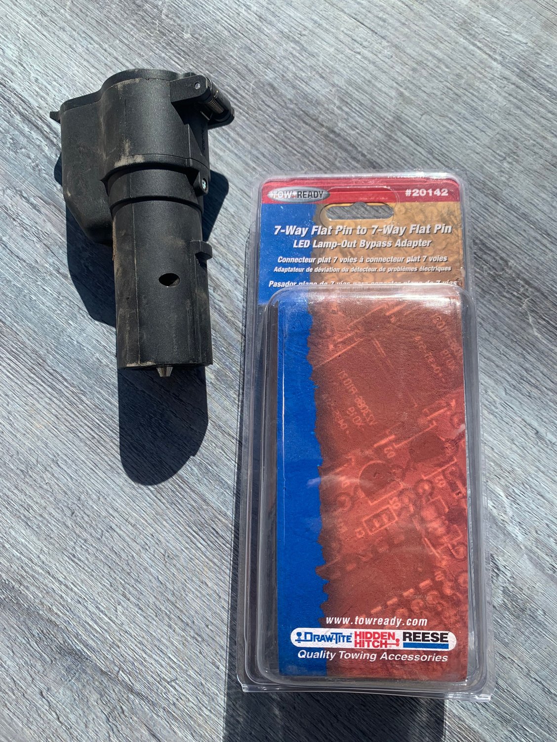

I had to purchase this adapter for the truck to recognize my truck camper. The running lights and brake lights are LED and don’t pull enough power to engage the truck electrical circuits.
Interesting... will look into it. Thanks
My boat trailer has LED lights all around and I don't have any issues with the lights and the truck not recognizing the trailer.
