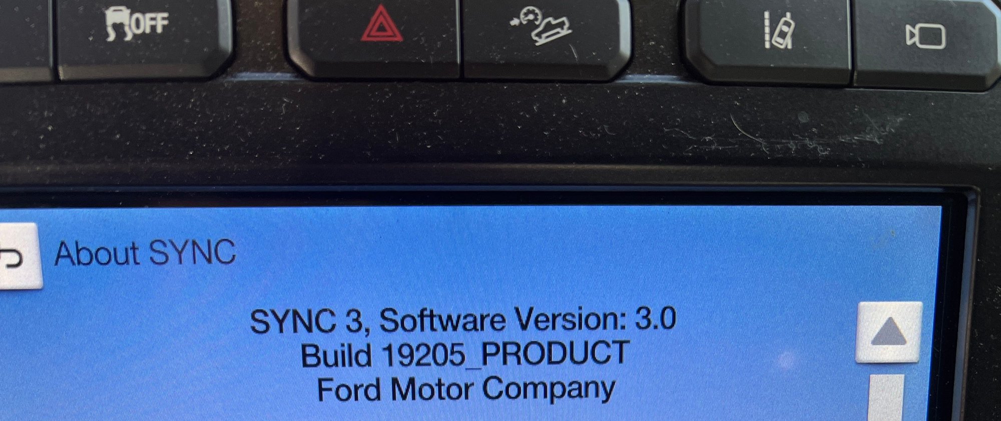

What build of Sync does your truck have
ie 3.4.2xxxx
The latest is 3.4.21194. I have had no issues since updating.
ie 3.4.2xxxx
ZooDad
I recently did this update via wireless while the truck sat outside of my house. Seemed like it took forever. But it did finally update.
ie 3.4.2xxxx
ZooDad
He might be in a 2019, in which case the latest version would be 3.0.20204.
The 450 is indeed a 2019.
When I scan for updates it doesn’t show any available (the truck is connected to my WiFi.
Both your Sync and Navigation are older versions.
My truck does the same, a scan while connected to WiFi never shows any update available when in fact there is. I have read of others experiencing the same.
I have updated twice since 2019 and both times had to go online, input my VIN to check for updates, then download to a USB.
https://help.ford.com/update-sync/
