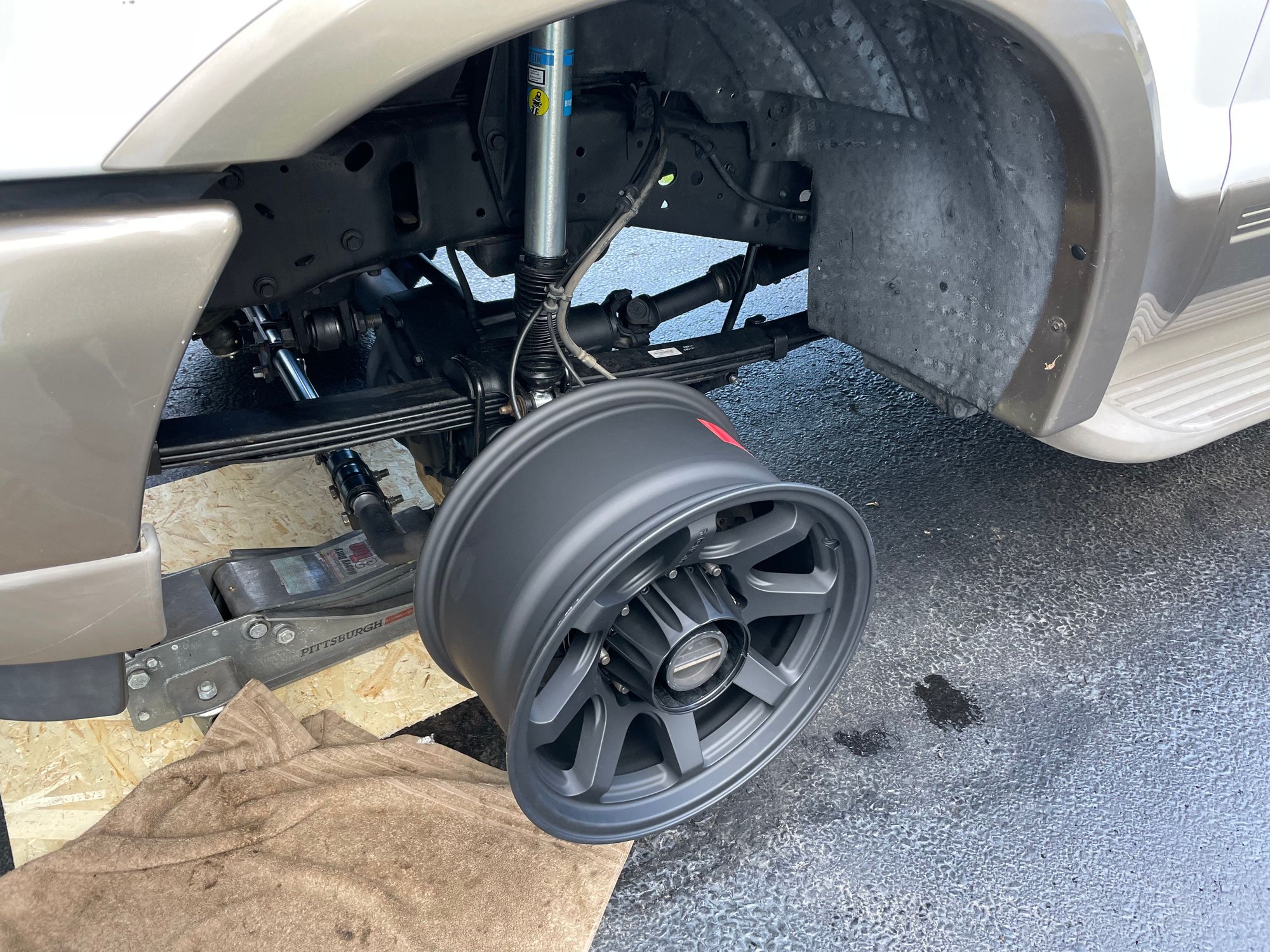

I ordered a set of Vision Flow wheels in 17x9 with 0 offset. Backspacing seems to be 5”. The tires were ordered separately and are 285/70/17.
I’m suddenly nervous that the backspacing is too much, and I might end up rubbing on the front leaf springs. I haven’t mounted the tires yet, so I could possibly still return these wheels if need be.
Does anyone have definitive experience running a 17x9 0 offset wheel on their excursion? I’m not sure if it matters for the sake of this issue but the truck has about a 4” Procomp lift.

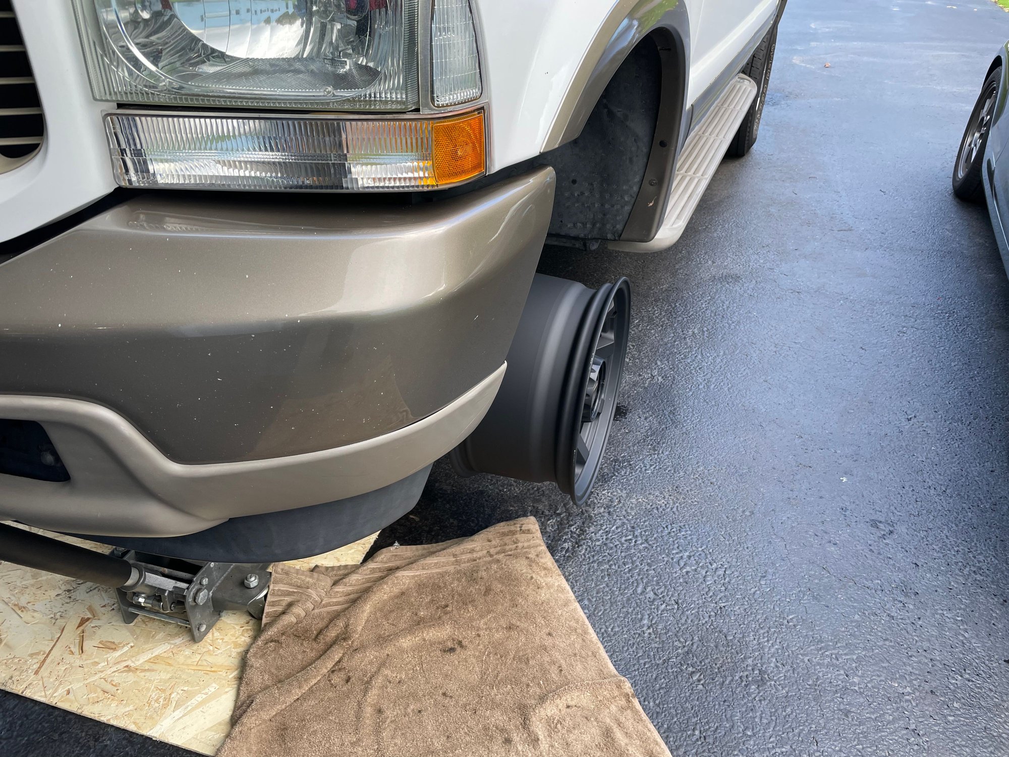

I did a test fit of just the wheel today before I get the tires mounted and I think it will work out. Worst case I guess I could do spacers though I’m really trying to avoid that.

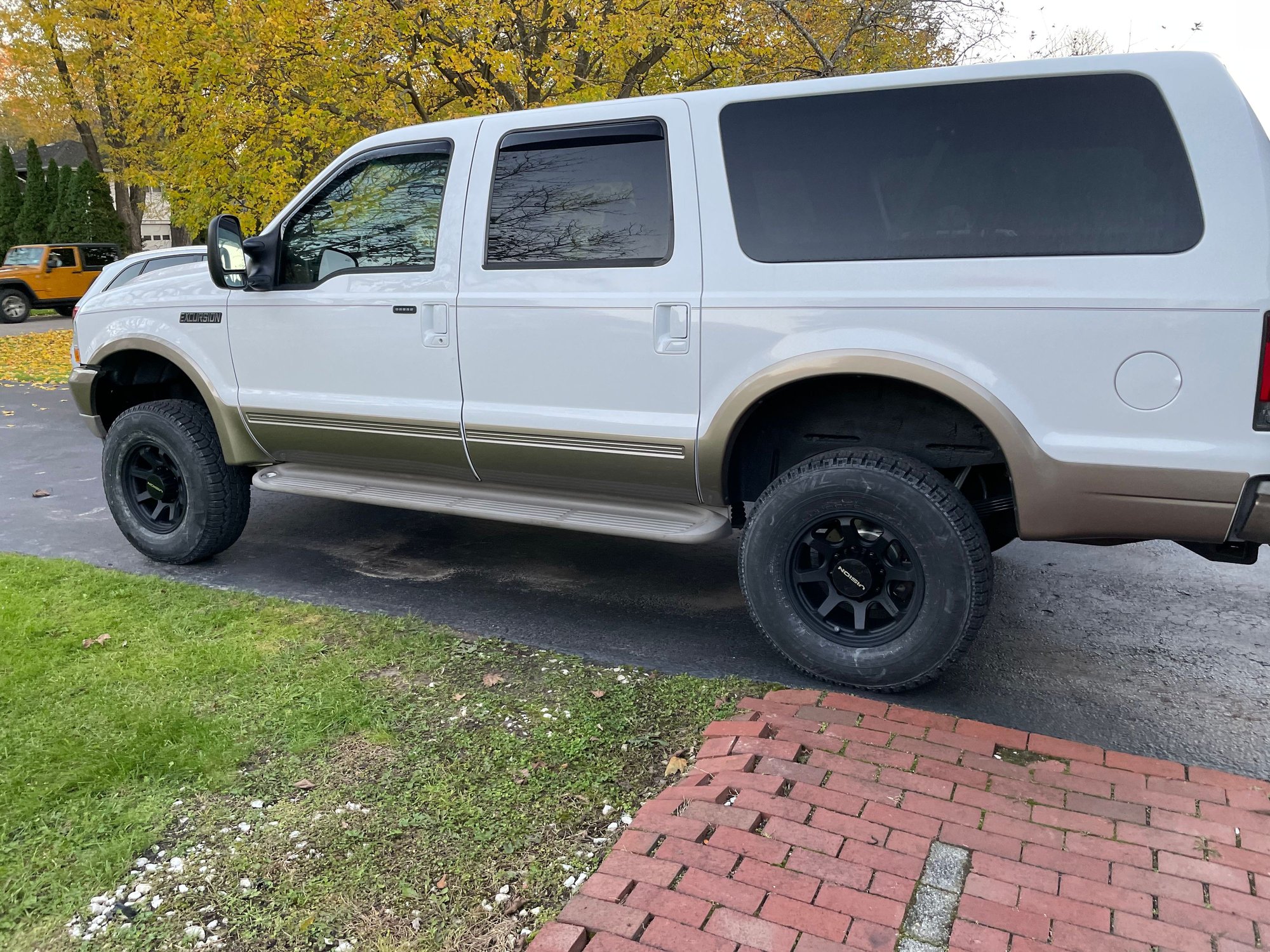

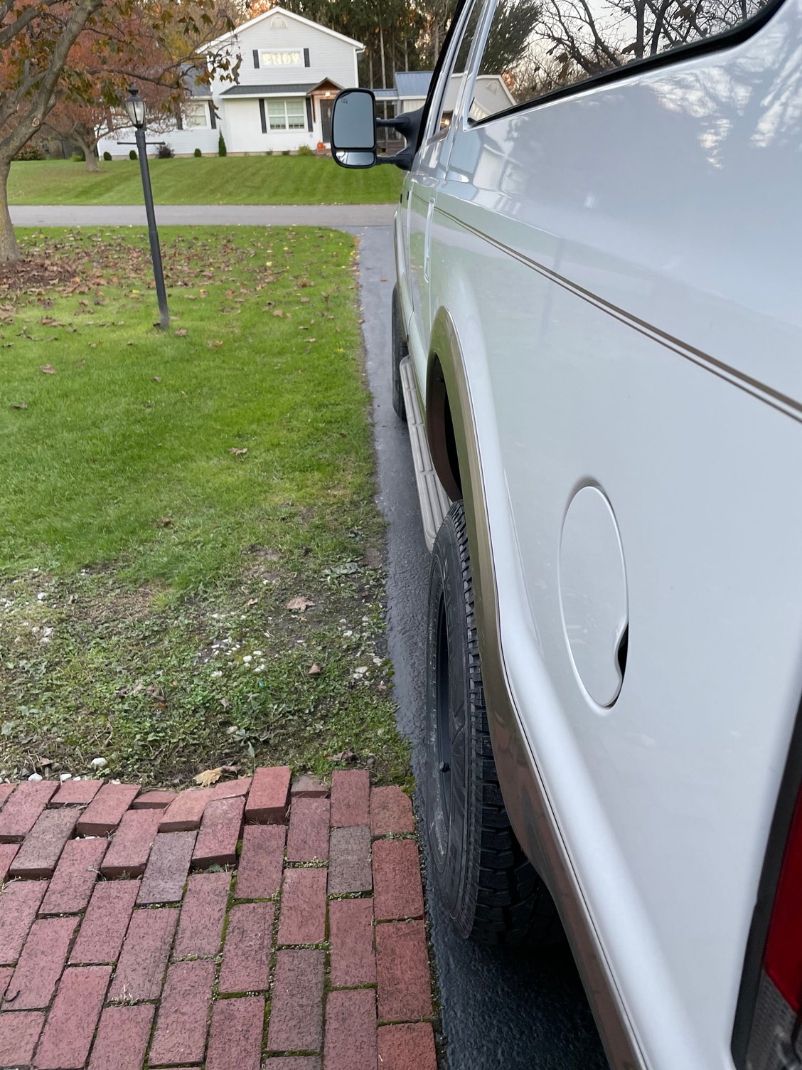

Got the tires mounted and balanced today. Went pretty smoothly and no issues so far.
