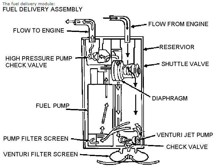

Anyone know where the fuel pump driver module is located on a 1994 f250 460 extended cab 5spd 4wd dual tank. I cant find anything some said it was above the spare but there isnt one.

The engine computer (ECM/PCM) controls the fuel pumps.

You have fuel delivery module, in each tank
