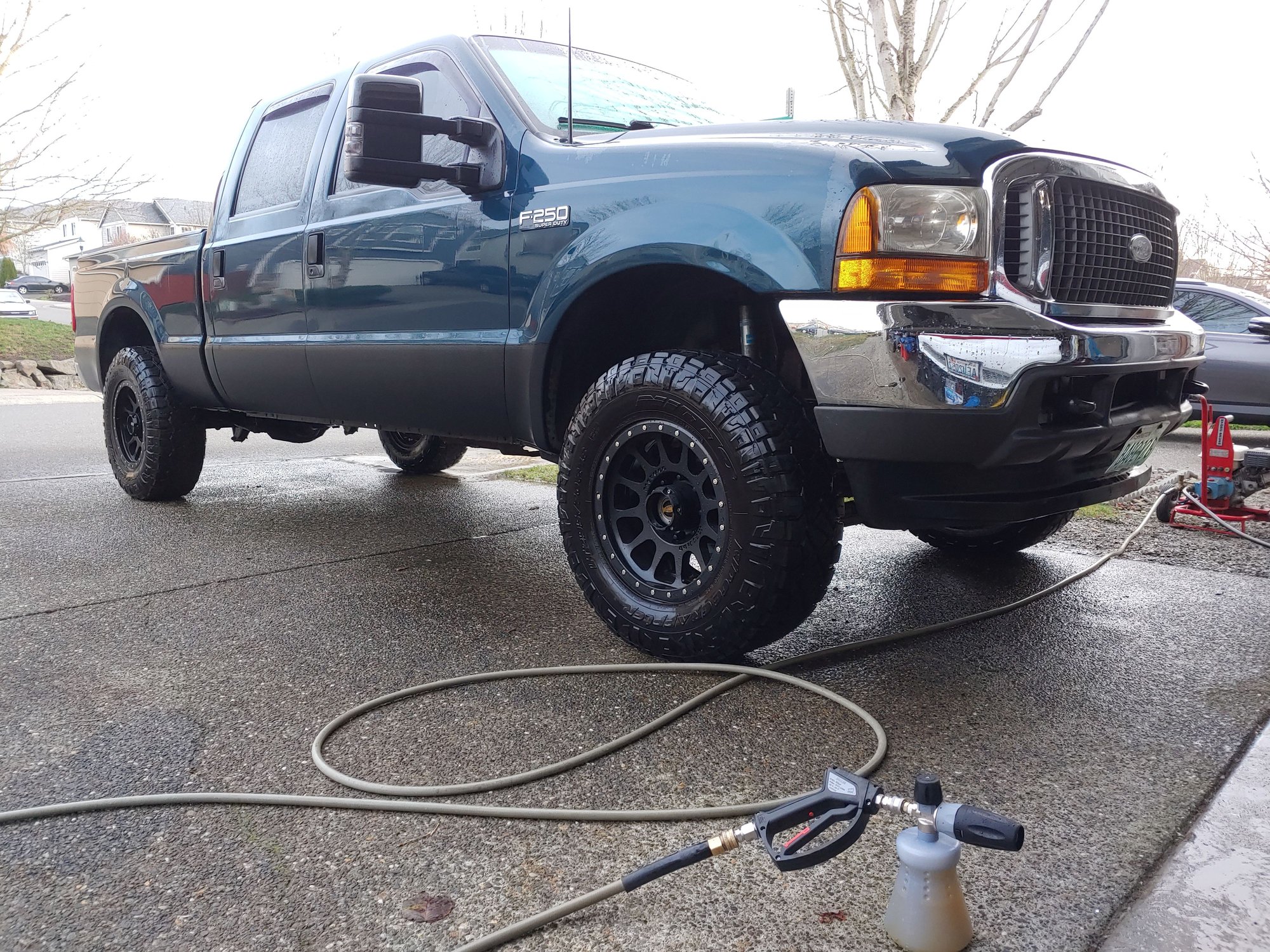

I have 295/70R18 E rated Nitto Ridge Grapplers. My truck has ATS X code springs up front to assist clearance. No rubbing.
Best mileage I've had with these tires was a road trip doing 75-80mph which had the rpms around 2-2200.
