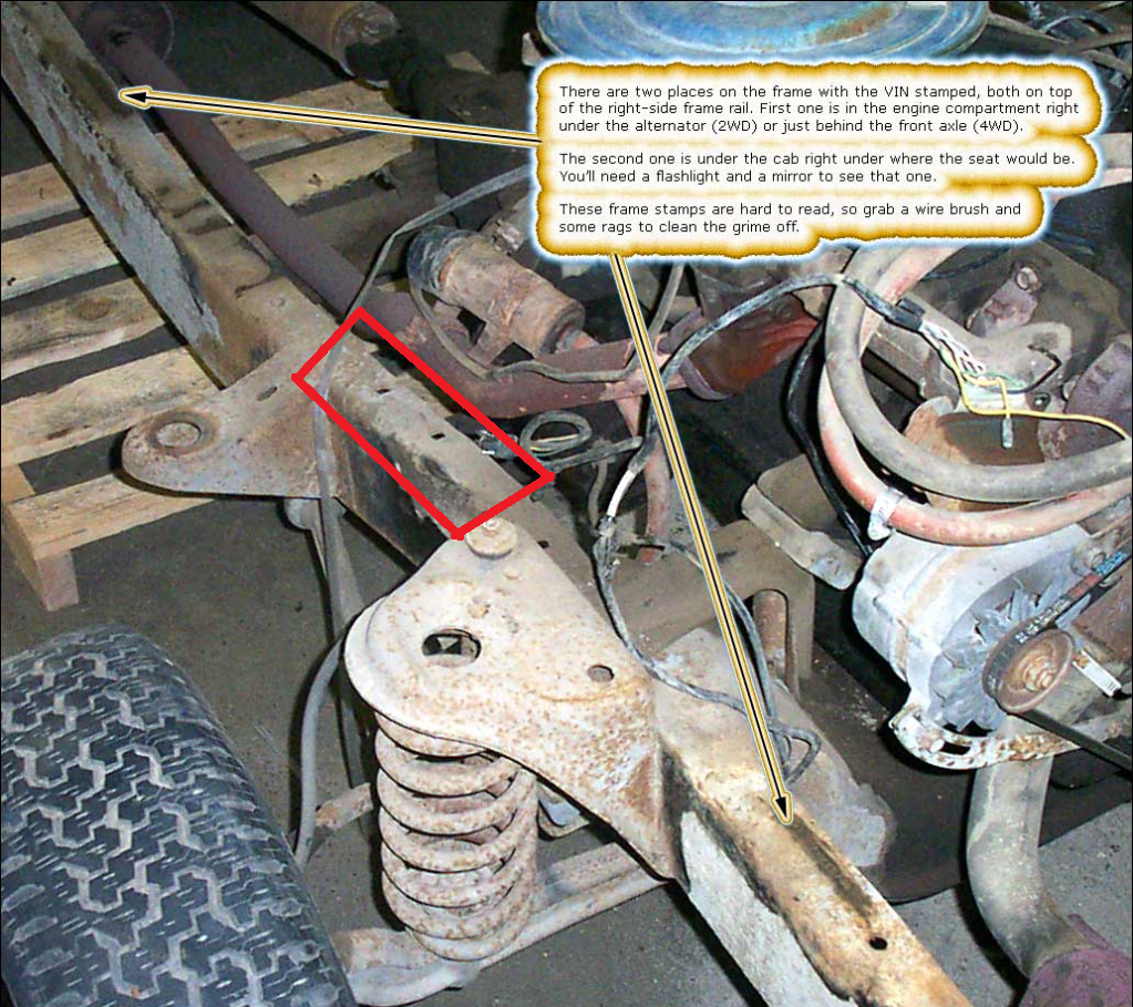

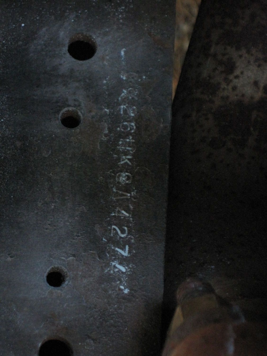

trying to identify what this frame is? i was expecting to find a vin # but this doesnt look like vin to me. pass side top of frame behind shock tower.

Where did you find that #? Red box is 4wd frame, 2nd pic is under the passenger set bracket fwd bolt. But still on top of the frame.

its in the red box area.

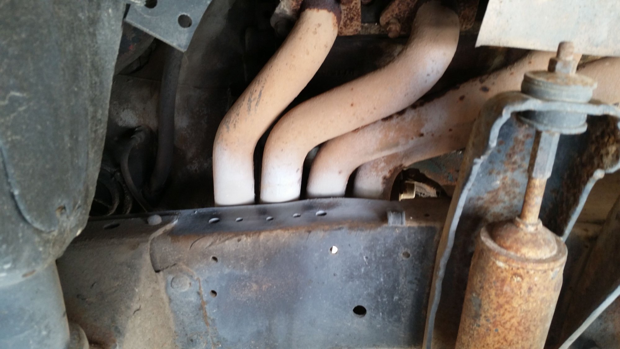

Should look like this then.
fresh primer area on a 1/2 ton 4wd.

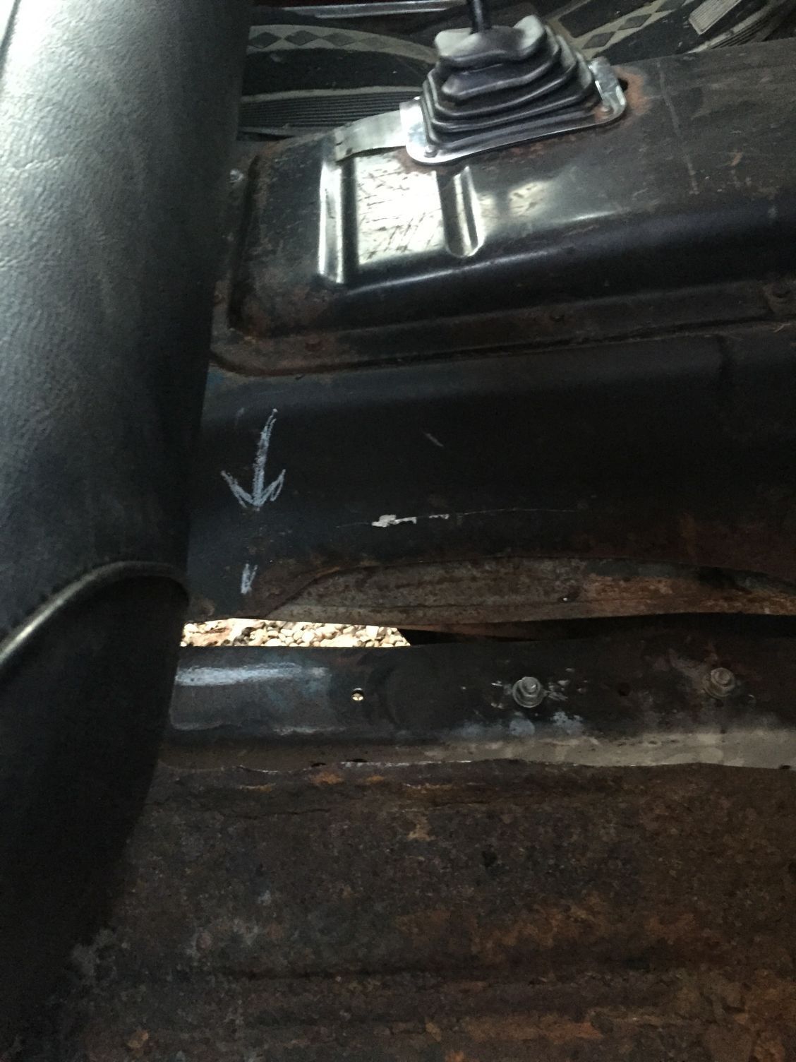

And the one under the seat (area) is the same 2wd or 4wd.

well i dont know. my stamp is in same area only on other side of the holes

Did you clean off the other side of the holes to see if there are numbers there or check the secondary location?

nothing toward front in line with alternater. i didnt check under seat. frame was sprayed with under coating so it a bummer to get off. im thinking this was a 2 wd frame . the front spring mounts are welded on and the gear box mounting looks to be fabricated. the guy i got this from started the project and never finished.title is for 77 highboy.

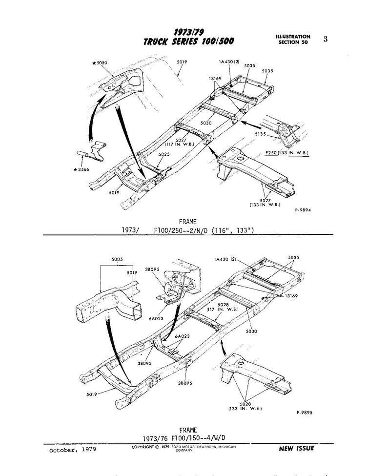

there is another crossmember under the bell hsg that my 78 doesnt have.

Well that number you posted is sure NOT the vin. And that cross member might be a 2wd frame cross member #5025?

yep 5025 is what its got.thank you. the previous owner did some fabrication looks like steering gear box is identical to my 78.front spring mounts have been welded. had 351/400 manifolds still attached to exhaust .so today ill try dropping the motor in place since.the tranny ,t case ,drive shafts are already in place.
