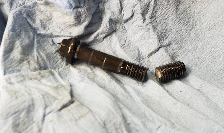

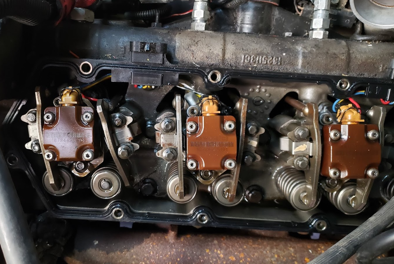

Been dragging my feet since October, but finally got back in the saddle and purchased a compression tester.
Popped off the first valve cover. Lo and behold.
Oops, broken rocker bolt.
Fortunately the nub was gracious enough to turn out with a pick.

Well that'll do it. U hope you didn't drive it a ton.

Nah it all happened in my yard. Everything except those 2 hold down bolts looked okay. Got some new ones on order from riffraff. Should be back together next weekend, then I'll re-assess how it's running. Also has a fuel leak somewhere, I think the back of the passenger side cylinder head.

Reinstalling the rocker solved the issue, runs smooth now. Took a look at that fuel line and it's located right under the down pipe, so ordering a replacement down pipe because I may as well change that while I'm in there, and I may as well change the turbo it's a little worse for the wear... and the injectors while the valve covers are off...
