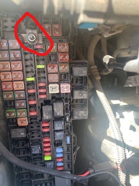

So after a full day of it sitting outside, and me continuously trying different things throughout the day and nothing working...I was poking around under the hood and popped the cover on the fuse box in the engine bay on drivers side.. the box felt a little loose and I noticed that this little nut which looks to be connected to a ground wire of some sort was almost completely backed off...I snugged that nut up, went into the truck and she fired up like normal...I dont know if that was the problem or if that was just a coincidence..I left for the weekend in a different car so I haven't had a chance to really drive it around...so we will see.

I'm on a solar forum that is all DIY. 50% of the voltage issues are due to bad connections. People mating copper lugs to aluminum terminals without cleaning the terminal and applying an anti-oxidation paste, not torqueing fasteners down properly, or just not making good crimps. It wouldn't surprise me at all if your loose nut was the issue.

Anybody know what that "ground wire" actually is? I can't find anything online on what its purpose is?

Almost looks like a power feed for that fuse box. Put test light on it and see if you get 12V on it.

So it has been about a month since I found that loose nut and snugged it down, have put about 700 miles on the truck since, and the issue seems to be gone.
