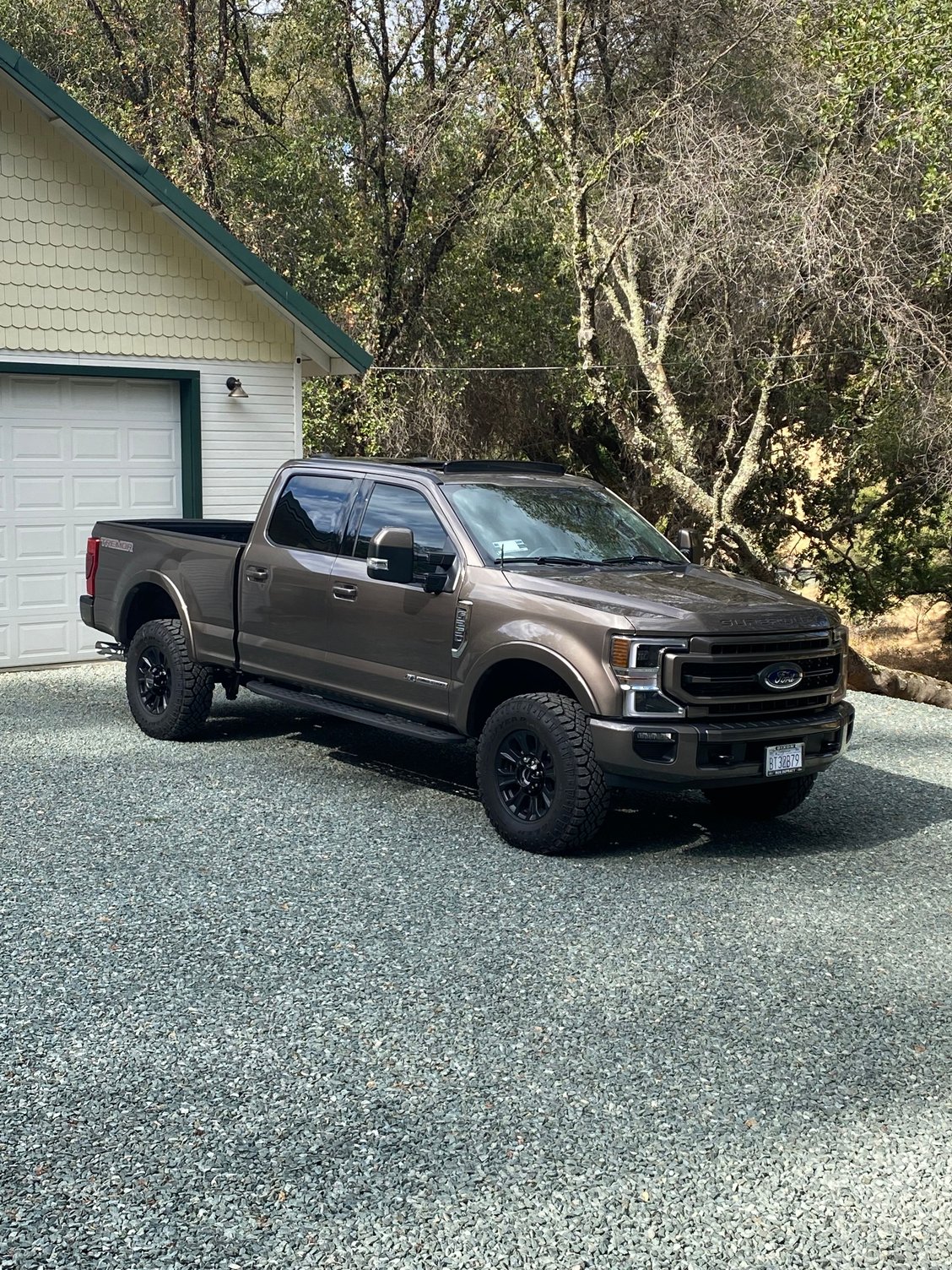

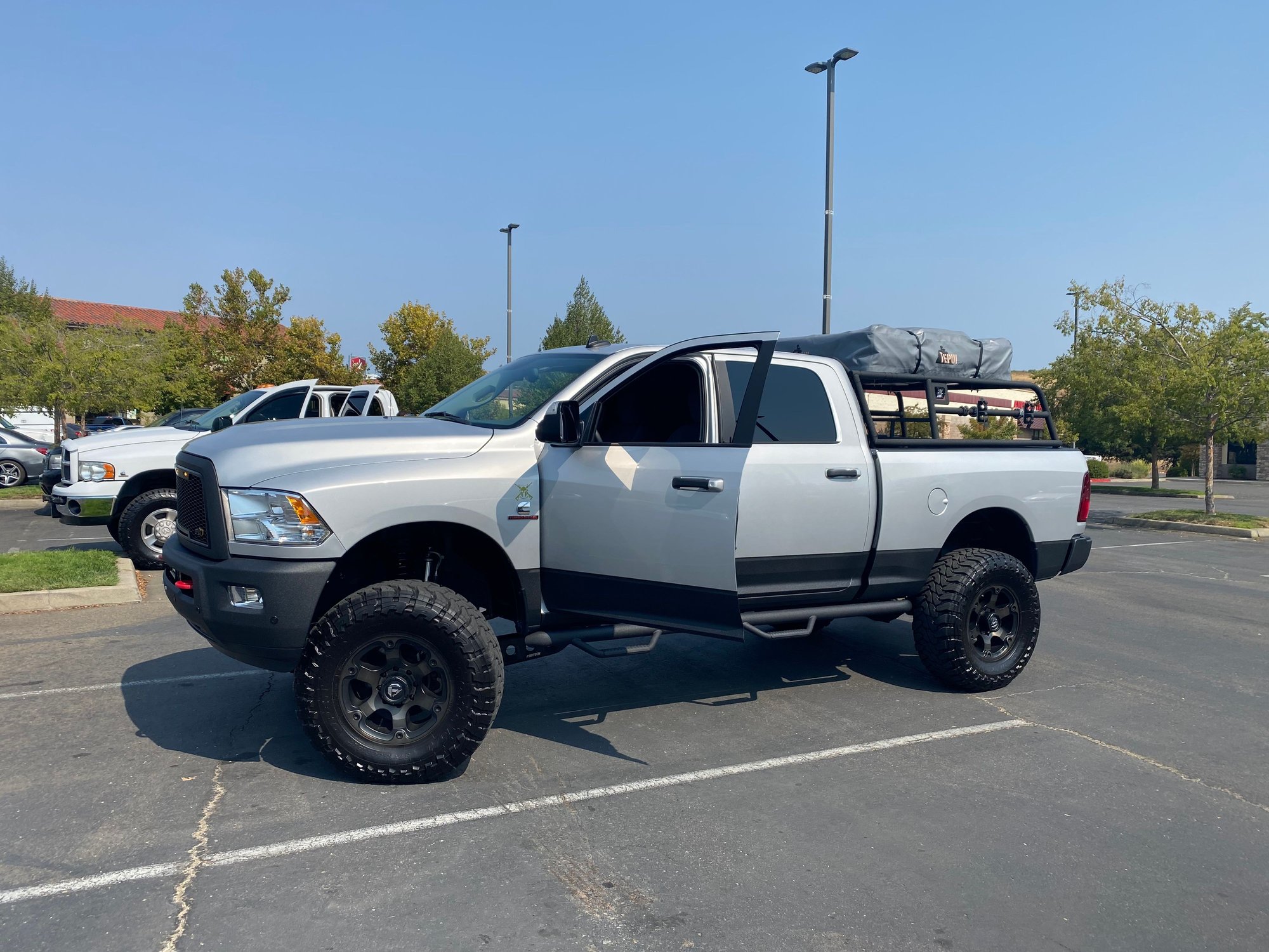

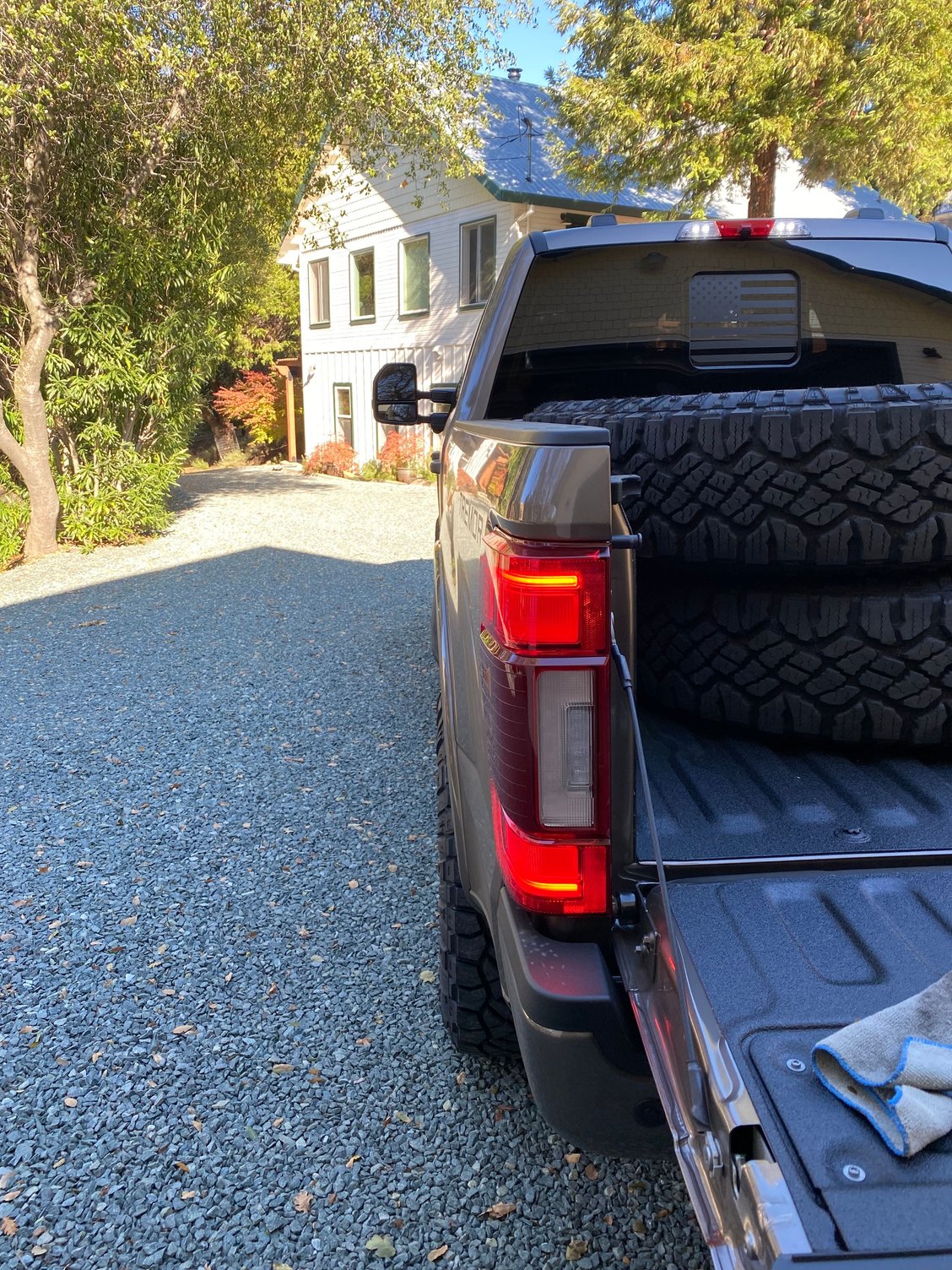

Recently sold my 2016 Ram 2500 and returned to Ford. 2022 Tremor just arrived. Anyone with pics of a newer F250 Tremor or FX4 with Carli 3.5” level and 37’s? Any other mods to a new F250…suspension, horsepower upgrades, tactical interior etc?

The kit would look the same on any srw super duty with the same engine as you have. Definitely fits 37s.
Nice color combo!

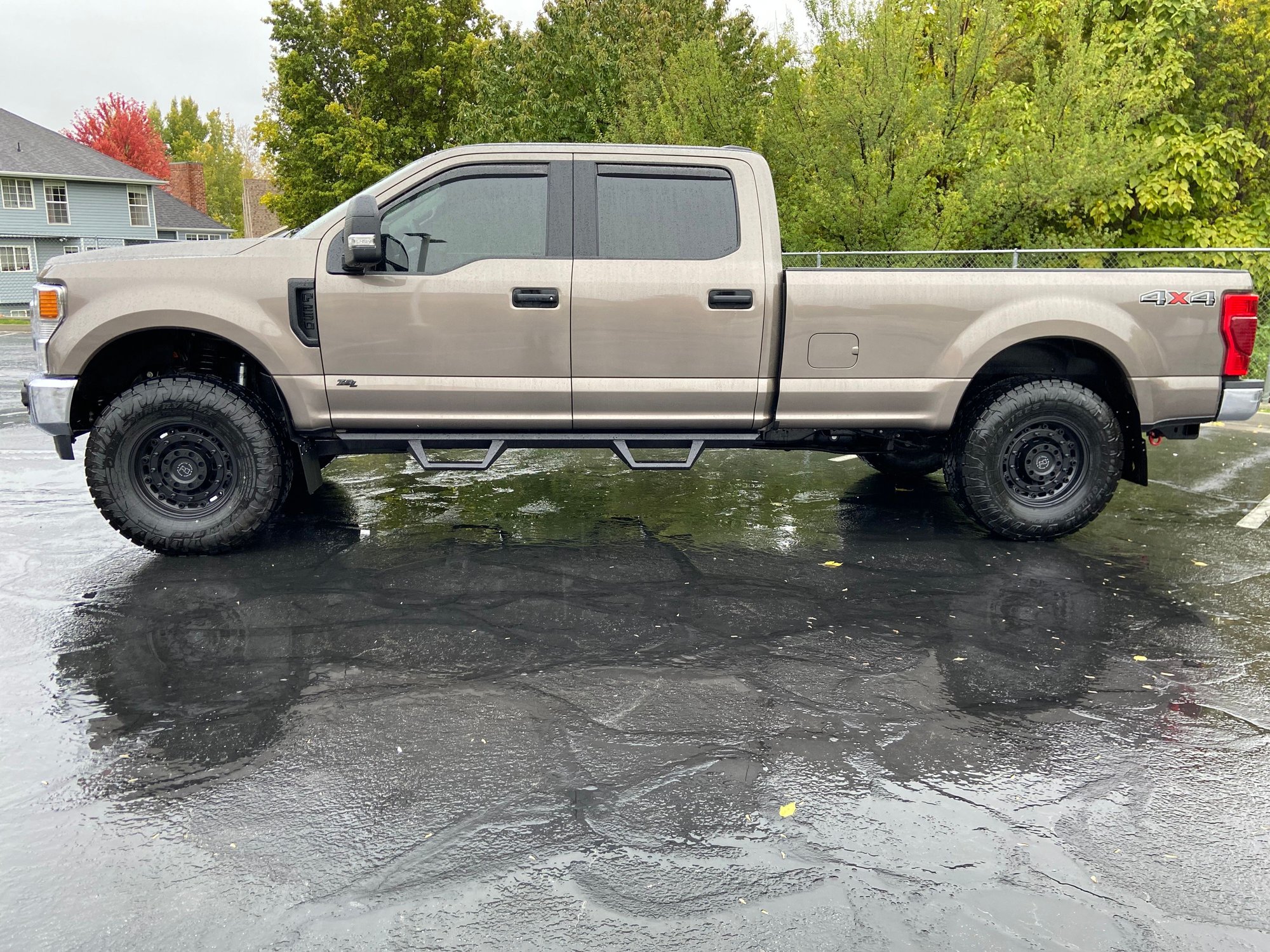

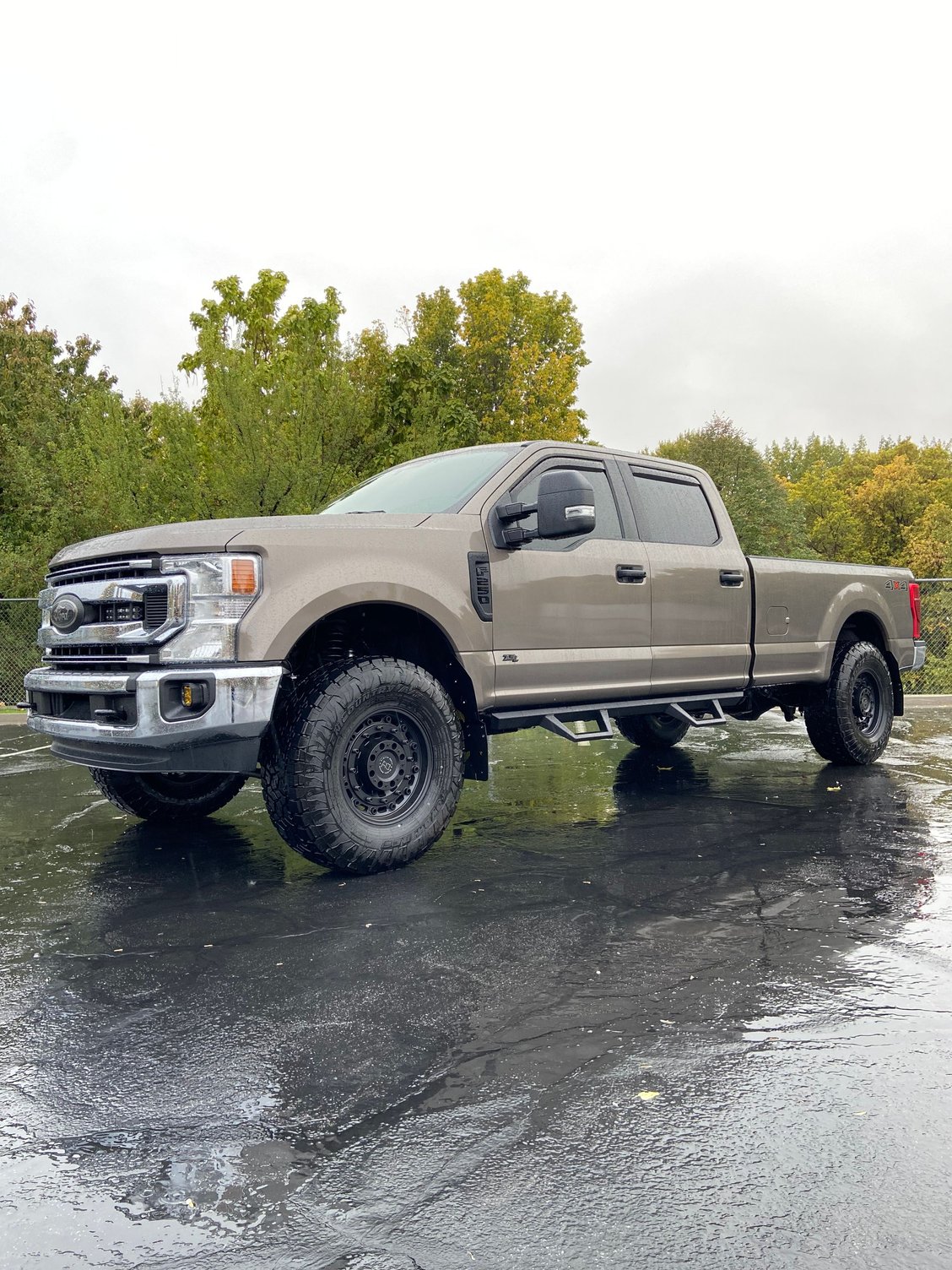

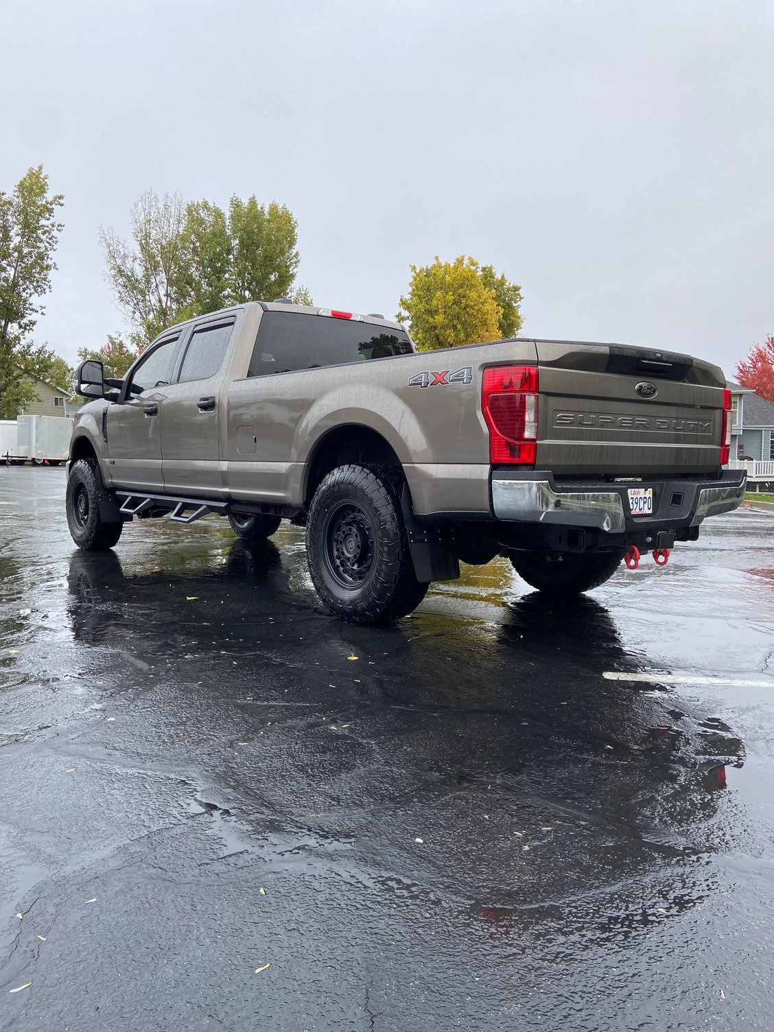

22’ with a 3” Carli leveling kit on 37s. No trimming. Mine is a 7.3 gas so the height is a little different then the 6.7 kits. And you’ll have all 4 lift options with the shocks. Mine was Carli or King shocks, no Fox kits for the gas trucks yet.

Stock rear blocks? The tremor has the earlier/taller blocks.

Yes, stock rear blocks.

Nice looking truck, can’t tell if that’s the same color as mine. Was there much noticeable power loss going to the 37’s? Any down sides so far with the Carli system, anything you’d add suspension-wise?

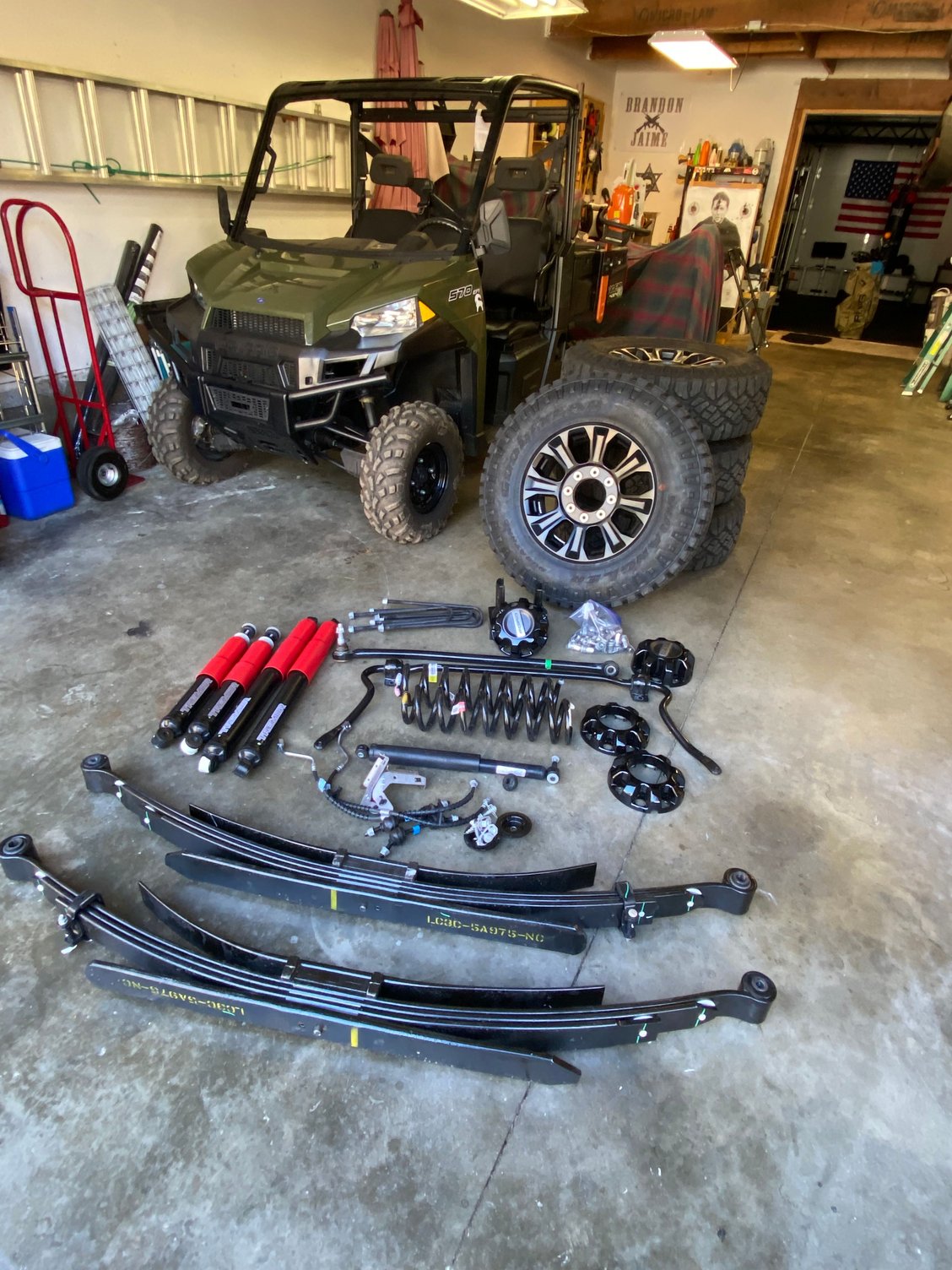

I have an appointment next week to have the 3.5” installed. Full leaf pack in back, Fox 2.0’s, Carli torsion bar, upper stabilizer, new coils. 18” Raceline Gauge wheels. 37x12.5 Nitto Ridge Grapplers. Did not opt for the arduous arms….yet.

Mine is stone grey. Probably just lighting that makes it look lighter then yours. I didn’t notice any power loss with the 37s. You especially shouldn’t with that 6.7. I added the track bar and upper steering stabilizer in my kit. I’m going to add the sway bar with end links later. I would do that before the radius arms for sure. If you were going 4.5”+, the radius arms would benefit you for sure to correct the caster. The caster shims that will come with your kit are perfect for the 3.5” lift. The ride is 10x better with the Carli kit over stock. I run my tires at 55psi. With you adding the full rear leaf springs, that truck will ride amazing.

Nice looking truck. What's the total on that? I had a 4" BDS, with all the upgrades, Fox shocks, wheel and tires for $7500 including labor.

I’m throwing everything Carli has at it minus the radius arms in the hopes that it will be kind of a do it all truck. Total came out to about 10k but those are California prices during Covid so…..enough said 🙄

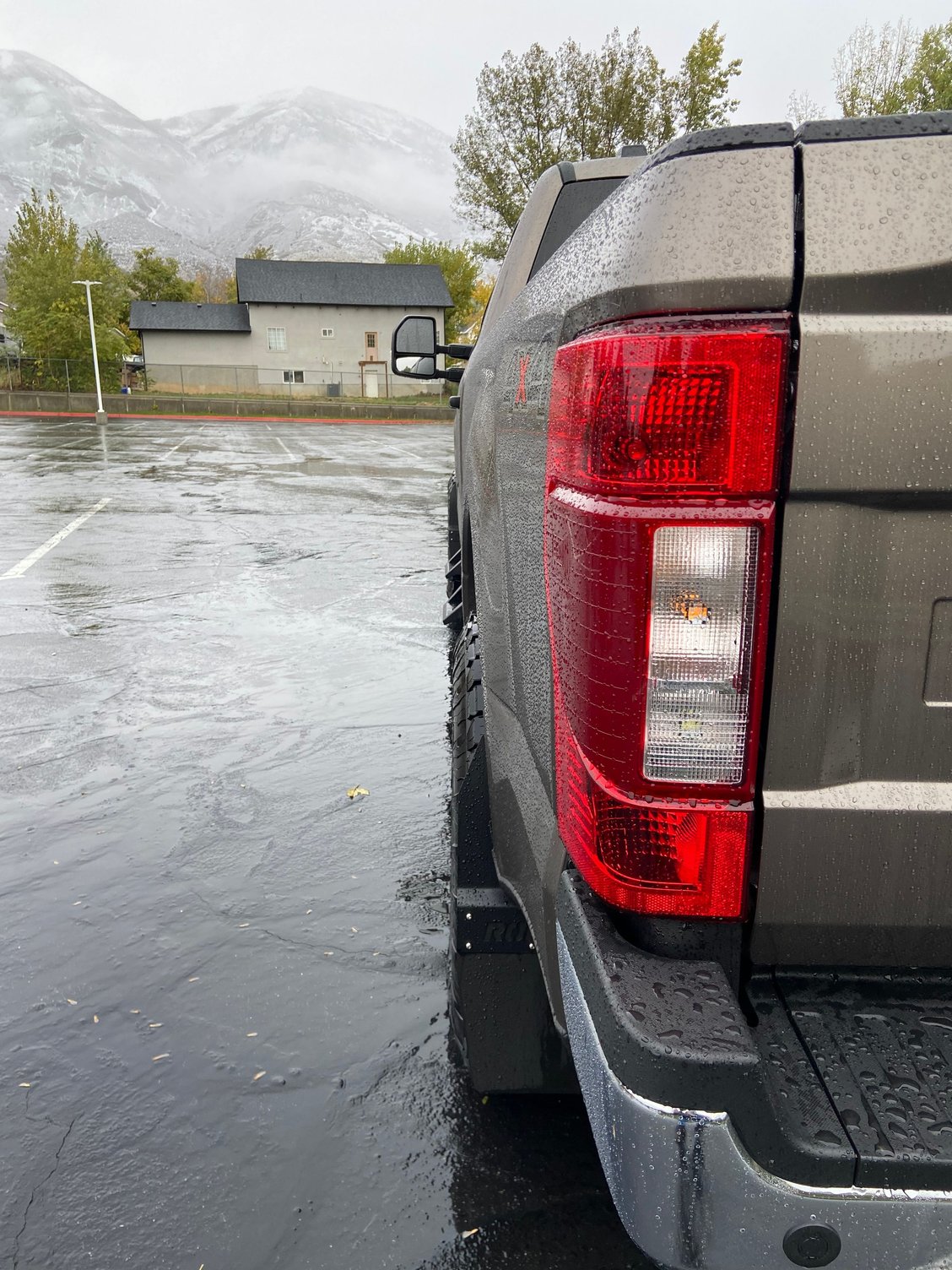

+18 will be perfect man. Mine are +12. Here’s a profile pic. I have Rok Blokz mud flaps and they cover the offset perfect.

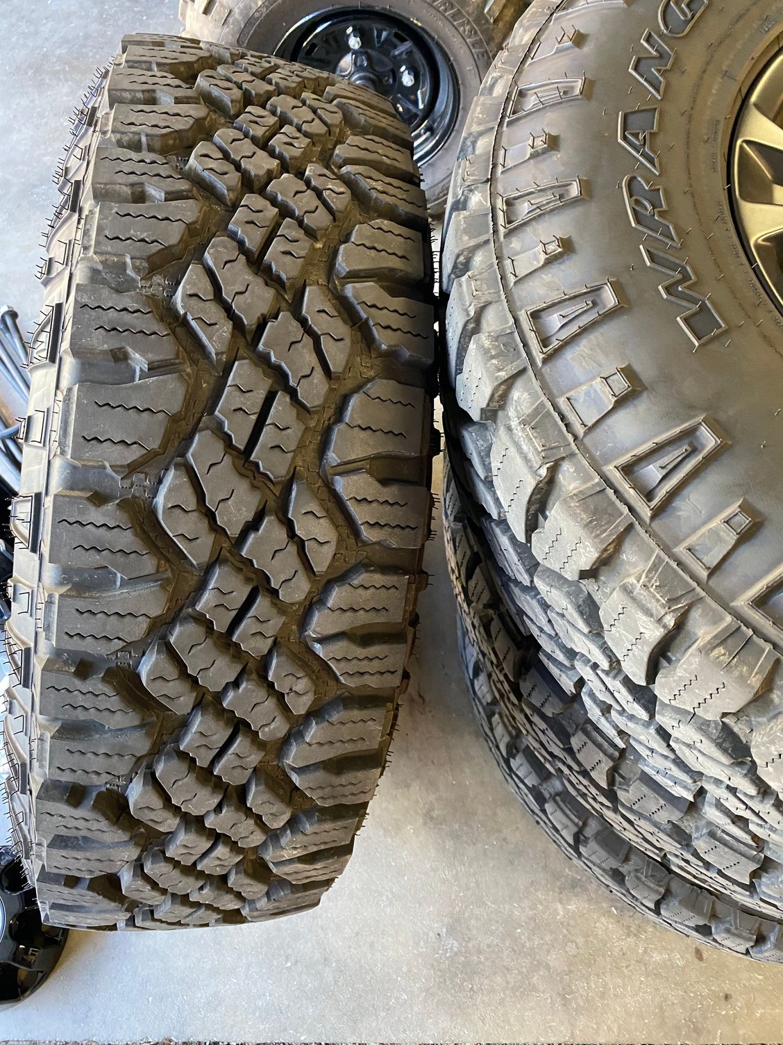

Those are cool, I’m hoping the ridge grapplers dot throw rocks as much at my old Toyos did or the stock wranglers do.

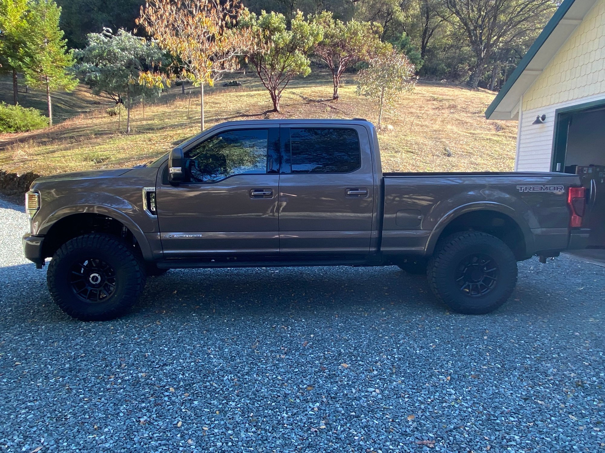

Finally done
Originally Posted by Mainebucks
I heard the Carli lifts were expensive, but they are quality, should be a great system for you. Looking forward to seeing the finished truck!

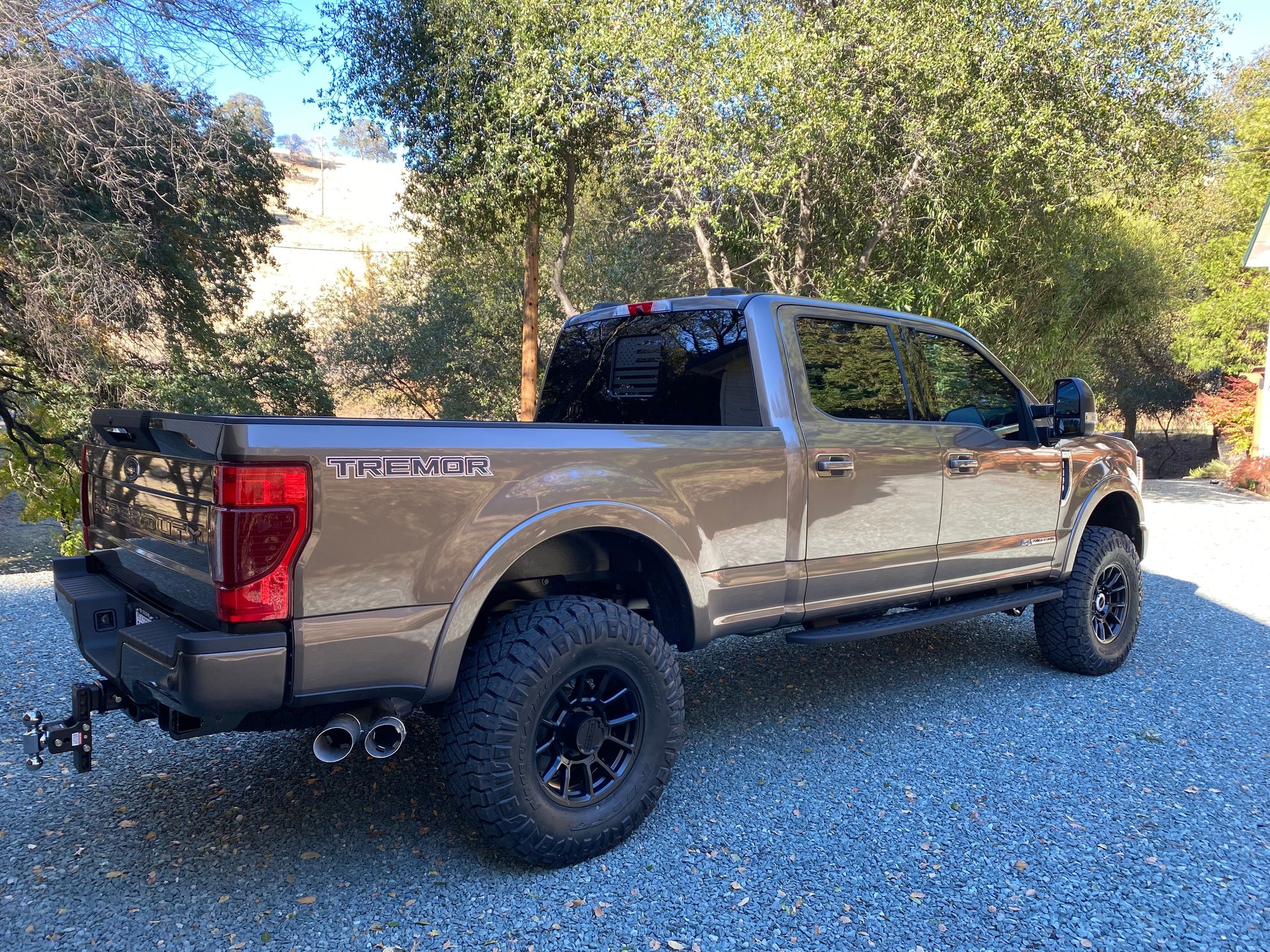

Got my truck back today, rides perfect! No tubing and almost completely inside the fender wells. Barely noticed train tracks or the potholes of my country roads. Great product so far.

It turned out awesome man! It’s hard to beat a Carli kit. Can you throw a pic up of the sway bar?
