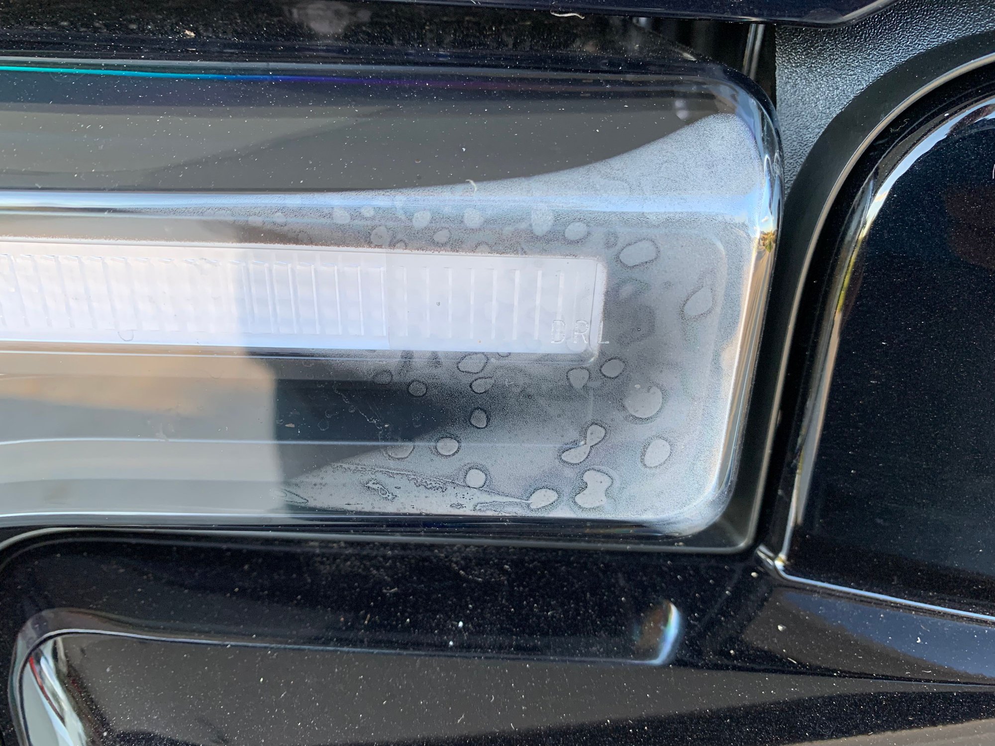

New 2022. Hosed the truck off today to get the dust off. Truck was sitting in the sun.
Just curious if this is prevalent on these new trucks.
It’s going to go back to the dealership.
The only other time I’ve seen this happen is on my cheap Amazon light bars for my sxs.
thanks,
Jerry

My halogen headlights also had a fog in them when I first picked the truck up. This went away after the first day and hasn't returned. I'm sure it was from the detailer washing the truck, but I've never had it happen when I wash it. I have not pulled the lights out or researched at all, but I'm guessing they are not totally "sealed" but have a vent somewhere to equalize humidity or let moisture evaporate out.

This is normal. Seems I even read this in the owners manual.

Condensation caused by exterior temperature. Your light isn't leaking.

Right, but not for access other than changing the bulb-, but just for ventilation. The housings will have a small tube or casting that opens to atmosphere. Any housing where the inside reaches the dew point will have that fogging. The only ones that don't have a vent are the ones from decades ago where they would build up water in the housing. Vacuum-tight housings are rare that I know of since at zero pressure, the stress on the housing is quite substantial and would require a more robust housing that would cost more and weigh more. The old sealed beams could do this since they were made of glass and were not intended to last for the useable life of the vehicle. You would generally replace those bulbs from rock chips and filament burnout every two or three years. By just venting the housing, you take care of the water buildup problem. Again, under the right atmospheric conditions, all housings will get some moisture collection. But it will evaporate.

If the truck were sitting in the sun before you washed it, the LED housings would have been hot/warm. Once the water hit them, the warm air inside would have contracted, creating a vacuum, pulling in cooler, water laden air through the vents. Works just like this:
https://www.scienceworld.ca/resource/egg-bottle/
Except the egg stays in the bottle and the moisture in your lights will go away in a few days. By design. Don't run off to the dealer just yet.

Just give it a few hours.
All should be back to normal afterwards.

Thanks to all that replied.
You guys were correct, it did go away. It’s just not something that I was used to seeing.
