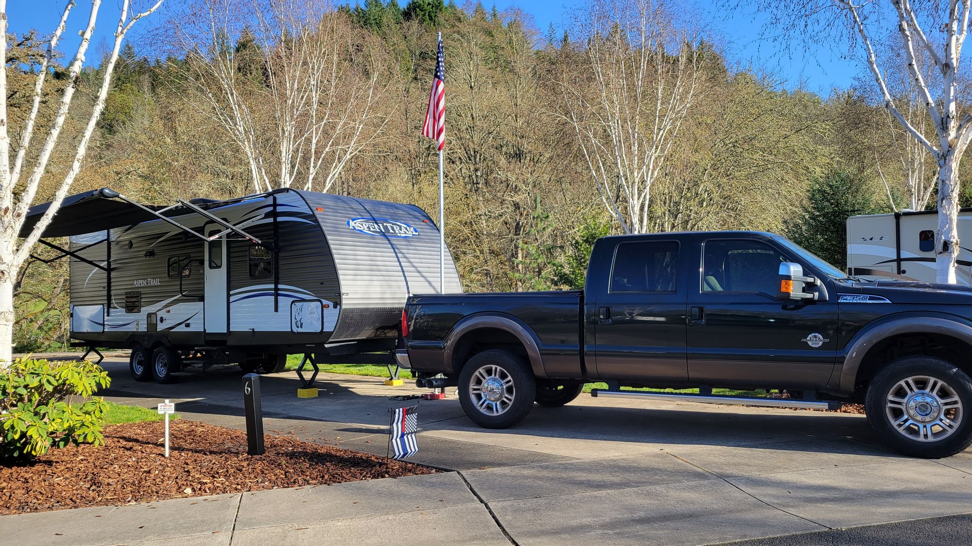

I have a 2015 F350 Crew cab short box 6.7L on factory 20s I use my truck as my daily driver and I tow a 8k travel trailer on about 7 to 9 trips a year im coming up due for new tires and can't decide between keeping with the factory size 20s and no level so I can keep my ease of towing and run my preferred brand of tires wich is coopers either in a AT3 XLT or a Cooper Rugged Trek, my other though is to bump up to a 295/65R20 and a leveling kit that has a sway bar recollection bracket but by doing this I would have to ditch the Coopers and go with Toyo AT3s or BFG KO2s since the a/t coopers don't come in a 295/65R20 but on the other hand it would give me an excuse to level the truck to give it a nice stance with the 35s but then I worrie about the squat I will get when I tow unless I fork out even more money for air bags or a bigger rear block since I don't wanna squat when I tow (I do use a weight distribution hitch on my travel trailer) I don't off road so don't need mud tires but like the look of a leveled truck alot more then the raked look I'm just scared that I'll have a bad squat towing and I'm also scared to jump ship from cooper tires that I've had on my f150 and 6.0 and that came on my current truck any advice would be appreciated thanks

Not sure how many miles your trucks sees a year, but I vote for no leveling. Would add Timbrens instead of bags, saves a few bucks. Nice pic.

If the trailer isn’t hooked up in that pic, research what front spring you have because it looks pretty high in the front already.
Quite frankly I would suggest a 285/65/20 and put your money into higher end performance shocks. Maybe consider one of the taller 295/60/20 tires available (I think the cooper at3 is one).
I wouldn’t lift much over what the factory snowplow prep springs lifted the front. You dont need to to and should be able to fit a 295/65/20 at that height.

Here is a better side picture of how she sits unloaded
