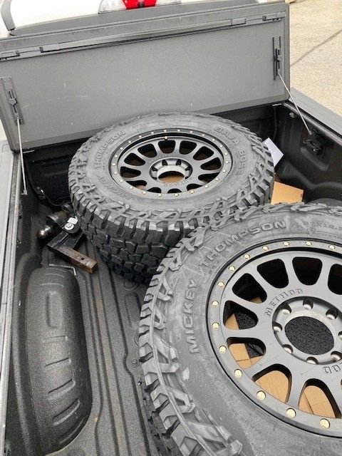

Hello
I am newer to having my f250 and live in wisconsin. I just ordered some Method wheels that have a centercap that inserts from the back of the wheel. I know they use a vacuum system on the 4 wheel system, but am i in troubl if I cover the lockers? I obviously don't want to have them in locked position all of the time.
Thanks
