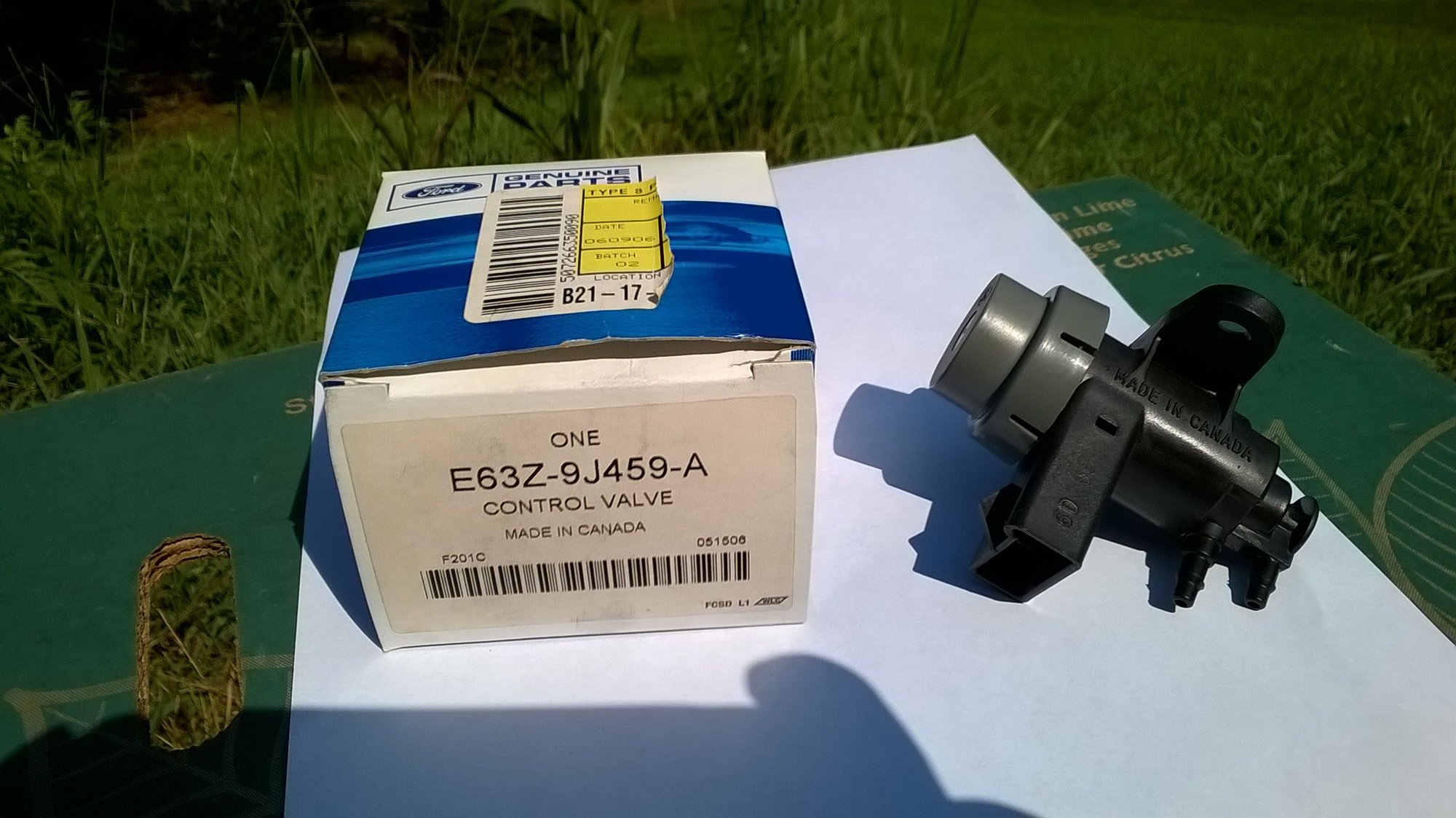

Below is the EGR valve. When I searched for the TAB/TAD, they seem to be sold as a pair according to the parts sites I have looked at. But one of those sensors did fix my issue.. Right after I bought the van I had the throttle body off and changed the EGR valve, TPS, FPR, and MAP sensor at that time I still have the O2 sensor, TPS, and ECM on hand to change out. Yes TPS again as i have a slight surging with the throttle held at a very low speed.. And yes I changed out the MAP sensor a second time. First time was a NAPA brand and this last time was a Ford brand..

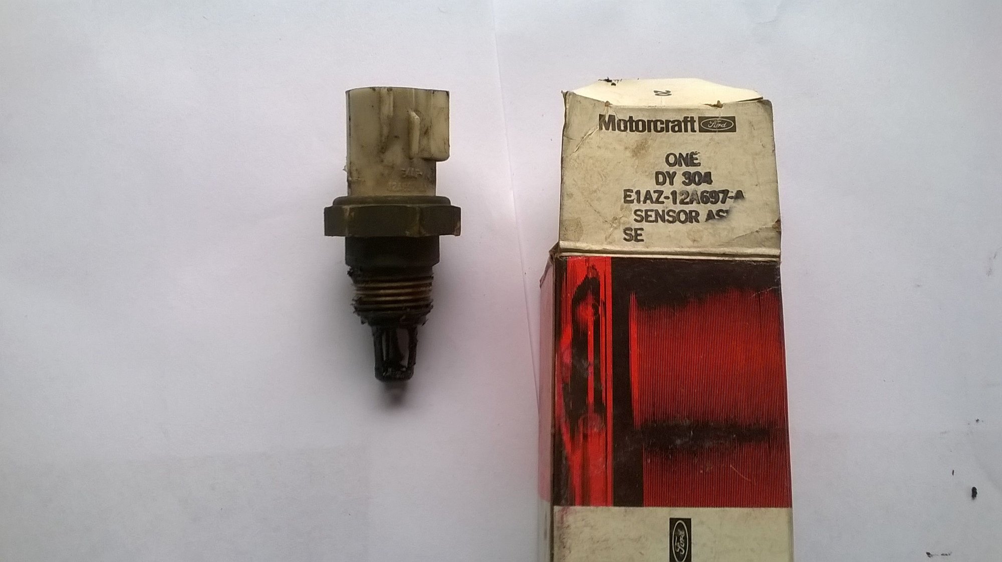

You can test the ACT with an ohm meter. It will read certain ohms at certain temps. Do a search on ACT or ECT + ohms and look at pics. You will probably find a lot of scales showing the resistance at different temperatures. The ACT and ECT use the same scale. I would post one for you but don't have a pic saved.
Here is the one i bought for my van. there may be an updated part number but this is the one I bought.. Your old one may still be good.. That's my old one in the pic.

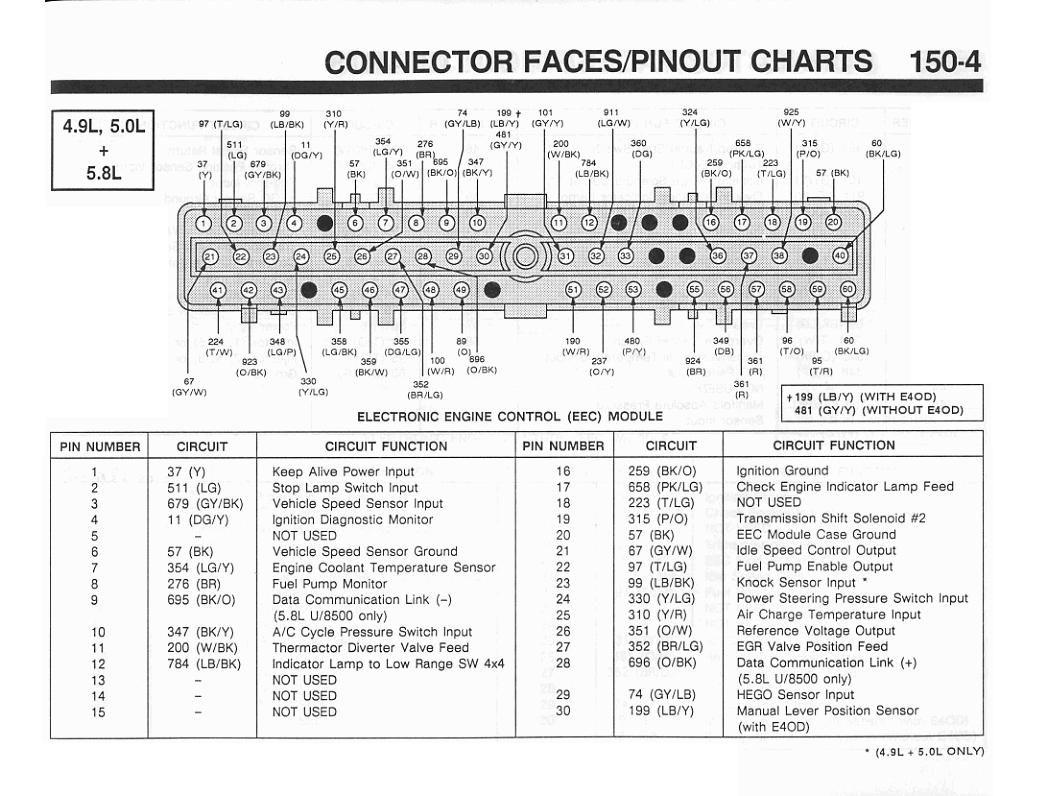

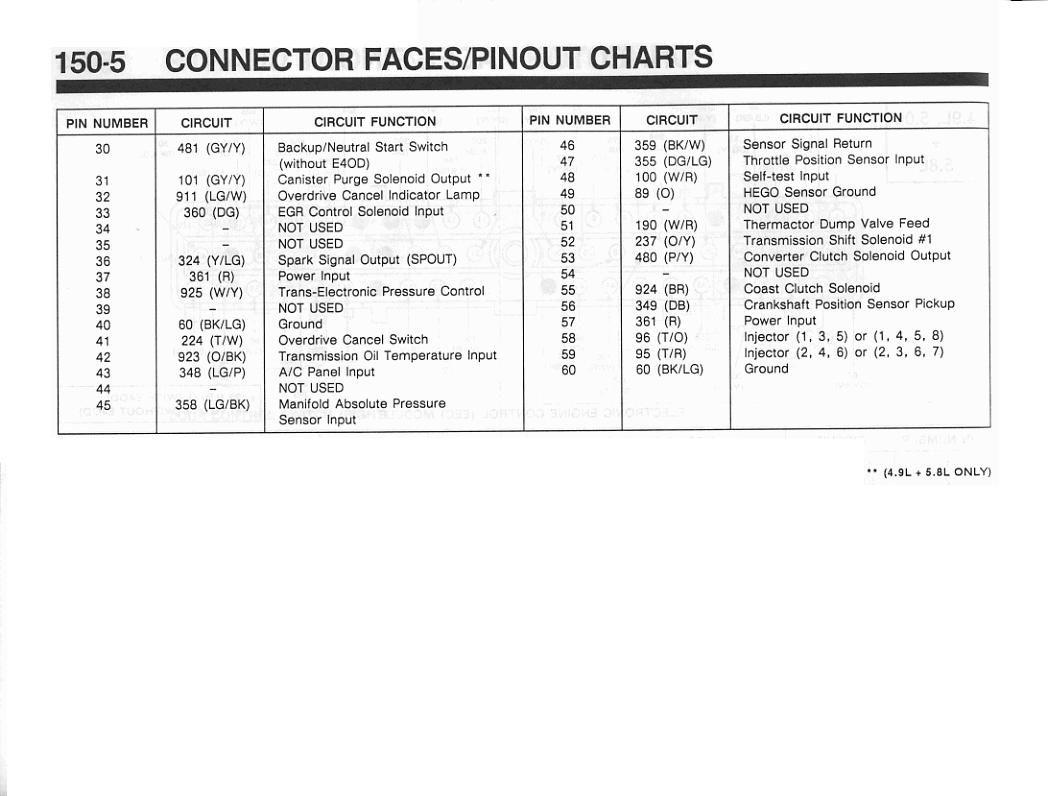

I have a pin out chart of the PCM/ECM but not sure if the wire colors would be the same on your 89 It came from the emissions section of a manual I came across so may just be a generic diagram for the OBDl
It shows pin 25, circuit 310, Y/R wire being the ACT input.. Maybe your old sensor is bad or the connector is loose...
