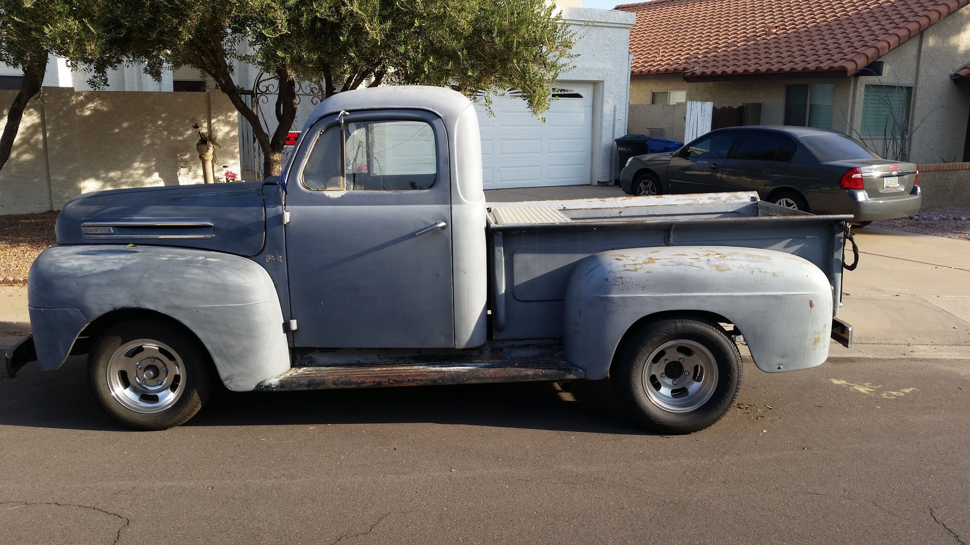

I have some question to ask before I can answer... what engine, transmission and rear gears are you planning on running? are you wanting to use the truck, DD, hi-way driving, trailer queen?
I'm running Cooper Cobra Radial GT 225/70R15 on 15x7 wheels up front and Cooper Cobra Radial GT 275/60R15 on 15x8-1/2 on the rear

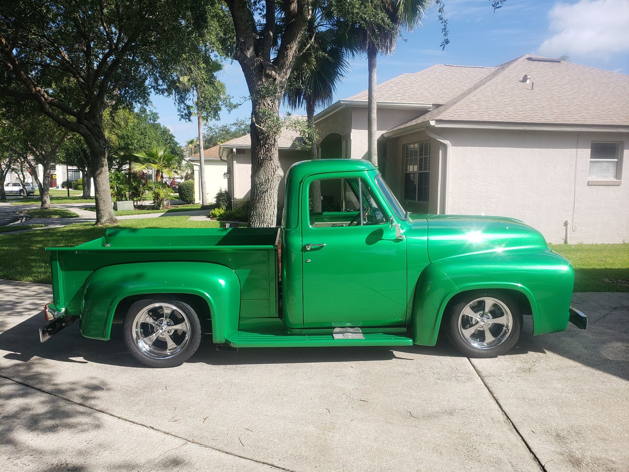

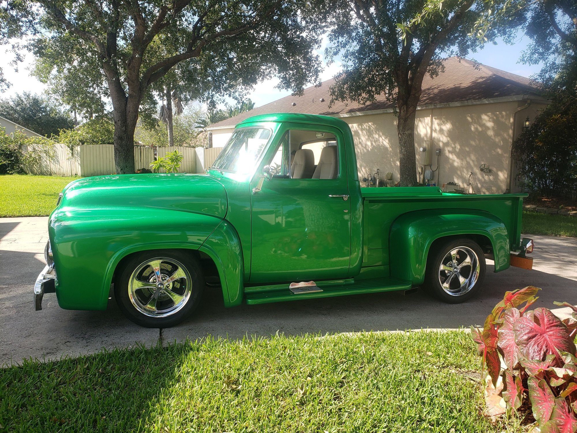

I run the exact same tire that you are looking at up front and in the rear (Nitto 555 G2)
255 / 50 / 17 and 295 / 40 /18
that a huge rear tire..looks good. tire have been on back order for a while. they said in the new year they would have them again
