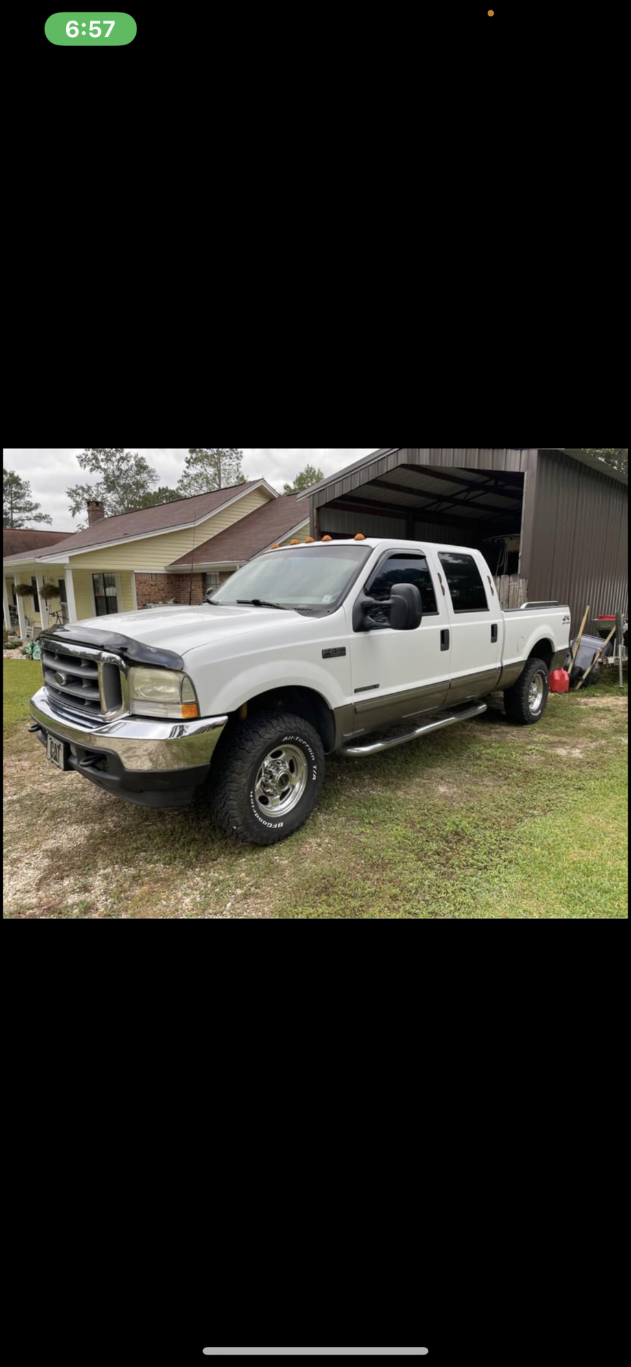

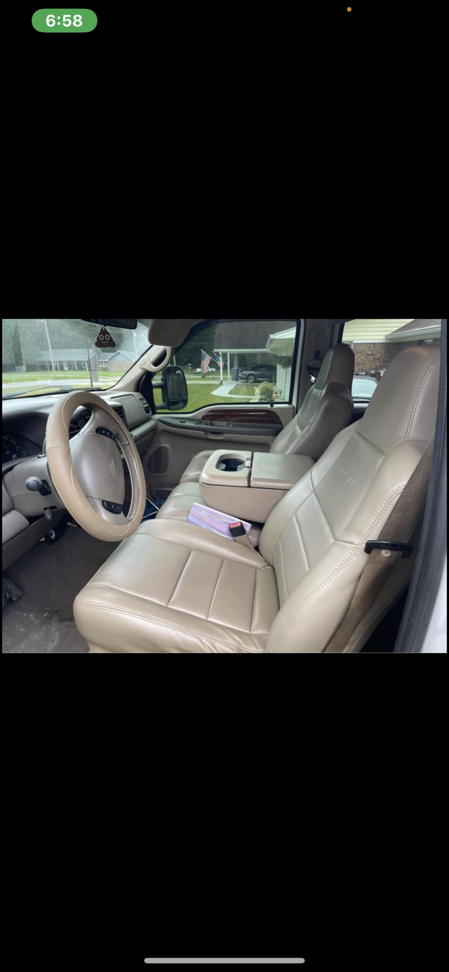

Got another one Im looking at guys. 2002 with 240,000 on the odometer. Bone stock truck down to the correct tire size. Was maintained most of its life at the Ford dealership. Lariat with leather in good condition. The least he will go is 16k. Any thoughts?

imo.the leather looks good because it is not original to the truck. I have after market custom made leather seat covers and they do not look that good. you said this has 240,000, I have 210,000. Note the steering wheel cover, take that off and see the original wear. Still, for the market, may not be a bad buy. I would not sell my 2001 for 16,000

Biggest thing to me is where is it at mechanically at this age and miles?
Coolant fresh? Ever had a water pump, Oil cooler leaking? Glowplugs. All the orings in the HPO and Fuel system in the engine valley/fuel bowl.
Belt, Tensioners, fan clutch, Batteries & starter
Then drivetrain, ever had ujoints, front axle ujoints, balljoints, unit bearings & seals? TRE's, Draglink and Panhard, swaybar bushings and brakes? How does the steering box feel?
All that stuff doesn't really add value to a truck, but it needing to be done soon sure costs alot of $ so its worth it to find out the condition of all those items and or see documentation showing they have been done.

As to the leather, we'd need more pictures.
