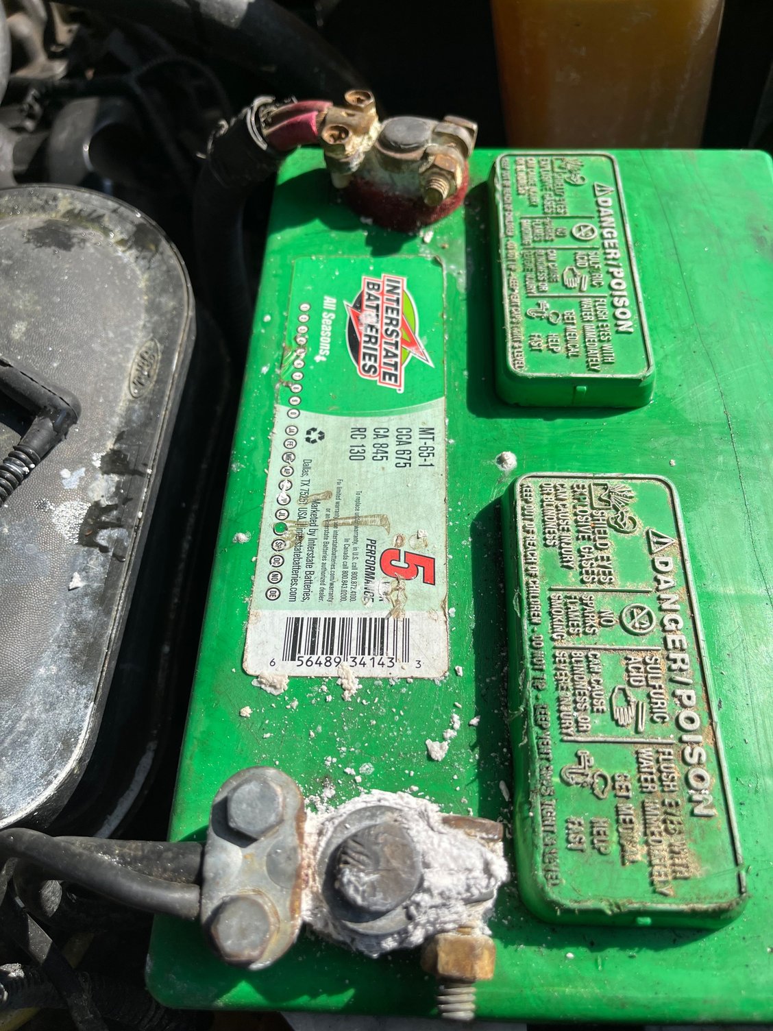

Ever since I’ve owned this truck, I’ve had to deal with corrosion around the terminals, one is actually kind of loose so I was going to put some epoxy around it and try and keep any gas from being expelled…the truck also runs smoother when I unhook the fuse link from the alternator, but the battery light immediately comes on….so I’ve decided to replace my terminal connections and clean them up as well as my starter solenoid and alternator to try and fix this problem, because I think the rough idle is actually due to the electrical system…the alternator I got has a b+ terminal and the one in my truck doesn’t….I’ve got a yellow wire that looks like a boot on the end connected to the alternator and it runs straight to the starter solenoid…I’m not sure if I’m competent enough to start rewriting things and make matters worse, but my lights on the interior have started flickering and like I said I’ve got this rough idle and at low rpms and high speeds I get shaking…if I can eliminate this problem this truck would be perfect…included some pics…

I would start by saying those lugs need to go. You likely have corrosion in the cables as well so get a full replacement set of cables. You can do a google search for good 1/0 or 2/0 cables. You did not say what truck you have but with one battery I would say a gasser. 2/0 may be overkill.
Clean the battery with soap and water... Lots of water. Get a battery post brush and use that as well. Get some of the felt battery washers and put those on the battery before putting the new cables on. Use electric grease on the posts and terminals. (Dielectric Grease in not conductive) do not use that junk or the red spray stuff.
That battery may be toast as well if it is more than a few years old I would consider replacement. If not replace it put it on a charger while it is out and doing the other work to the truck.
I stress NEW CABLES.. You will likely never get those cleaned up enough to not have issues.
Do not use any epoxy on the battery you are inviting a serious problem if the battery can not off gas. Have you heard of the Hindenburg????
Clean the battery every month with soap and water, once it is clean you can do it in the truck.
Also the battery when resting should read 12.7 when fully charged and about 13.8 when the engine is running. If not you have other problems. If the battery is only reading 12.6 consider replacing.... Resting reading should be taken at least an hour after taking it off the charger or finished driving. Take the readings with the doors closed and make sure the cab lights are off.

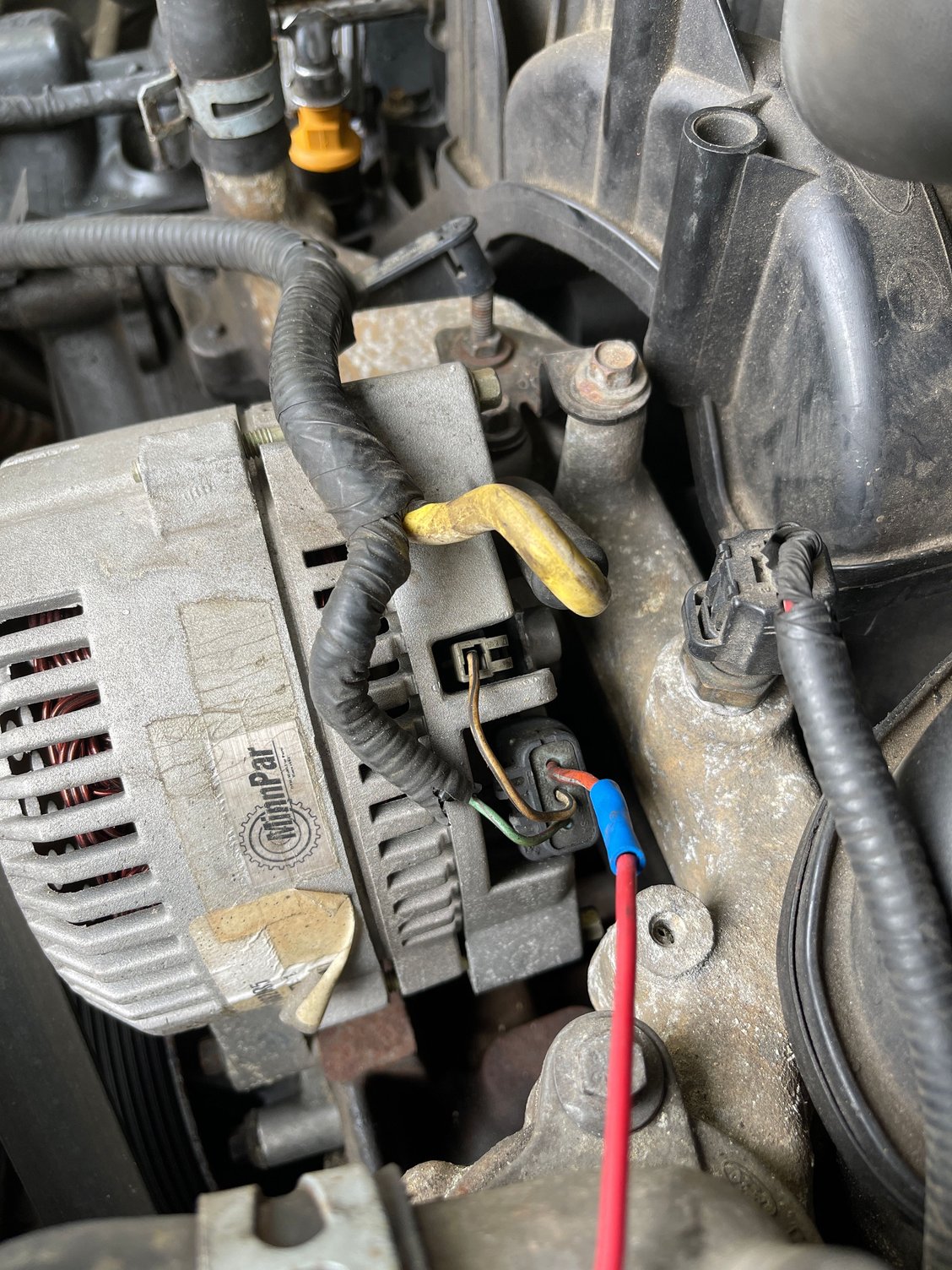

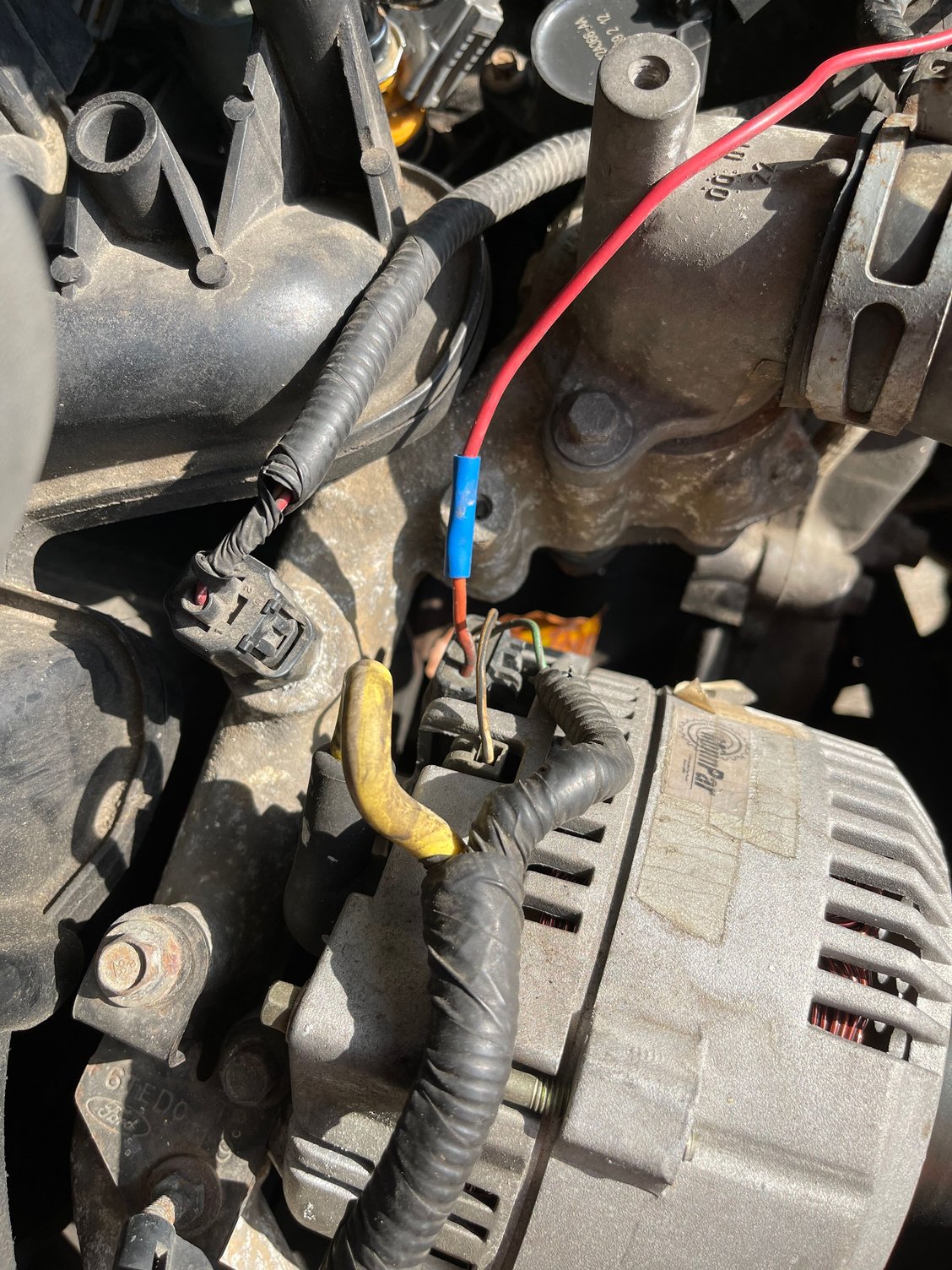

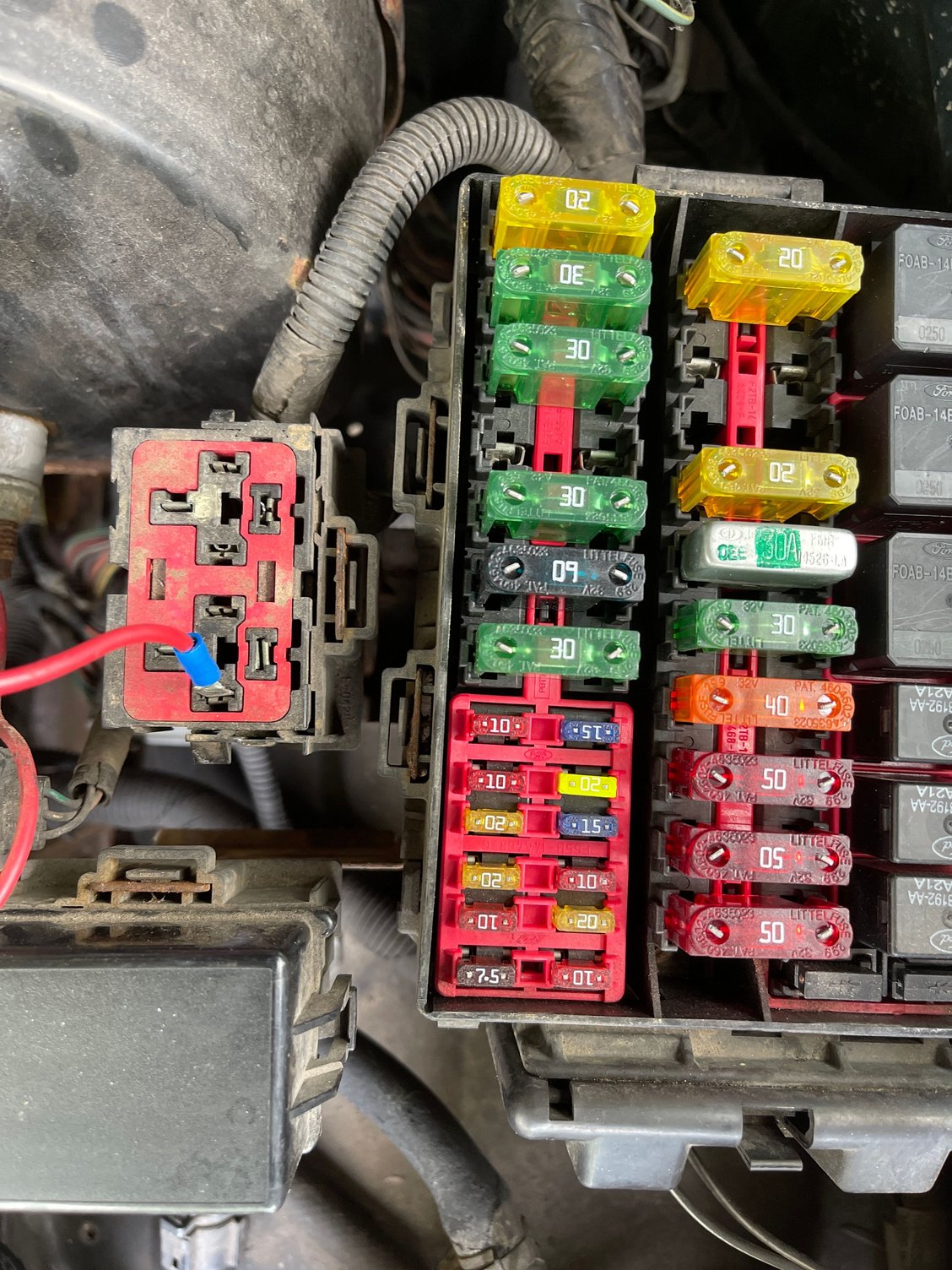

The yellow large wire goes straight to the starter relay, basically a positive 12v source…then there’s a faded orange that is connected to the pigtail next to it containing three wires…the green one follows the yellow underneath and the red and white is crimped and linked to an unused relay because fuse 6 is used…
When I got the truck the red wire was connected to the battery, I was told it should be fused so I used an open relay….
This is the relay it’s in…
so I took the crimp off the wire and braided it into fuse 6 and I’ll be damned the lights stopped flickering and there’s no battery light on…

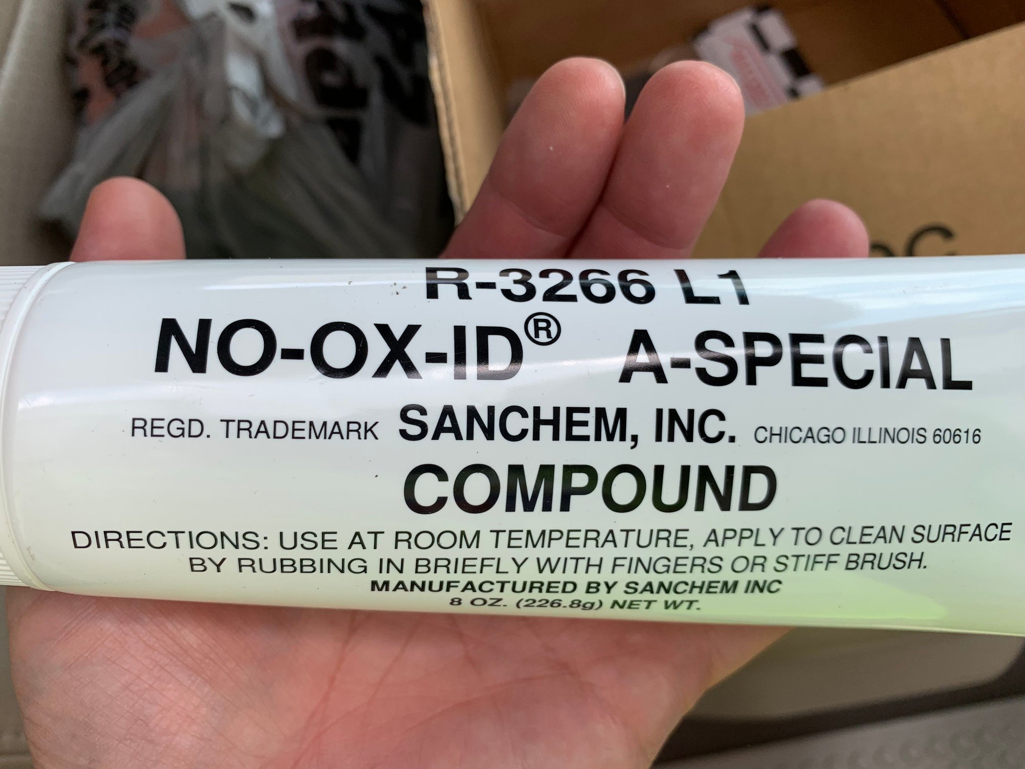

No-Ox Special A, if you can find it, is a awesome dielectric grease for any and all electrical connections (hence why every single power connection in a phone office or a power plant its REQUIRED to be used) . It's in the high megohm resistance range so it doesn't conduct for anything.
