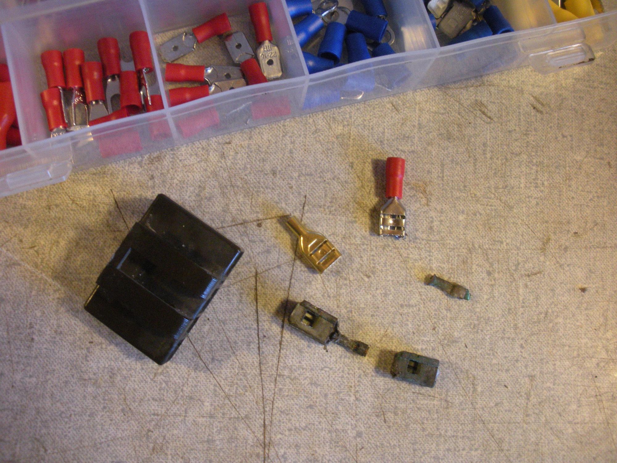

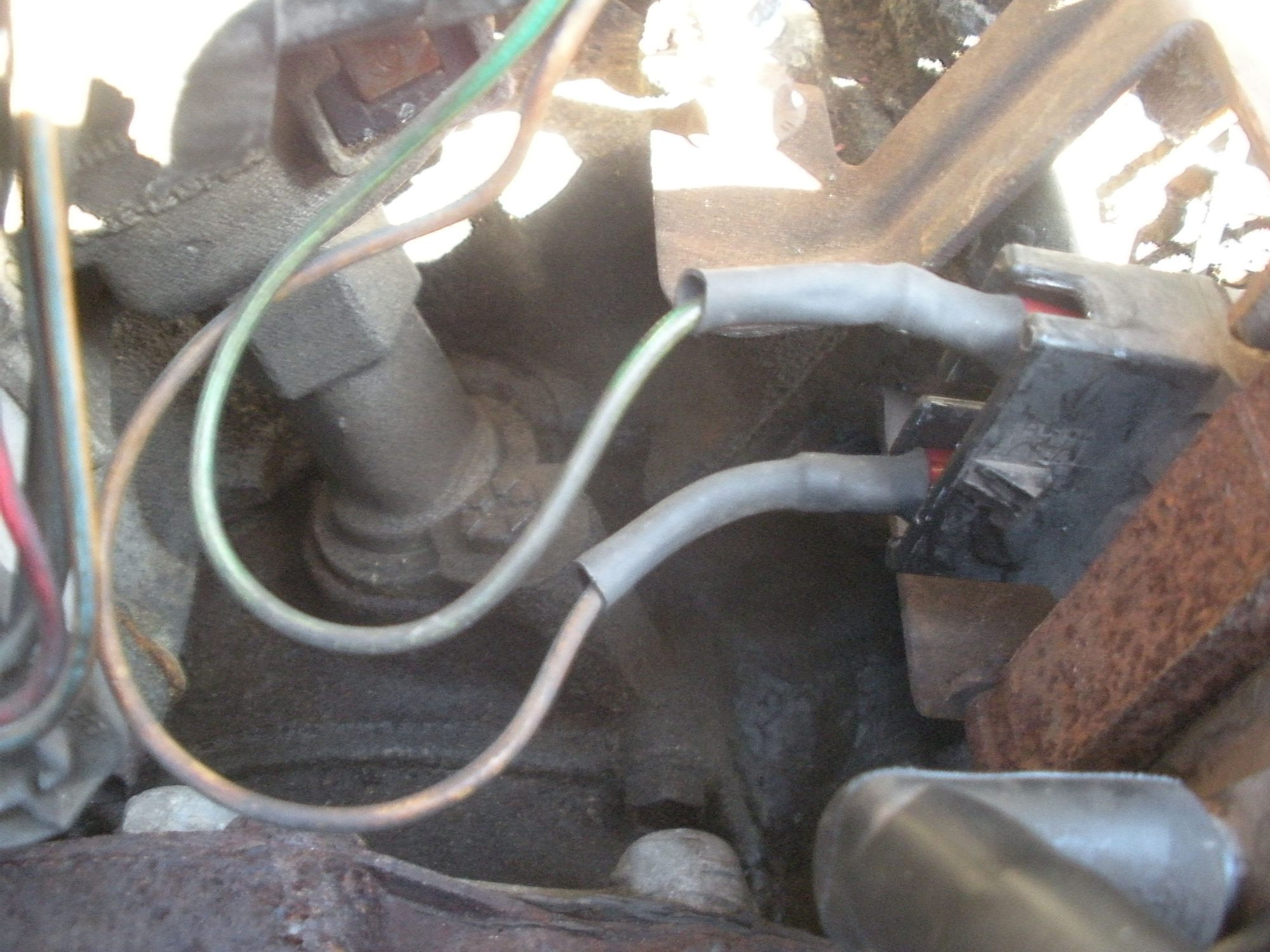

Here is the connector you pull apart to check timing with a timing light. Plug it back together when your done.
I also found corrosion in the coil connector, here's the OEM terminals if you want to do it right if you find issues in there.
