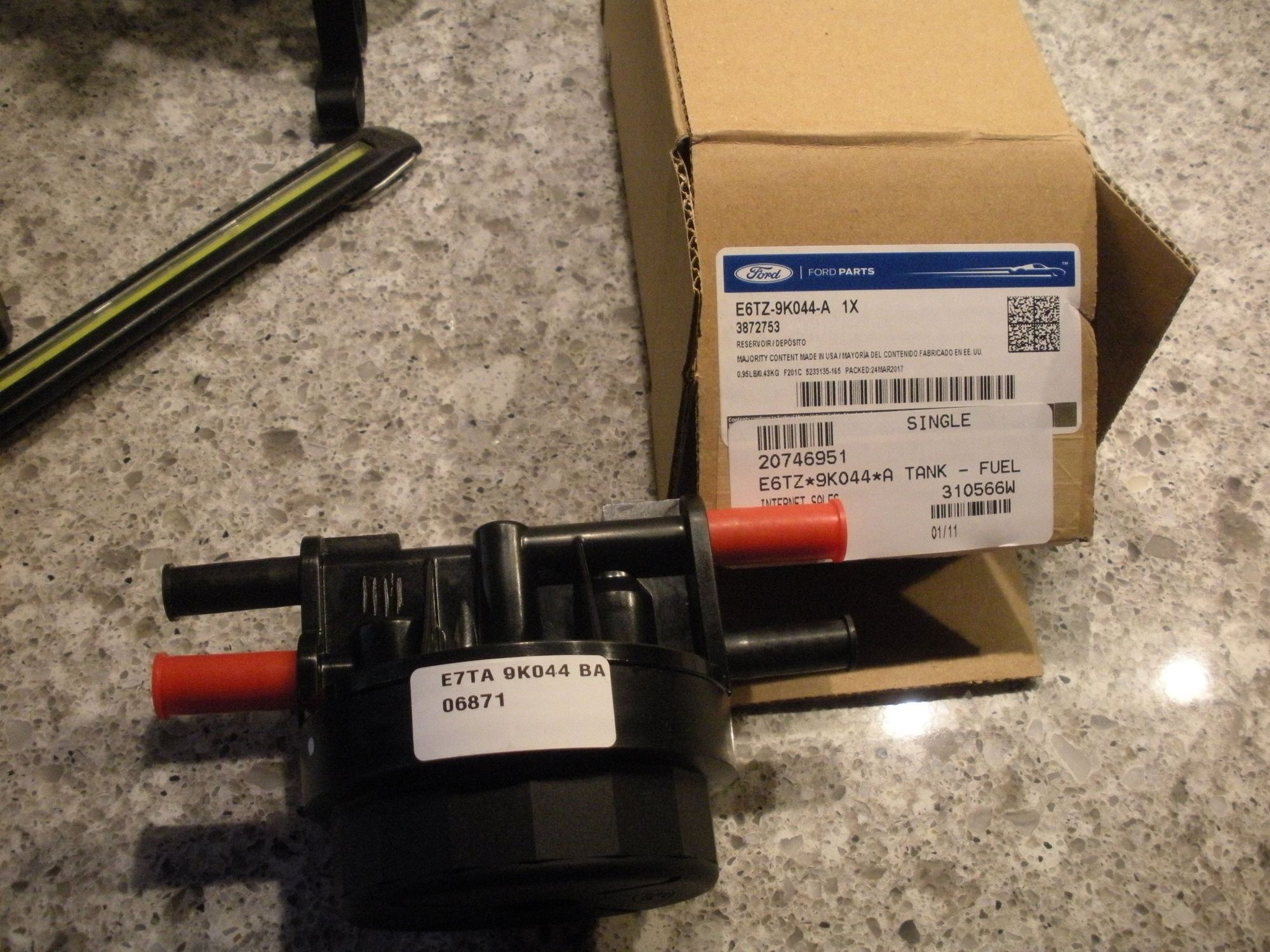

I can post some pictures of what your high pressure pump and reservoir (filter housing) look like. I have not replaced the high pressure pump on my truck. Pump is located under drivers feet on the frame rail.
