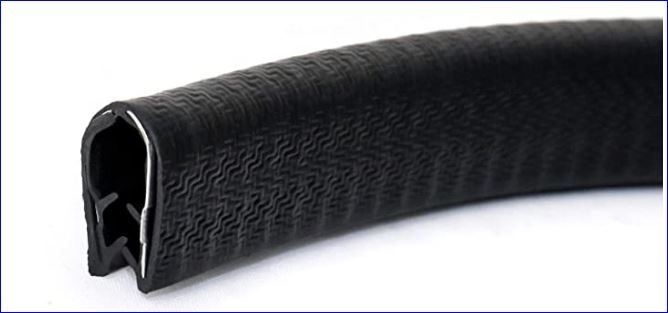

Originally Posted by Moe Craig
Yes I'm looking for #4... Have you tried the ones from LMC? Any problems? I talked to one guy that said the opening seemed wider to him as he had a hard time keeping the glass in, until he used a liquid glass sealant/glue on both the inside and outside of #5 - Channel Rubber.
I also had a problem with my 56 Glass Track being oversized so I used this 1/4" edge trim on the bottom of the Window and it worked perfect
https://smile.amazon.com/dp/B088H8YJ...roduct_details
Ok thanks for the info
