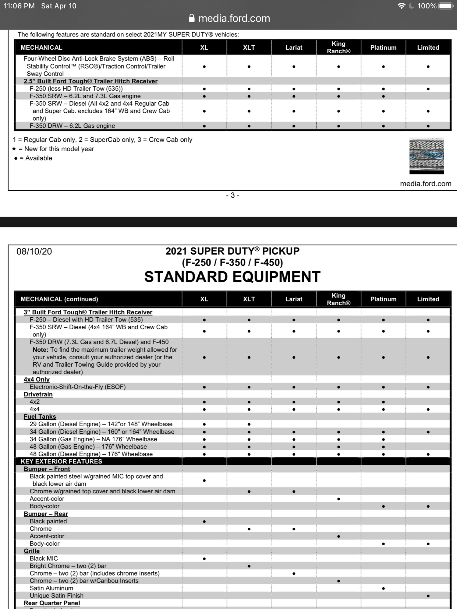

What the heck? You have a SRW F350 gasser?
Old Sep 29, 2021 | 11:06 AM
last5oh_302's Avatar
last5oh_302
Joined: Mar 2007
Posts: 1,063
Likes: 329
From: Ontario
F-250 gas: 2.5" hitch
F-250 diesel: 2.5" hitch
F-250 (diesel) with HD tow package: 3" hitch
F-350 single rear wheel gas: 2.5" hitch
F-350 dual rear wheel, gas or diesel, any config: 3" hitch
F-350 diesel, any configuration except crew cab long bed: 2.5" hitch
F-350 diesel crew cab long bed: 3" hitch
F-450: 3" hitch
F-450: 3" hitch
The highlighted statement is incorrect. My F-350 SRW CCSB has the 3" hitch.
F-450: 3" hitch
Along with what was mentioned above by elee3, F-350 Dually 6.2 gets the 2.5"

Originally Posted by titus_4
What was your previous truck? My 19 F350 6.7 CCSB has the 2.5" hitch. CCLB would have the 3". I think all F350 diesels have the 3" now.
Is your new one gas?
Pretty sure he has a Super Cab 6.7l. That's why it has the 2.5" receiver per the chart above. Did the previous years come with a 3" on the SC F-350 w/diesel, or has it always been 2.5"?
